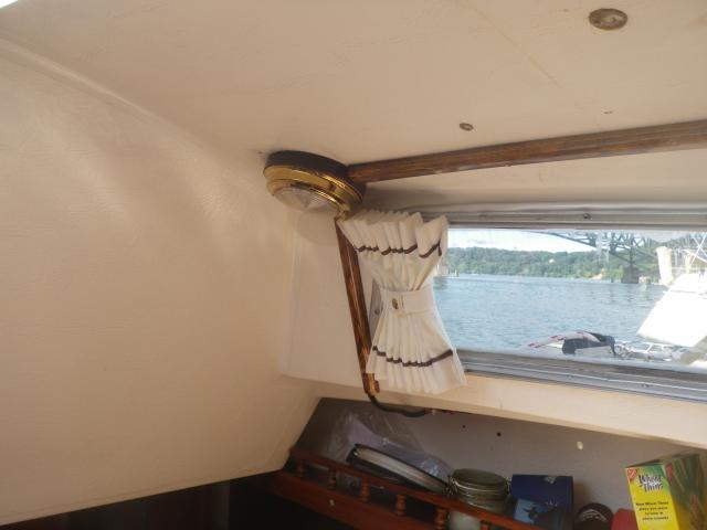

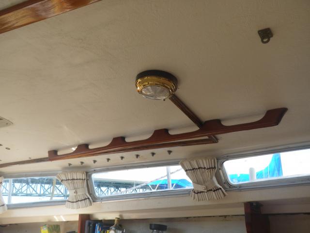

I have a 77 Catalina 30, which for the most part has been rewired.
The cabin lights including the 2 in the foreberth, the 1 in the head and the 2 in the main salon (both over the setee and the galley) are blue and black and run through the head liner aft. They come out of the structure just behind the galley bulkhead in the aft deep storage comparment.
All the wiring comes out here, including the mast lighting, cabin lights and running lights.
You'll see alot of mods where owners rerun their cabin lights via homemade external runners.

Check out Neil2099's info page. He has some great pictures and a sweet lighting setup...
http://forums.catalina.sailboatowners.com/album.php?albumid=1323
