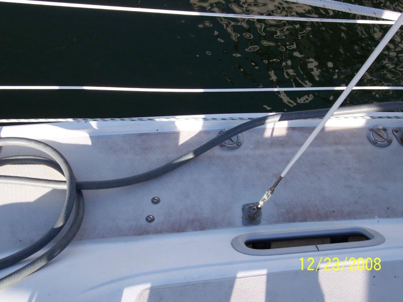

I recently purchased a '87 C30 and have been figuring out a lot of my own questions, but can't figure this one yet:
The two teak trim boards that go from the companionway hatch forward (on the deck) have drain ports near the companionway (which are clear), but nothing at the forward end.
There is usually standing water in the track, and the forward sections of each are notably moist. There is no similar drain in the forward sections (?).
Has anyone had the same problem and, if so, any suggestions? Drilling weep holes in the teak seems like the simple solution but I'm a bit hesitant to start blindly drilling in my 'new' boat!
Thanks for any input.

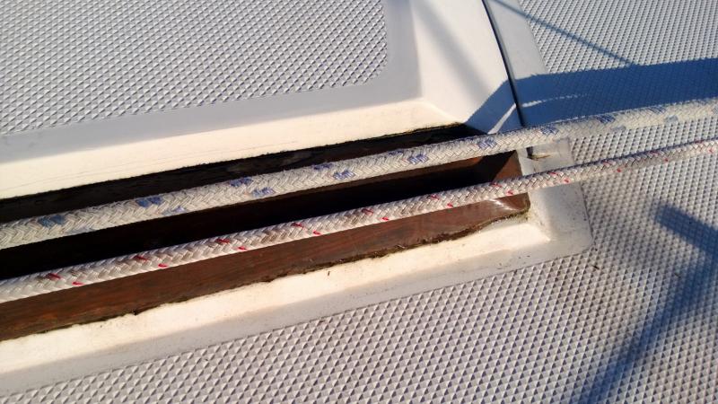

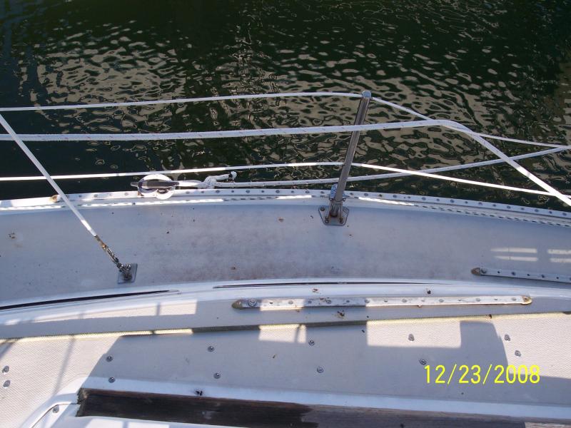

6/08: I've added two pictures: one at the companionway/hatch, showing the drain port under the teak that allows any water in the track to go out onto the deck. The other is the forward end of the hatch and teak boards, showing the water seeping out. This is where I'd think there should be a way for the water to drain out onto the deck vs soaking into the wood? I don't see any holes that are plugged up. Hopefully this makes helps w/my explanation of the problem. Thanks.

I have a 1980 C30. Your design may be abit different. What will kick-start this thread would be some pictures of what you have.
I have no drain holes on my boat, The water simply drains from the track under the board aft. There are no drain holes. And if having drain holes, where do they drain to?

i have no drain holes in my tracks and it took me some time to realize where cabin water was coming from - residual rain water in the tracks - when i didn't have my dodger and bimini rigged.

That's the way water drains, high to low. My track area will have some evidence of water when checking after a rain.
Looking at the pics again, these are not drain holes but, drain access openings. Unless you feel that water is seeping thru to your coring, this is normally not the case unless you lost your wood to deck seal.
Your wood is machined screwed into the decking, if the seal is bad yea, you could be getting water intrusion thru to your coring.
What is moist, the fiberglass or the wood? If the wood, what shape is your varnish in? I have to assume that your wood needs to be re-done & re-sealed. To do this, you first need to drill out your bungs (screw coverings) & remove your wood. Clean, prep, varnish & reseal it.
If not, another option would be what I did. Purchase a manmade material such as "Sensibuilt" (a teak look-alike PVC mat'l.) have it matched cut & install that. No varnishing to do afterwards. If you go this route, make sure you also order the bungs to cover your drill holes.

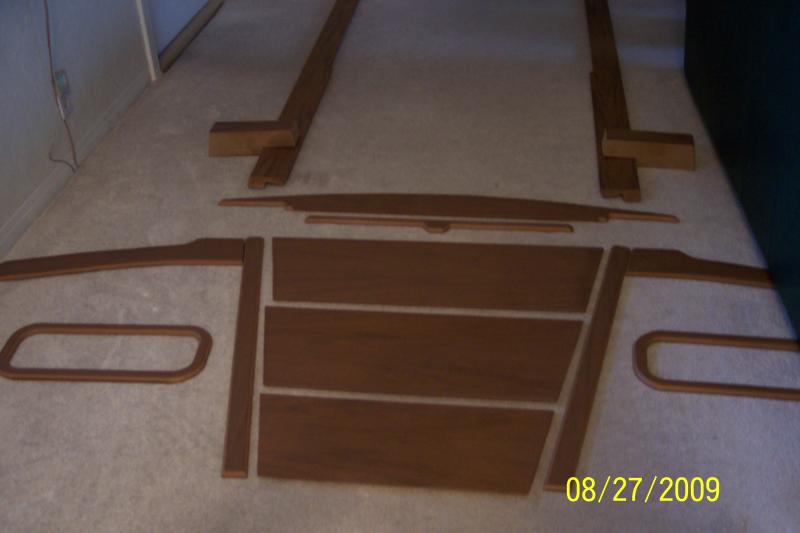

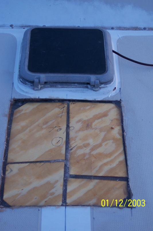

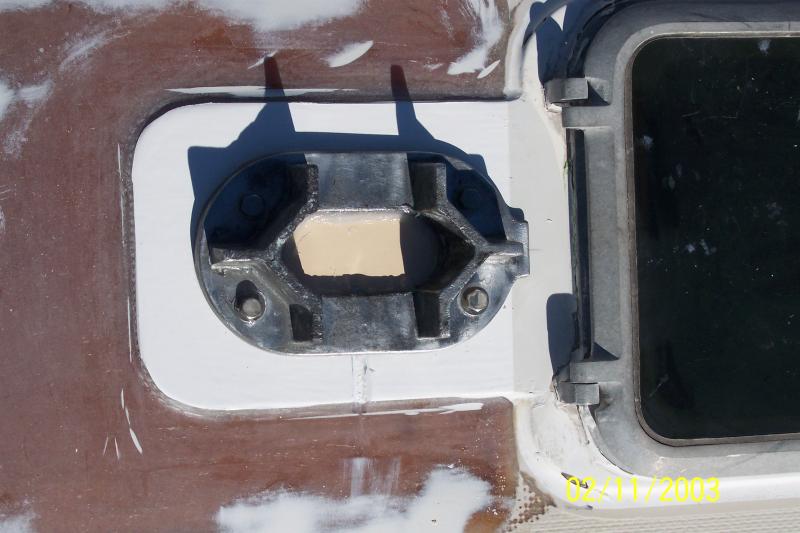

As a follow up explanation to your questions & my last post, here are a few pics on what I did for core rot & subsequent teak replacement. This should give you a better visual on rot problems & fixits. I didn't know how bad my rot was until I dug into it.
In addition to my glass fix, I have a great workshop in my garage so, I was able to remake all of my decktop wood with a PVC replacement. I don't know how far you wish to take this, but I offer this as an option to your wood. I have always felt that, "Life is too short to have to constantly re-do your teak". Besides, good or bad varnish will not make your boat go faster.
It sounds to me like the further you look on-deck, maybe the more you will see what needs to be done/re-done, thus giving you ideas.
My first 2 pics are of the core rot I had to redo @ my mast base. The second 2 pics are the matched teak replacement pieces I made & changed out.
I always feel that knowledge to others is empowering.

If I were you, I would first talk to a glass man for options on how to proceed. I know what I did, but a good glassman might know of a better approach. For my mast base, I cut out the sagged area saving the deck-top fiberglass piece. I cut out a larger area until I got to dry wood. I did this by drilling small holes into the core until I got to dry wood in my drill bits. I had a good glassman do the mix. The job wasn't that bad, but you will need to drop the mast.
Here are some pics on what yours might look like. For the mast section fix, make sure the glassman makes a mud-mix using Milled Fibers for added strength.
The first pic shows the cubed balsa that comes with a backing sheet that keeps them together & will follow the curve of your cabin top. A glassman will apply the mud first then set the cubes than apply more mix liberally & allow it to soak in for strength. The next pic shows marine plywood sheets cut-to-fit & glassed in on top of the balsa cubes. Another spread of mud covers this & the deck top can be replaced & glassed in at the same time.
