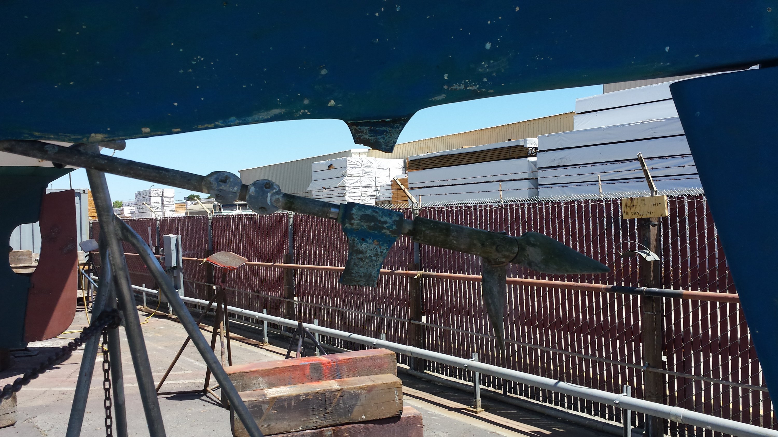

Last time we sailed it was uneventful. Very light wind and motored back to the slip in calm water and no issues. Parked the boat went home. Next time at the boat I scrubbed the bottom we got ready to go put the boat in reverse and clunk clunk clunk. Dove in the water to look and there it was half the strut on the boat and half the strut hanging down fro the shaft. Hauling the boat at a local yard May 4th. Waiting to hear hopefully good news that simply replacing the strut will be all that is necessary. I see on Catalina Direct they have the strut for $650 and the bearing for $68.

Hauling the boat tomorrow for bottom job and replacing the prop strut. I was able to get it from Catalina Direct. Hoping the labor isn't an absolutely ridiculous cost. Looking into the drawings of how it was originally installed looks like an involved job besides the access issues. Attached the drawings.

Saw the boat today. Bottom looks good. The new strut is so much beefier the yard mechanic thought it must be the wrong part. The original does seem a little small. Photo attached.

p shaft support struts can be overstressed if there is excessive p - shaft vibration --such as from engine mounts being totally bottomed out.
Dec 6, 2016
20
Catalina C38 Pt Richmond
Engine mounts are good and the engine runs very smooth. Never feel vibration. Yard mechanic says it looked like corrosion. Maybe in the past the boat lived in a marina that had a lot electricity in the water. Shaft zincs were good also. Luckily the shaft is in good condition. I have only owned the boat since Nov 2016.

Well the boat has finally started to get worked on in the yard. Quote came in at over 5K. Wow! I got a second quote just to make sure and it was $300 more. I just hope everything will be solid after this for awhile. The boat budget or any budget needs time to rebuild after this. I suppose it would be a good time to check on the transmission fluid since they have the water heater out of the way and it will much easier to get around in there. I also want to change to a fixed three blade. Cruising these days instead of racing. Catalina Direct says 15inX12PX1in. Haven't seen that prop out there in used market yet. Any ideas?

Finally the boat is repaired. They actually had to fabricate a replica of the original with the Y shape connecting to the hull. The replacement Catalina Direct had needed them to cut a hole in the bottom and we didn't like that. $9000 later and two months in the yard. Ouch!
