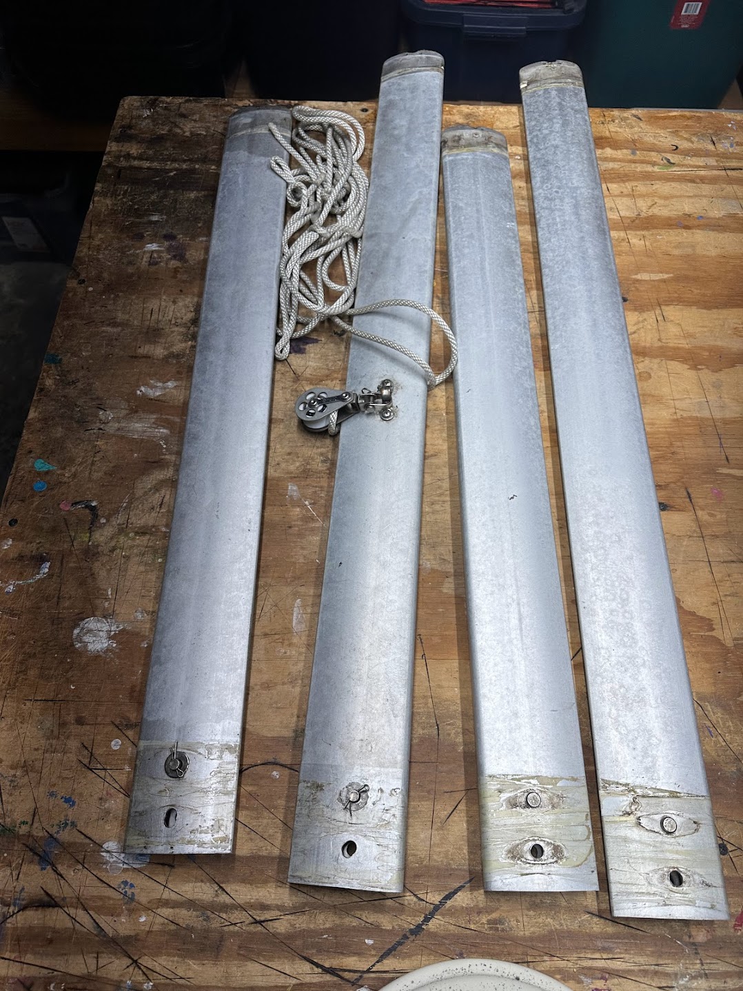

I have my mast down this winter for general maintenance and have the spreaders at home to clean up. I'm curious what folks use for that? The tape goo seems to be coming off slowly with goo-gone.

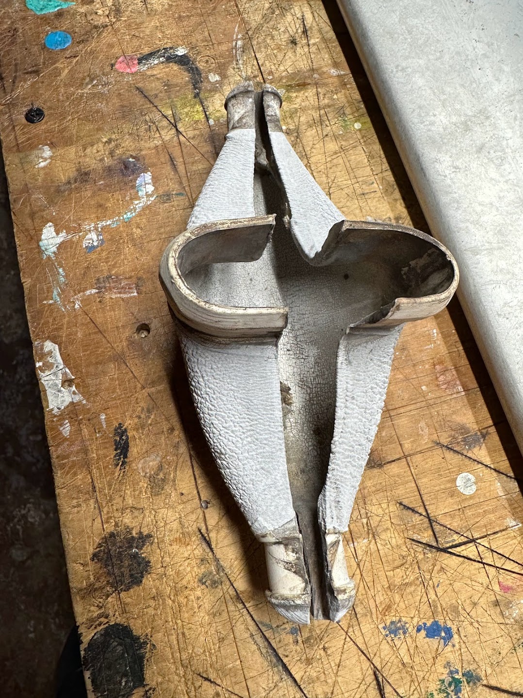

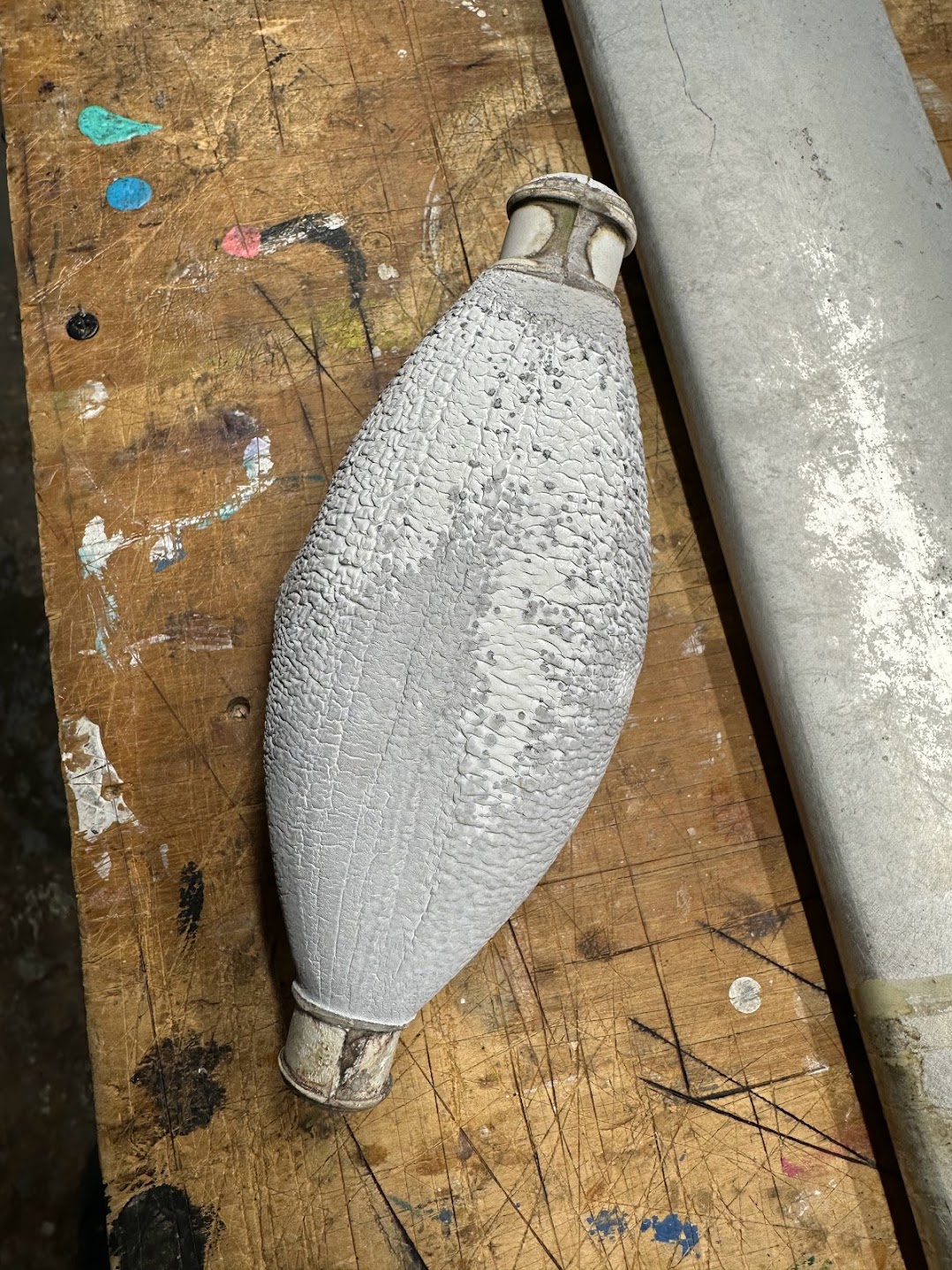

I'm also looking to replace the boots that go over the spreader tips. The original ones look like they never were the right size. See pics attached. I was thinking maybe the leather velcro ones would fit better like these? https://www.amazon.com/dp/B07WXS9C49?ref_=cm_sw_r_cp_ud_dp_YN33WRH1TZGR9MRJW8QV
I know CD sells the leather kits you lace up, but since the boat yard will be stepping the mast without my presence, I wanted to keep things simple.

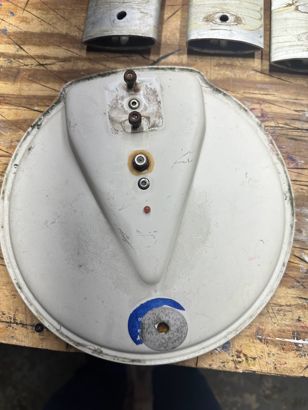

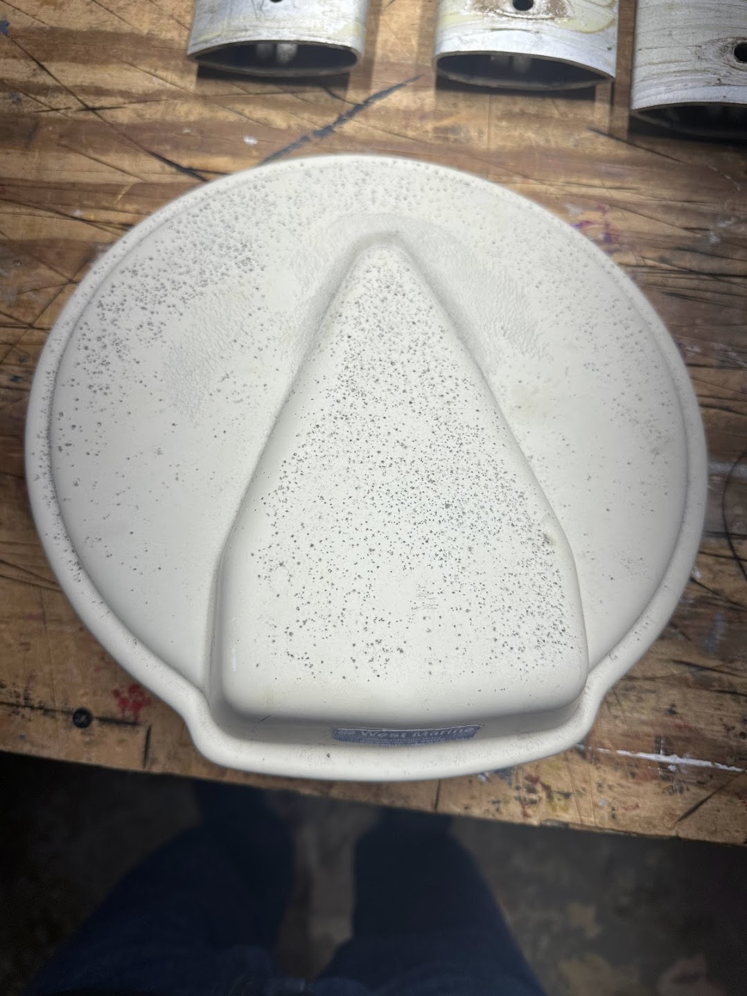

The powered TV antenna works fine, but is showing signs of UV damage. Not sure there are replacements for this model of antenna (see pic)?

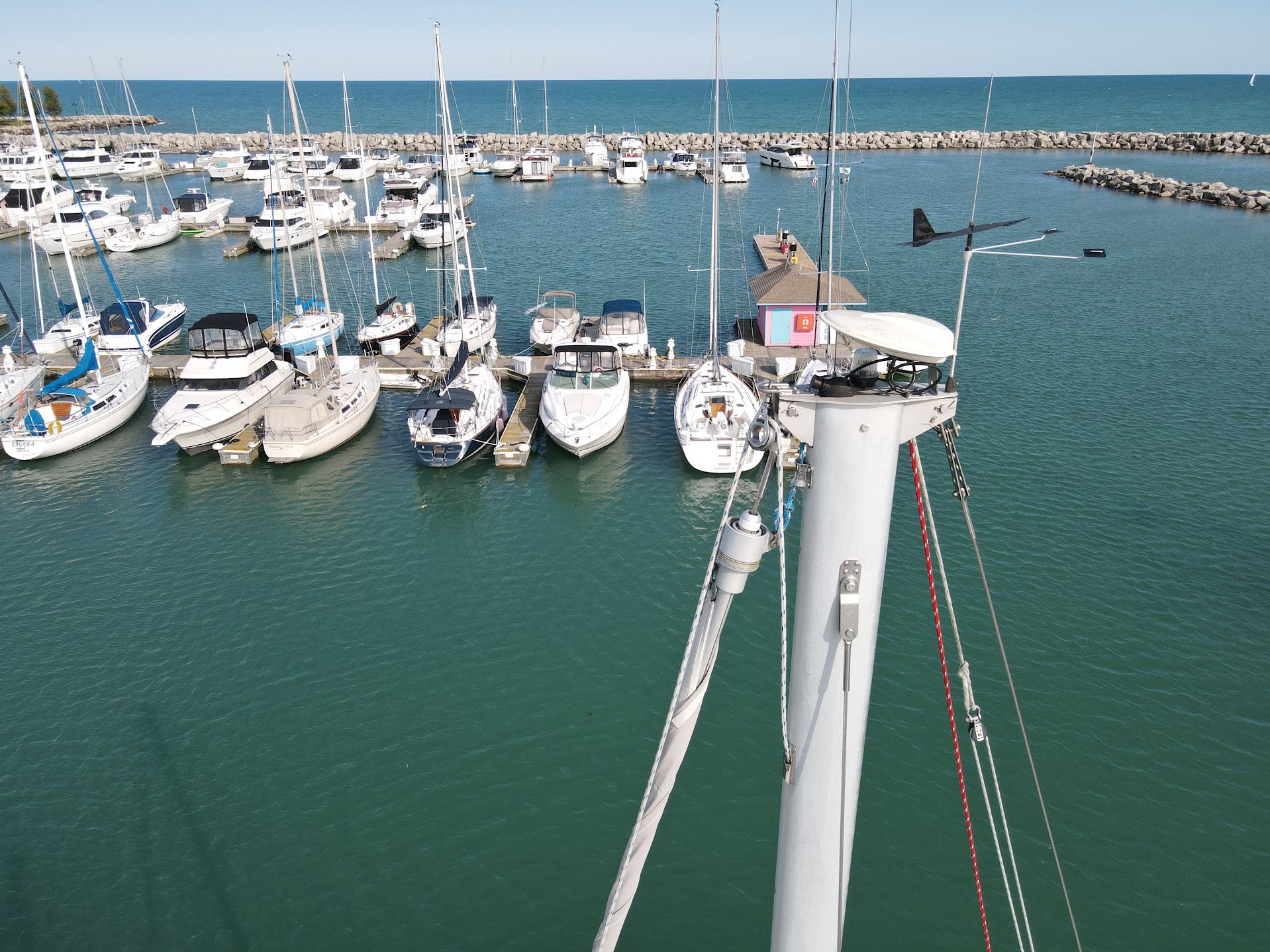

Was that TV antenna mounted up high on the mast? I have one just like it, but I keep it stored on the cabin with a long length of cable… when I am off grid (no cable TV), I just lay it on the deck.
I wonder how much better my reception would be if I raised it up on the mast?

Yes mine is mounted on the masthead...

Wonder where could get antenna like that?Haven' had much luck with others.

Goo-gone, soap/car wash and water are all I would use. Any abrasive to clean the spreaders will remove some of the anodizing and oxidation that protects the aluminum underneath.
You can use whatever spreader boots make you happy. Lots of people like the traditional leather look, some like the simplicity of the plastic boots.
Do make sure your spreaders are reattached to the shrouds securely and at the correct angle, tilted slightly upward to bisect the angle of the shroud.

Go to an auto parts store paint department and buy some 3M adhesive remover.

I've been using good old acetone on the spreaders. Works well. Every so often I use a buffing paste to bright up the aluminum.

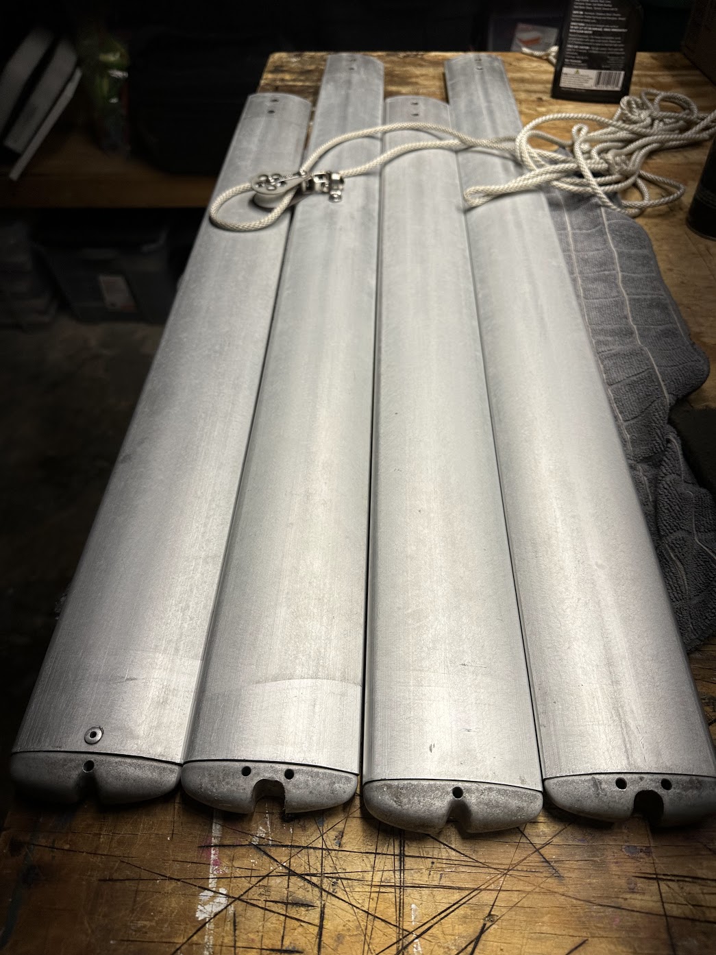

nothing else seemed to work except for this to get the really dried old adhesive off. I used a fine scuff pad with it.
