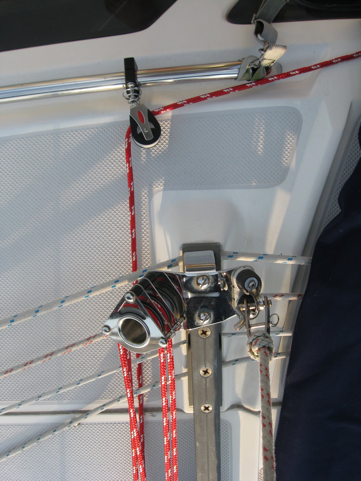

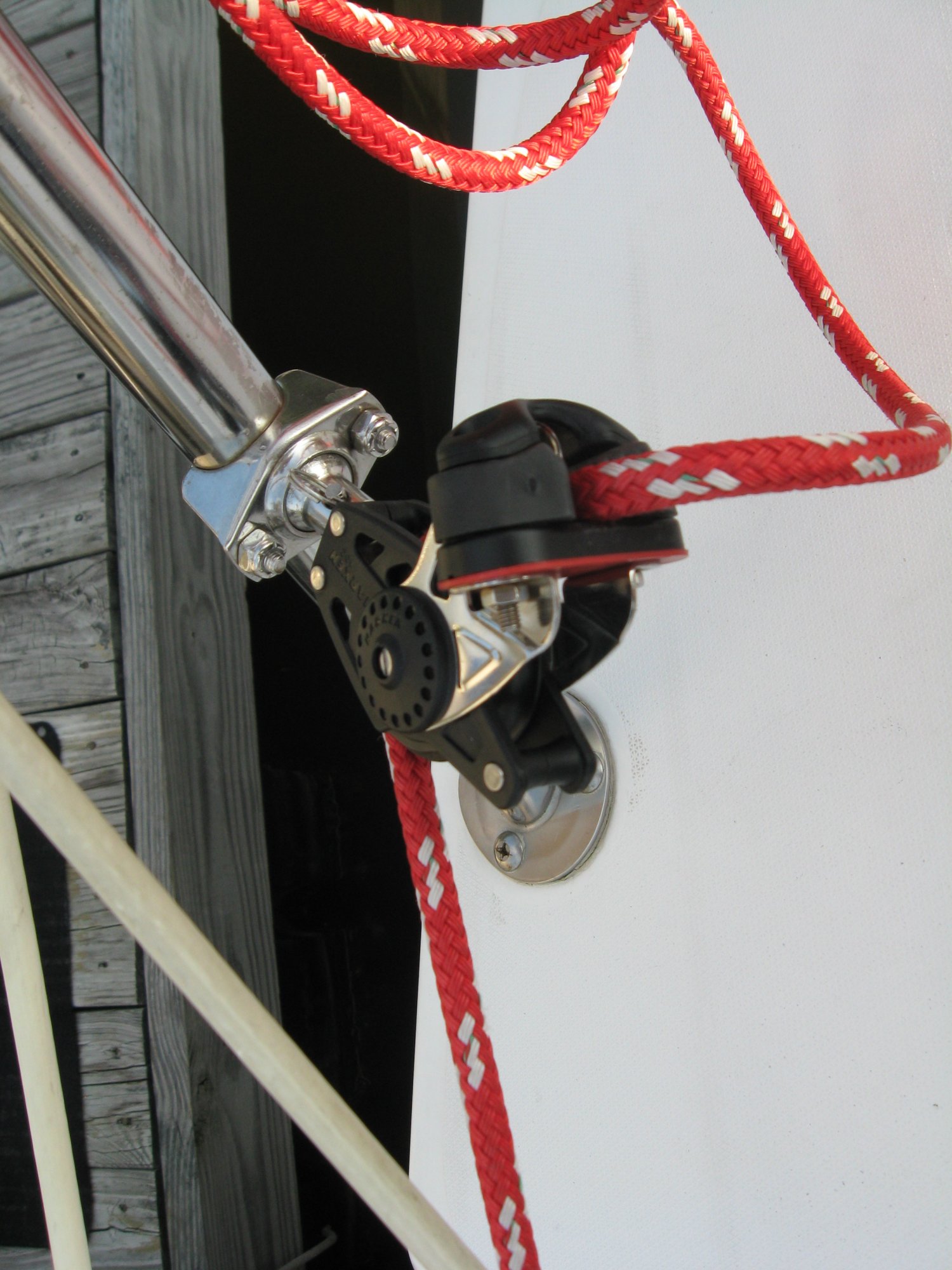

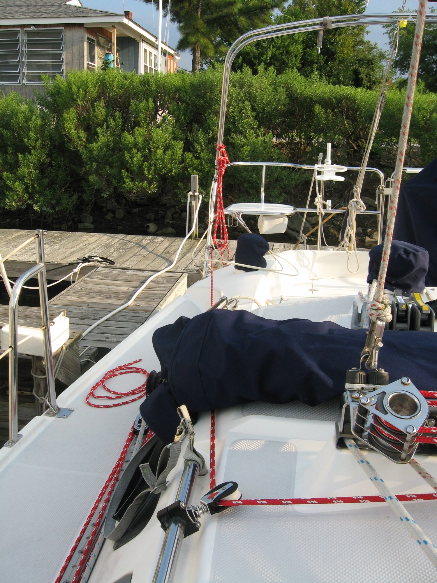

Consider leading traveler controls aft of the wheel. The traveler has 4:1 purchase so you can handle it without a winch, and provides quicker response if you need to dump the main when single handing in a gust than the main sheet. This is how I did it on the 310, you could likely do something similar on your boat.
Grip
Dec 2, 2020
18
Catalina Catalina 30 Portland, Maine
That’s pretty slick with decent clearance outside of the seat backs! I assume you have the same running down the other side?

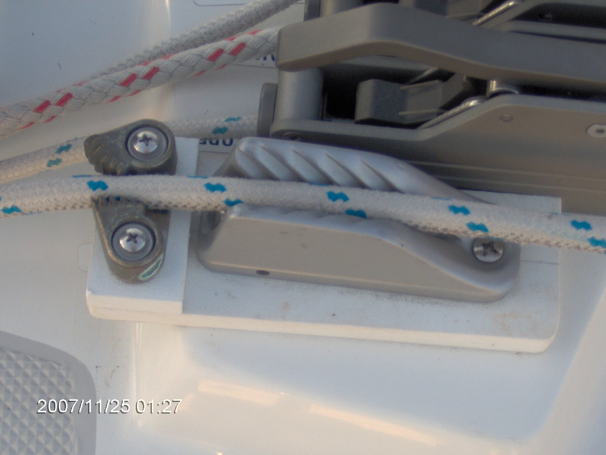

Another option for single handling, although I do like Valcours set up as that is pretty slick. If we are racing the mainsheet goes on the starboard winch and the traveler lines are both led to the port side (thanks to Guido at Garhauer for that slick update).
The jam cleat was original and provides strength, the cam cleat provides ease of use in light winds where a manly snap of the wrist will free it and I drape it over the throttle handle at the helm for easy reach.
