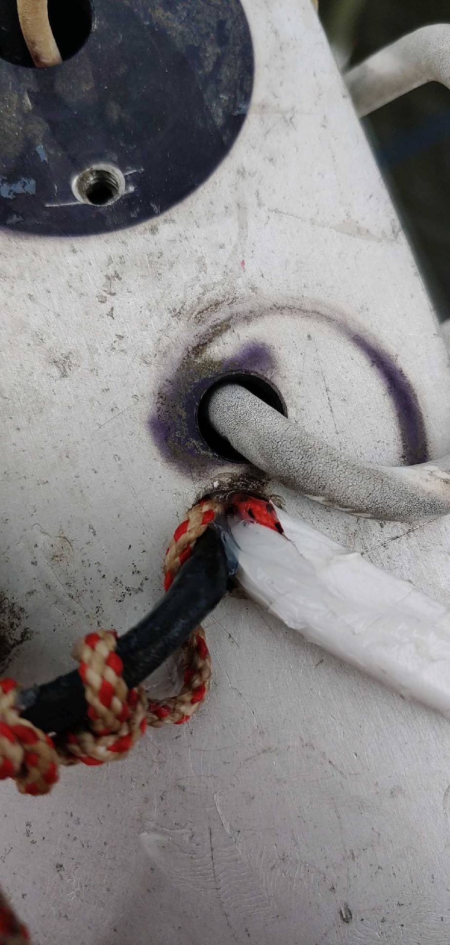

I pulled down a new wire and replaced mine with a Hella Marine white NaviLED 360 2LT 980 960-0-xxx. Meets COL REG 72/USCG 33CFR 183.810 2NM/ABYC A-16. The bulb is built in (non-replaceable), but has a 5 year warrantee and clamed 12,000 hour service life before recommended replacement. I recon that is at least another 15 years, which is longer than the OEM incandescent lasted.
Photo shows failed attempt to pull wire down existing hole where wind sensor wire enters mast and I had installed a pull rope after I bought boat in 2006 and had to pull mast to untangle internal haylards
