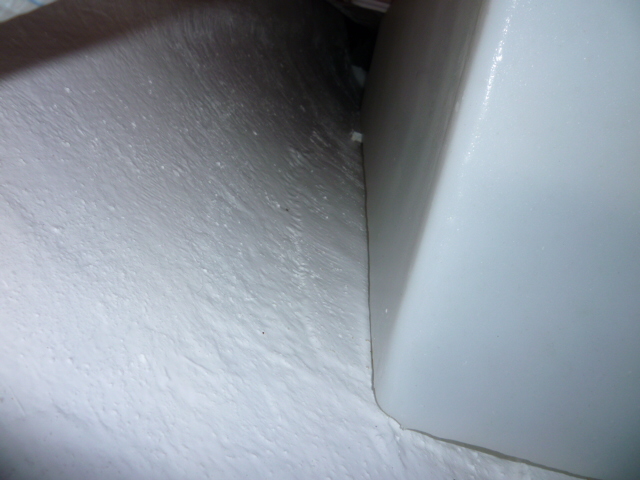

Just confirmed my Catalina mold problem. Jumped on board my previous 1989 Capri22, with owner's permission, and tested the paint and mold theory. Sure enough, a problem I fought for over a decade is the paint. And because it is extremely well known that oil based paint yellows in a non-lite environment, I'm willing to state that Catalina paints their boats with an oil based paint. This surprises me because everyone in the industry should know that oil is a food source for mold. I learned this after the never ending perpetual cycle of teak oil, teak cleaner and teak brightener. What a racket. Took me about five years to figure out to let it go natural and the occasional cleaning with lemon Fantastic.
It's really disappointing that one of the big boat builders doesn't understand the problem of mold. Here are before and after pictures. The light gray mold was tenacious and was permanent all through the time I owned the boat. Notice the yellowing of the paint on the left side after the removal. That's oil.
In this case I used an old bottle of Citri-Strip, which I can not recall ever using before, and left it on the boat for the owner. Catalina is doing a disservice to their owners when they try to beautify their underside. Absolutely confirms I need to undo Catalina's work. I'd rather have seen the occasional glass than the rampant mold.

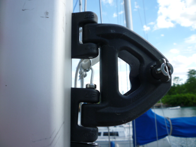

Keep an eye on the pivot screws on the mast luff track. I believe when the sail rotates from the port side to the starboard side, the screws loosen:
I've tightened them to have them reloosen. This year I've reinstalled using blue locktite. Forgot to get above as I leave that part on the mast. I'll see how this works out, but hopefully the locktite holds.

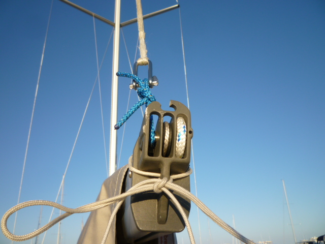

As I commented in post #10, I'm not fond of Catalina's (more likely Selden's) use of the core to secure to the shackle for the three halyards (jibs & main). You should keep an eye and on them and when motivated, pull the core out, cut the excess and tie the same type of knot as on the spin halyard. Here is my main halyard that is showing wear:
From pictures, there should be enough room before the knot will hit the sheave. Worked ok on the jib. The tricky part is the core does not melt so finished appearance is a little tough. I may try crazy glue on the core. Additionally, the cover does melt a bit but tends to recede without the core receding.

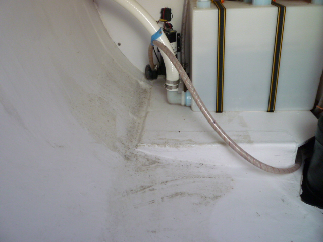

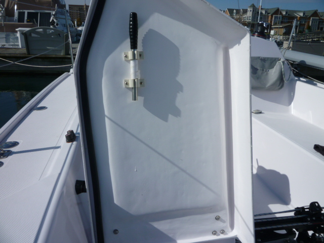

One season later, with no additional cleaning, the mold is holding off where I had removed the Catalina applied paint. This is the cockpit locker hatch that was growing mold within a month or two of new ownership:

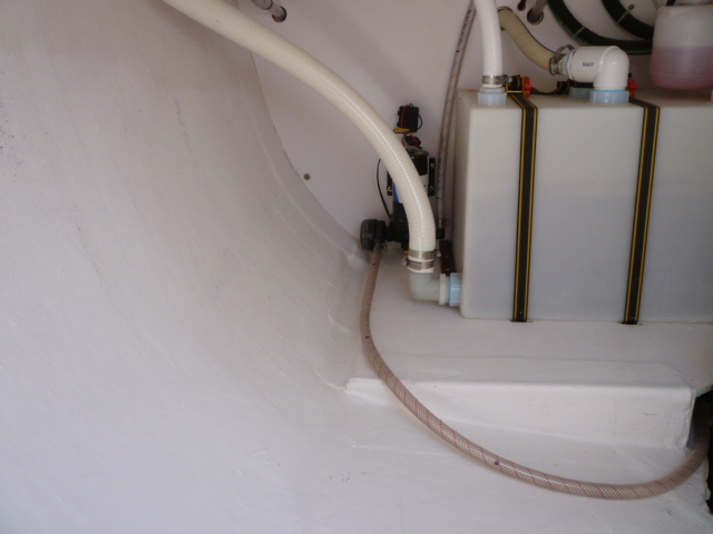

And this is under the saloon seat behind the holding tank where the mold was previously rampant:
Because of limited access and as a precaution, I painted the hull with white paint and the water tank with a clear paint. I'm happy that my experimental paint job is doing a far superior job than Catalina's paint job keeping mold at bay. I still have a bunch of crawling around to remove their mold growing paint. A good winter project.

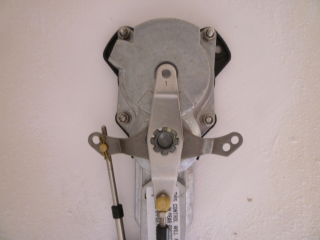

After the whole tranny pin problem, I think I become a little more sensitive and started to question that the forward throttle was a bit stiff. Probably been that way the entire time, but now I started to question it. You will know if you have the problem if throttling in gear is stiffer than throttling with the gear disengagement button pushed.
If you have that problem, it is because the shifter throw on the SD20 is shorter than the shifter throw on the Edson 910 Morse Control shifter. Solved my problem by moving the shifter cable to the inner hole of the arm:
This will reduce the throw by about 3/8". In my case the arm could not move far enough down on the left side (maxed the SD20 arm) and this lack of travel caused resistance on the subsequent throttle movement. It is pretty easy to emulate it without the shift cable connected by preventing the arm from moving all of the way.
It feels normal now, but I did have to remove the locking nut to compensate for the lower neutral hole position. I'm going to thread the rod a bit more with a 10-32 die because there is very little adjustability at either end. I also need to take a dremel with a cutoff wheel to shorten the protruding bolt about another 1/16" because the cable comes in contact now.
Anyway, if you notice stiffness with the throttle in gear as opposed to out of gear, this is what I would look at first.

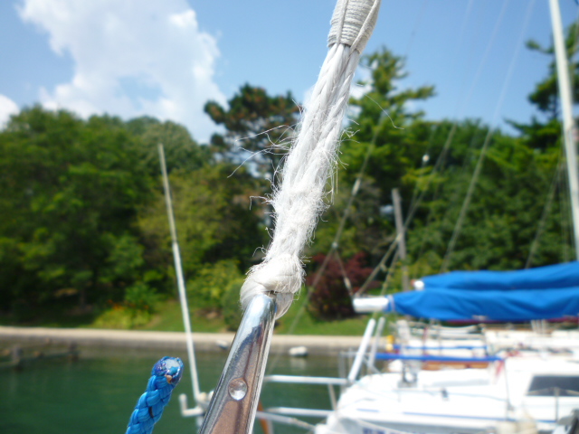

Has anyone replaced their rigging lines? I was tightening my Jib halyard this weekend and the shackle parted from the line. The exposed braided end just parted. Of course that line went right into the mast and will need to be rethreaded through the mast when replaced...
the other Jib and the Spin halyard were in the same state so I cut the end off and tied a knot to the shackle. But now I can't tighten the Jib because the knot is hitting the mast... I guess a trip aloft is due even though I just had the mast stepped... so all that will wait till I get a new line so we just need to go up once.
The lines I'm most concerned with are the back stay. Do you have any info on that? Would hate to be trying the flatten the main and have all of that pop... So its going to be replaced ASAP
And this is just a 2/12 year old boat. But that's what the Florida sun will do to un protected braids

Been there done that (posts #10 & #28). Another option to a new line and/or if your jib is too long is to have the head cut down a few inches. I took off 4" on mine and I can use a knot on the jib shackle. But the whole use of the core is a problem waiting to happen. I even had to go up the mast this past summer because I didn't follow my own advice in post #28.

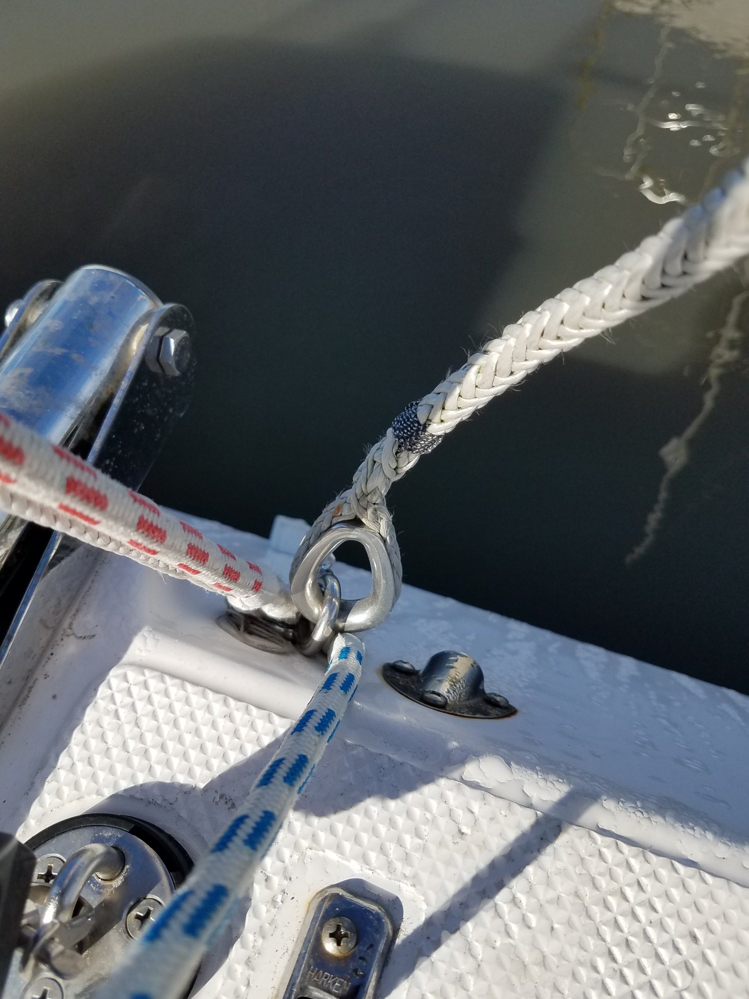

while I sort out the Back stay lines I reused the dynema line from my capri to add a newer Back up to the 275. Do you see any issues with adding that Shackle to the Bracket holding the existing back stay. I'm concerned that when it is pulled taught that it might actually be in the way of it laying flat. Thoughts?

Sorry, I'm not wild about the setup. When the red and blue lines are given tension, I would be concerned the edge of the thimble might cut into the unprotected core. It's possible that you may not have to replace both (the red and blue lines) as maybe you could get away with shortening one with knots and using a longer replacement for the other to compensate. Additionally, you may want to check out your jib halyards and if they are as long as mine, steal the ends from those to make new line(s).
Not sure if the backstay is a critical component on this boat. Simply, I do not know enough about the rigging limits and if this boat could sail safely downwind in a blow without a backstay. Upwind shouldn't be a problem because of the tension of the mainsheet.

I decided to take the thimble out of the equation, was able to negotiate it out of the spice. So now there are two back ups the blue one and the one that I pulled from my Capri.. happened to be the same length. With the thimble out I was able to attach it to the back stay deck connector same way as the blue line. And I tied a knot in the Red line up by the Block so I'm not dependent on that core splice. The Fla sun really took its toll on this boat in less than 3 years as these slices were frayed.
We tried to spice a covered loop in the Jib sheet and found out that due to the UV exposure there isn't enough flexibility to be able to pull that off. So I'm just gonna get new ones from Sheldon.
You raised a good question, that is what does that back stay really do, is it necssary. Given the Spreaders are actually less angled back than the Carpi and a lot less than a Hunter which is made to not have a back stay I'd have to say it is critical going down wind. As such the reason I put my second dynemia line on it.
All of this raises another big question for me... that is the Chain plate attachments. The back stay is just a through bolted attachment point... So my plan is to put on a second through bolted bracket for the second back up line for the back stay
