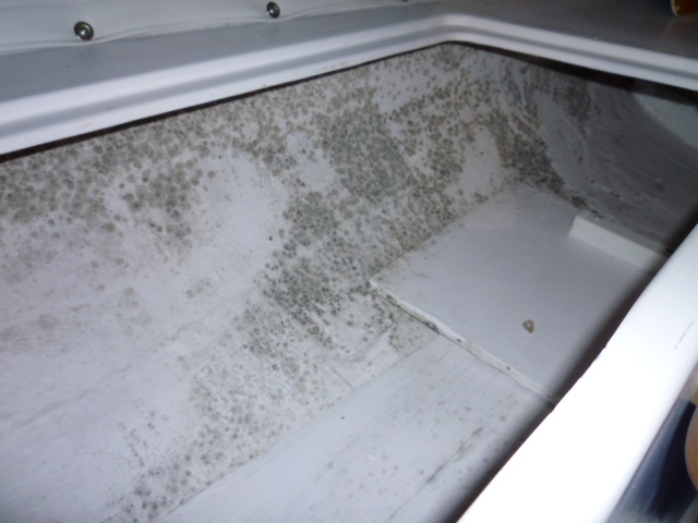

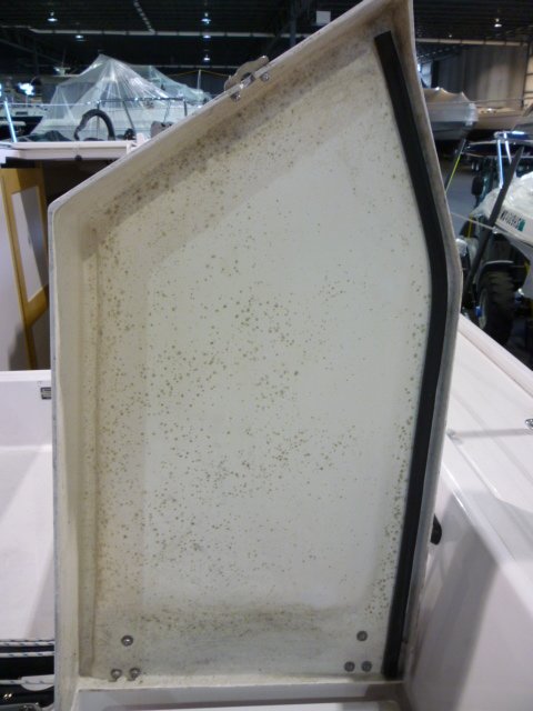

Mold is another problem. This one is Catalina's fault because of the paint they use. I don't know what paint they use, but it is very susceptible to mold. If they used oil, that would be the cause of the mold. Originally, I was not aware they even painted the inside of the boat. I always thought it would be gelcoat. Bottom of the cabin locker hatches is the first place I noticed mold growing in the first year. I'm not a big fan of bleach and consider it the nuclear option so I tried vinegar. Did nothing and the dried residual did nothing to stop the growth. This winter, I tried to see if steam would remove the mold. To my surprise, I melted the paint. And both acetone and CitriStrip removed the paint and the mold as well. As CitriStrip is certainly a lot less toxic than acetone, I proceeded with that product, which was certainly less dangerous when working below. Here is a picture of the starboard hatch cover before:

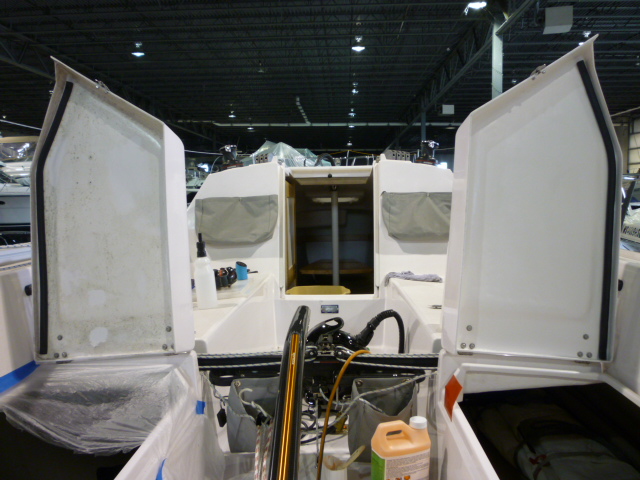

This is caparison after stripping the starboard side:

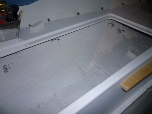

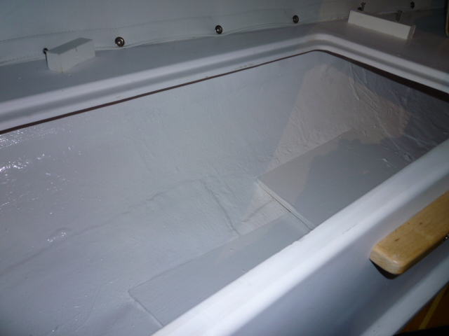

You can see the 4-5 test patches on the port cover. The worst place for mold I found is the water tank compartment. Because this is sealed up I wanted to add a water level gauge. To my surprise, mold, mold and more mold. These are the before and after pictures with the CitriStrip (the "before" has some paint removal tests towards the left):
Notice on the far right of the "before" picture, you can see the gelcoat does not promote mold like the painted surface did.
I didn't paint the hatch covers and I'll keep an eye on them. It is always possible I'll need to strip a second time. But for the less accessible water tank compartment, I repainted with a well regarded latex acrylic with a biocide added to it. Time will tell if this was the correct choice. Here is the end result:
So I know what I'll be doing this summer. I'll be crawling around the bowels of my C275 with the CitriStrip in tow.

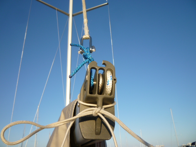

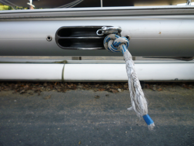

I suspect that everyone has been using the main halyard as a topping lift when not sailing. Unfortunately, the aluminum boom endcap is not strong enough to take the load in all conditions, ie. rocking. Instead of securing directly to the end of the boom, attach to a small line as shown. The stainless pin is much stronger than the aluminum.

Thanks Codybear! I just had a second reef put in my Main (have had a couple of Beer Can Races with winds over 25 and gusting to 35). Was about to attach a sheave to that point on the boom end.

If there is a sheave there and/or 2nd reef, I think wrapping the blue line around the sheave box would work as well. Anything to remove the load from the part that broke in the picture.
