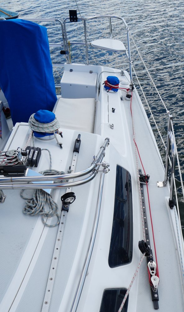

Thank you ... we do have the additional tracks and two aft winches, but you're probably right about the 150 vs 155 argument. I do want a genoa that will reef on the furler and look fair... maybe the foam.
One guy suggested a Dacron edge instead of Sunbrella to keep the weight down and improve shape.
I might even set up some quick change (shackles) sheets to use the upper deck tracks when roller reefing from genoa to jib (in size). I have them from my last boat

If the intent is to reef it, you probably want to give serious consideration to the EZGlide cars. You'll never get a decent sail shape without moving the blocks.

oh we move the blocks all right, but we move them the hard way. We have tried them at every position except the upper deck
Thanks for the picture

We fly the 135 from the top track. The 155 does not fly well at all from up there, the block, even at the very back is too far forward to control the sail. There are times, wind angles and speeds that we have the block almost all the way back, on the top track, for the 135.
The little bit of track that the EZGlide came on is handy for moving it, and typically we use the 135 in the spring and fall when there’s wind. The 155 and the kite are the weapons of choice the rest of the time.

I'm going to roller reef the 155 (doused all the way) unshackle the genoa sheets, snap on the jib sheets (already attached to the block on the upper track) and see how things look. I tried this on my last boat.
we have both upper and lower tracks
