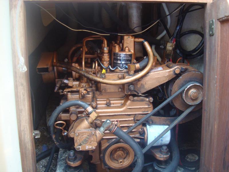

Ajay, I don't have a picture of my engine, but the thermostat controlled loop is not a small opening on the side of the thermostat. If you look how your water lines are plumbed, there is the main inlet hose from the water inlet sillcock. It runs up to the water pump. Then the water pump sends raw water cooling into the engine. The water then exists the block at the rear of the engine. My engine has a Y valve at the outlet hose which when open, allows water to flow out to the water muffler, or back to the thermostat controlled loop. When this valve is closed water flows only to the outlet / muffler. When open it allows water that has already been warmed by the engine back into the cooling circuit again. This allows the engine to warm up faster, & hence is supposed to improve start up efficiency & performance by getting the engine to operating temp. faster. The thermostat only opens up when it has reached 130 degrees. Like I posted before, I don't really like this because it can take 10 minutes or so until it warms up enough to allow raw water discharge out through the transom. So you don't really know if the pump is even cooling or flowing correctly, until the point at which it will quickly overheat if the thermostat doesn't open up. This is how a lot of car engines wind up overheating: from a failing to open thermostat. You could just remove it all together, but I just use the valve that opens the coling loop, unless I'm starting out in really cold weather. I'll try to find a pic of a 5411 which shows the plumbing for the raw water cooling. Its possible that your C 27 is plumbed differently from my C 30, & I know that access to view the engine is more difficult in your boat. Hope this helps & doesn't confuse you more.

Catalina 1980 C27 Meinke Marina on Lake Erie
Jrowan, this is a picture of my engine. The hose running from the block to the exhaust manifold is at the front of the engine and can be seen in the attached photo right next to the black Universal label . I don't have this Y valve you speak of. This must be because you have the muffler set up on you C30. I have no muffler. Out of the thermostat housing, which is at the back of the engine one hose runs from the bottom of the housing and is the return/recirculation line that goes back to the mixing tee. The other one runs from the top of the housing and snakes back to its attachment to the exhaust line. You can see this line just behind the trailer type electrical connector.
