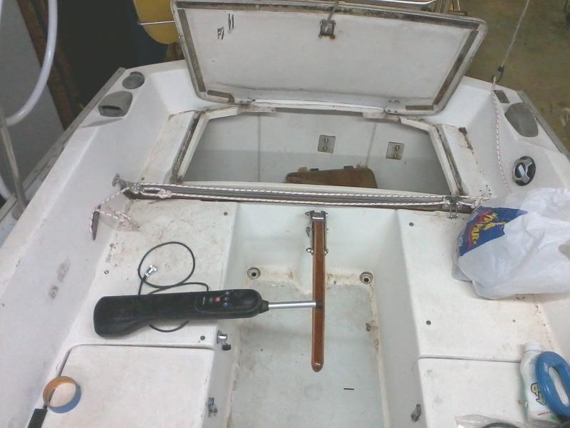

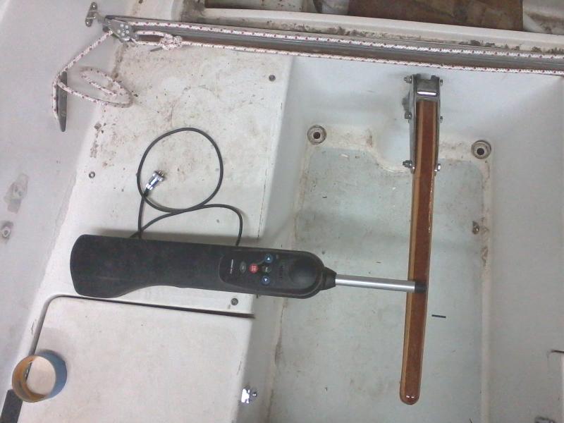

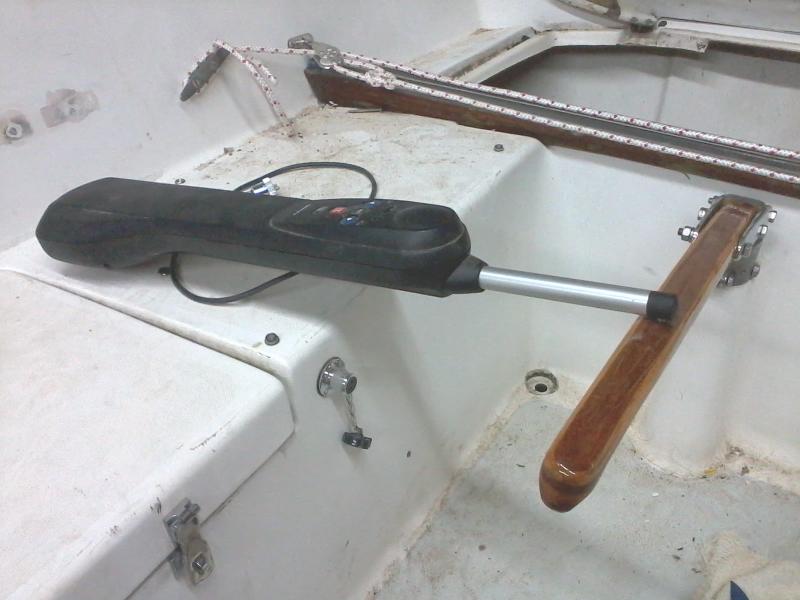

I am not at my boat to tell you the exact model, and I have not used it yet, as the tiller pilot came with the boat and I have yet to put it in the water, but here are some pictures of my setup.
I am more a social sailor than a racer and knee room is important to mee. See the "shorty" tiller I built. I hope that this combination of short tiller and tiler pilot will serve me for my needs, and hope that the tiller will have sufficient leverage for me to manually sail the boat as well. We will see..
Anyway, here are a few pics showing how mine is mounted. I have the brass bushing installed in the cockpit seat with the tiller pilot driving the shorty tiller on a pin that is a copy of the stock pin that comes with the tiller pilot, (the stock pin is in my long tiller handle).
Forgive the mess, the boat is in my shop going through a pretty significant refit. I am kinda particular, so just know when the boat hits the water she will be shiny and clean! :D
I should ALSO add that the electrical connection shown was provided by the PO as well. It is like many of the stock Catalina mast light wiring plugs, brass contacts and partial to corrosion while having a significant physical presence. I am not a fan of this plug / jack as it leaves a knee/shin banger in the front of the starboard cockpit seat when tiller pilot is disconnected as shown in the first pic. I would either put the removable plug under the starboard storage hatch, or use a connection system that left the jack flush and smooth when the tiller pilot is not connected. I am in fresh water and am considering using a Switchcraft brand 3-pin micorphone connection, (part A3M and D3F) for this, as they are corrosion resistent and waterproof for use in damp conditions. I think the connections are stainless...

We put ours in the cockpit seta on our C25 with an under tiller bracket. Worked just fine, could still use the locker underneath by simply lifting the AP. Avoided the coaming mount with extra bracket or extender rods. See if you can avoid those, even though they work for many people, it's only because you ended up putting the AP further away than it needed to be.

Thanks for the pics Phil.

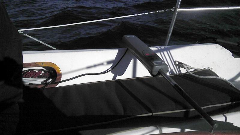

I got out there yesterday and took some picts of the setup.
By mounting it on the gunnel it allow me to have a cushion. Putting the plug in the coaming protects it from weather and bumping. The remote control connector is also in the coaming. When not in use it swings back and sits on top of the gunnel supported by the stanchion. You can see it briefly at the end of the video featured in my other post.

Thanks for getting back with the Pic, Caguy. I like that setup, especially considering that cockpit cushions are my next purchase. I don't have combing boxes so I'll have to do something different there.
Thanks again, Joel H.

That is exactly the same set-up we're using - with room for the cushion to rest under the arm.
We're finishing the installation today!
