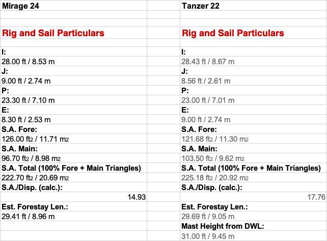

Just for fun I started by looking at the 2 boats specifications. They appear on the surface to be similar. Both were developed in Canada. They participated in MORC and Class racing. They appear to have been developed to meet a market of sailors that were not supported. That mid range of buyers who wanted a "pocket Yacht" in the low 7m size of boat. More than a day sailor, not quite an ocean cruiser.
Mirage 24
Mirage 24
Tanzer 22
With this quick look the similarities of the boats would say "Why not give her a try".
I would examine the masts of both boats. Looking at thickness of metal, hardware attachments, how the sail will fit on the new mast, the standing rigging materials, etc.

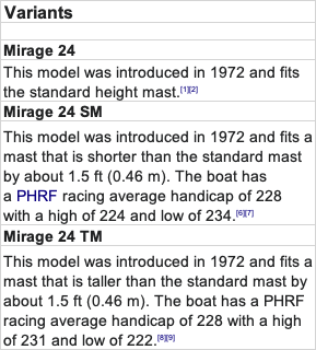

If all that does not send you running to the boat shed, it seems like a reasonable experiment to explore. I note that the makers of the Mirage played with the mast as they built their boat. They added and subtracted as much as 0.46m to the mast length. If they can do it, it sure seems that you should give it a try.
