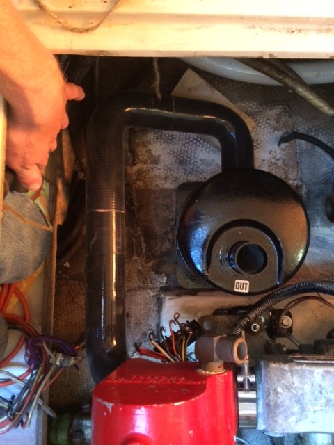

FWIW, a MUCH better (albeit more $$) option than the leak prone Aqualift is to replace the 1-1/4 pipe exhaust riser (which will eventually fail) with the Universal water cooled riser and a side inlet Centek muffler. The compartment runs cool, there's no insulation needed on the riser, and the riser won't burn up as the pipe risers do.
The pic is the dry fit of the third set up that I have designed for and supplied to owners (this on a MK-II, M-25XPB repower.) The riser is red because it was a gently used (Westerbeke red) one that I had and all exhaust hoses are silicone. The exhaust hose will immediately turn west with a silicone elbow and head behind the ice box -- thus freeing up storage space in the galley cabinet above.
