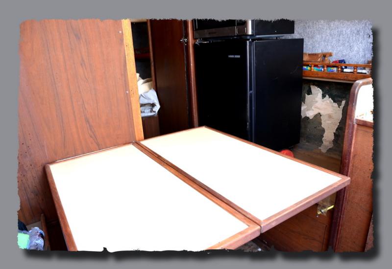

We slip on a small lake, and our cooking will be shore power on the boat, and a barbecue grill at the clubhouse.
In the boat, microwave. Still being installed, ruffed it in yesterday. Just peeking out above the refrig / freezer. There was a charcoal stove in that location, which I am pleased is out now.
