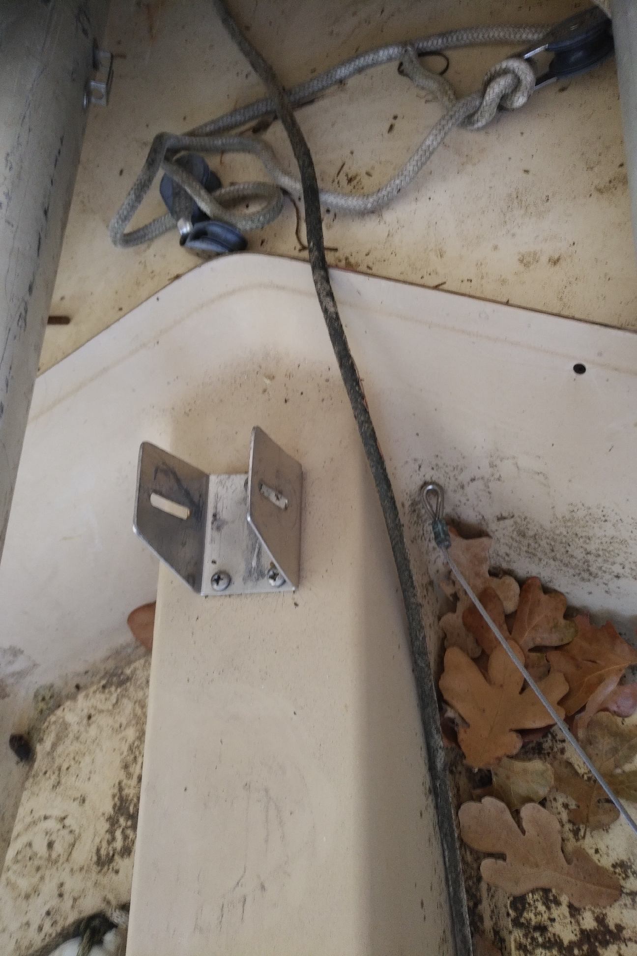

I'm not sure why you could'nt add two inch pad under the pivot plat in the hull
I was thinking the same thing. I'll remove the pivot plate and see if I can determine how long a wooden base I can secure for the pivot plate to set on.

If I had to take a guess I would say a plastic block would be the fastest/easiest. With wood you'd have to seal it. Rectangular aluminum might work if you knew what kind of load the mast is exerted on the mast step (pivot plate)

I have some penetrating epoxy sealer left over. I will coat the wood with that, then sand it and varnish it. No cost for that.

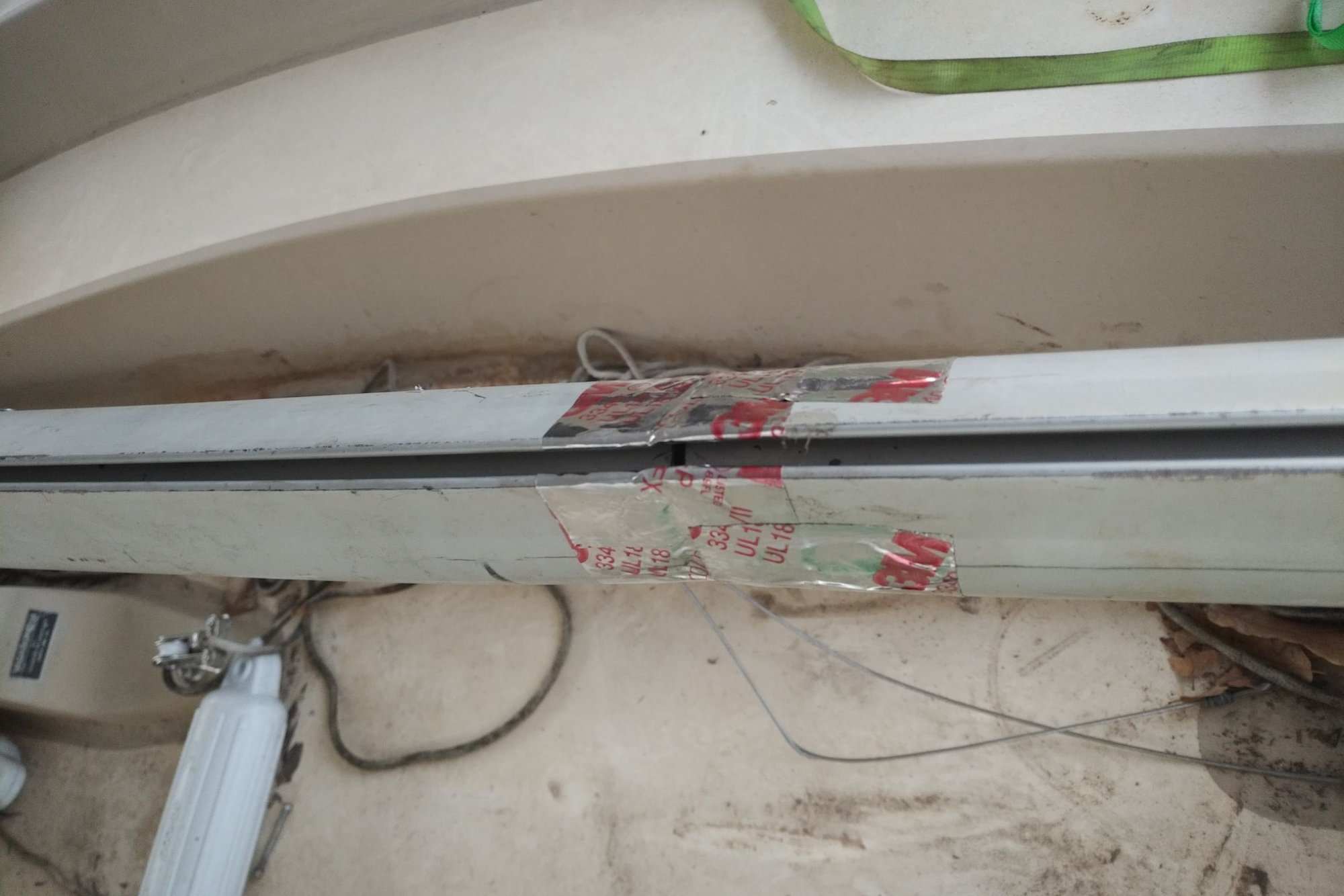

Mast has been put back together. Here's a look at the repair. I covered the joint with aluminum tape to make sure no sharp edges. There's a 3 foot long aluminum pipe inserted. Epoxied and riveted.

If the tape is in the track I would remove it. It's likely to come off as the sail goes up and down and the sun will make the adhesive very gooey after a while. The track edges also need to be filed and lined up with one another. If they aren't your sail will get caught and/or damaged as it slides
S
sbrogden
I filed down the edges before putting tape on it. It's all weather tape. The track edges are aligned.

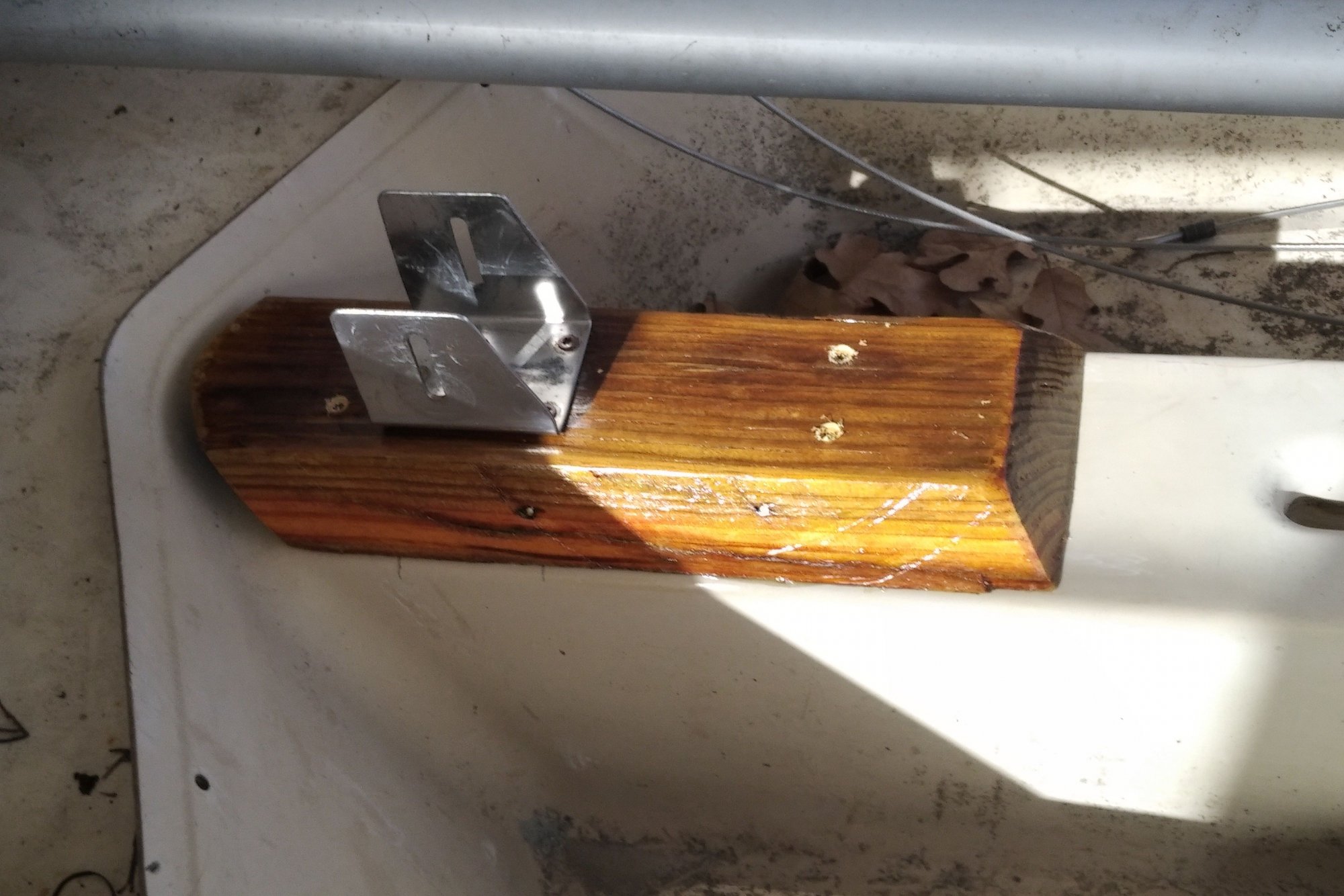

The 1-1/2 inch platform under the mast base plate is in place. Two coats of epoxy sealer and varnish on the wood. Bonded with epoxy and screws to the boat.
