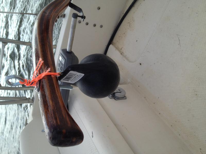

So my anti vibration solution works really well, but as always I am seeking improvements on my solution. With the weight on the tiller (see picture) it makes it a lot quieter, however it looks so make shift and unattractive. Does anyone or has anyone installed a delrin bushing into the pintel so when the the rudder is installed a tighter fit with no space for vibration is found?
