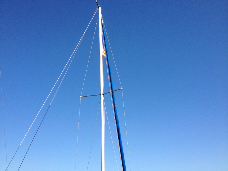

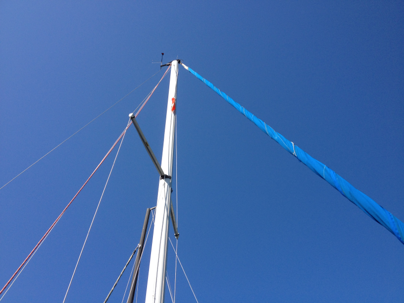

I want to fly my burgee correctly, but the line is not tight so the burgee doesn't fly right. What is the line called that the burgee flys on and how do I make it right? I have a O'day 272.

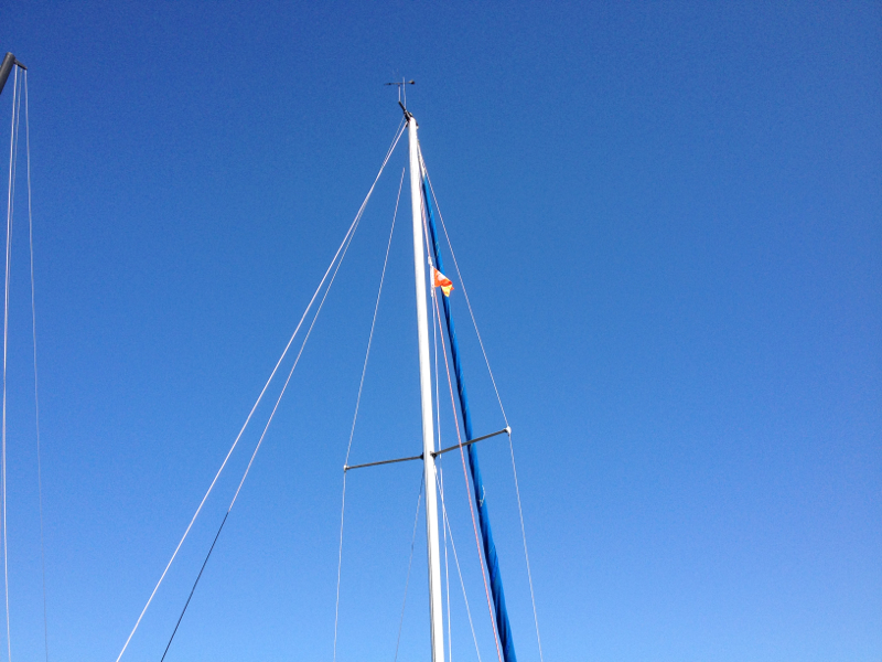

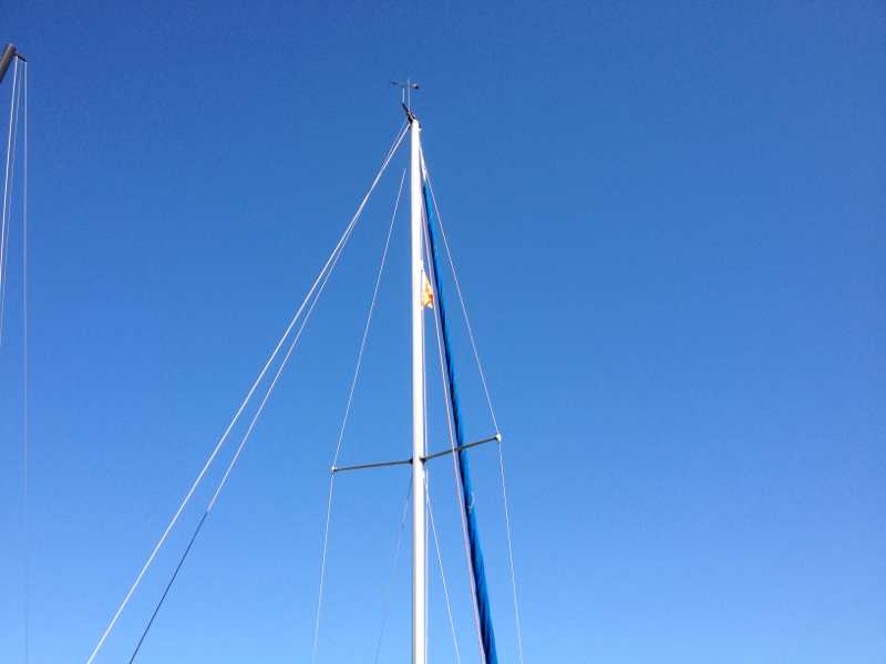

On both my previous boat (a 272LE) and my current 322, I pop-riveted a small eye strap to the underside of one of the spreaders and attached a small block. I reaved a line (1/8" ought to do) through the block, and attached a flag clip or small snap shackle at each end. Clip on the burgee, and secure the flag halyard to a shroud cleat. The burgee can be flown as tight as you want it.

You could mount a cheek block on the Starboard side of your mast near the mast head for a flag halyard which you can send up a pig stick with the burgee attached to it, and cleat it off down on the mast.
The pig stick will allow your burgee to fly above the radio antenna and wind indicator. flag staffs or "pig sticks" as they are called, can be noisy at night with a wind blowing.
The Starboard spreader on my mast has a hole in it about in the middle where a small sheave could be attached to it for flying a burgee, and I don't think a flag staff would be needed but I could be wrong on that.
The halyard could be cleated off on a shroud horn cleat. This may be a better way to rig it on your boat, and on mine as well.
