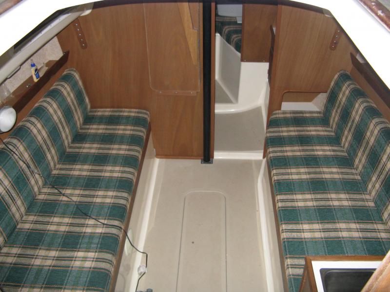

I need to replace plywwod on my 23 ft oday
im told it is teak!!
i would like to replace with another type of plywood specifically okoume- iwould have to replace both sides so they would match!!(cheaper costs than teak)
i could also replace just the one side of doorway with teak-not sure if it would match what is there now
i would like any input what would look the best or if you have also done an upgrade
Thanx

Joubert Okoume is BS 1088 certified. Lloyds approved. The downside is it doesn't match teak. That and once you start you may not be able to stop. At 140.00 for a 12mm X 4' X 8' sheet you can do both sides with one sheet. I used 4 on my 27.

You may be able to stain the okoume to match the color of the teak. The grain won't be the same but if the color matches it won't be that noticeable.
If you plan on over coating with epoxy (and you should, okoume has terrible rot resistance), use a water or alcohol based stain to be compatible with the epoxy. Oil based will prevent the epoxy from penetrating.

Spend the money and buy a sheet of marine grade teak. Remeber those bulkheads are what hold your mast when you are having the most fun sailing. It is also beautiful and will match everything else in the boat. Trying to use other woods and color matching will not work and cost you great amounts of time. Buy the teak plywood and never look back.

My original bulkheads and the interior were all pretty dark, but I'm not sure it that was due to something a PO did or not. At any rate, I used Okoume, staining it to match the old woodwork. You can see some pics in my profile.

i did but teak, what should i use on surface-sealant, stain, clearcoat...the old teak is darker than one bought and does not have a glossy finish-any suggestions

I experimented with some different stains and found that a red oak and chestnut stain mixed together approximated the old teak stain in my boat. Trial and error, using strips of left over scrap. I pulled the old forward half bulkheads and refinished them when doing the new ones, so that all would have a glossier finish.
You may consider sealing the edges of the bulkheads so that if you do have leaks, the water will not penetrate. I used CPES on the edges and the outer 3 inches. Some people use straight epoxy instead.
