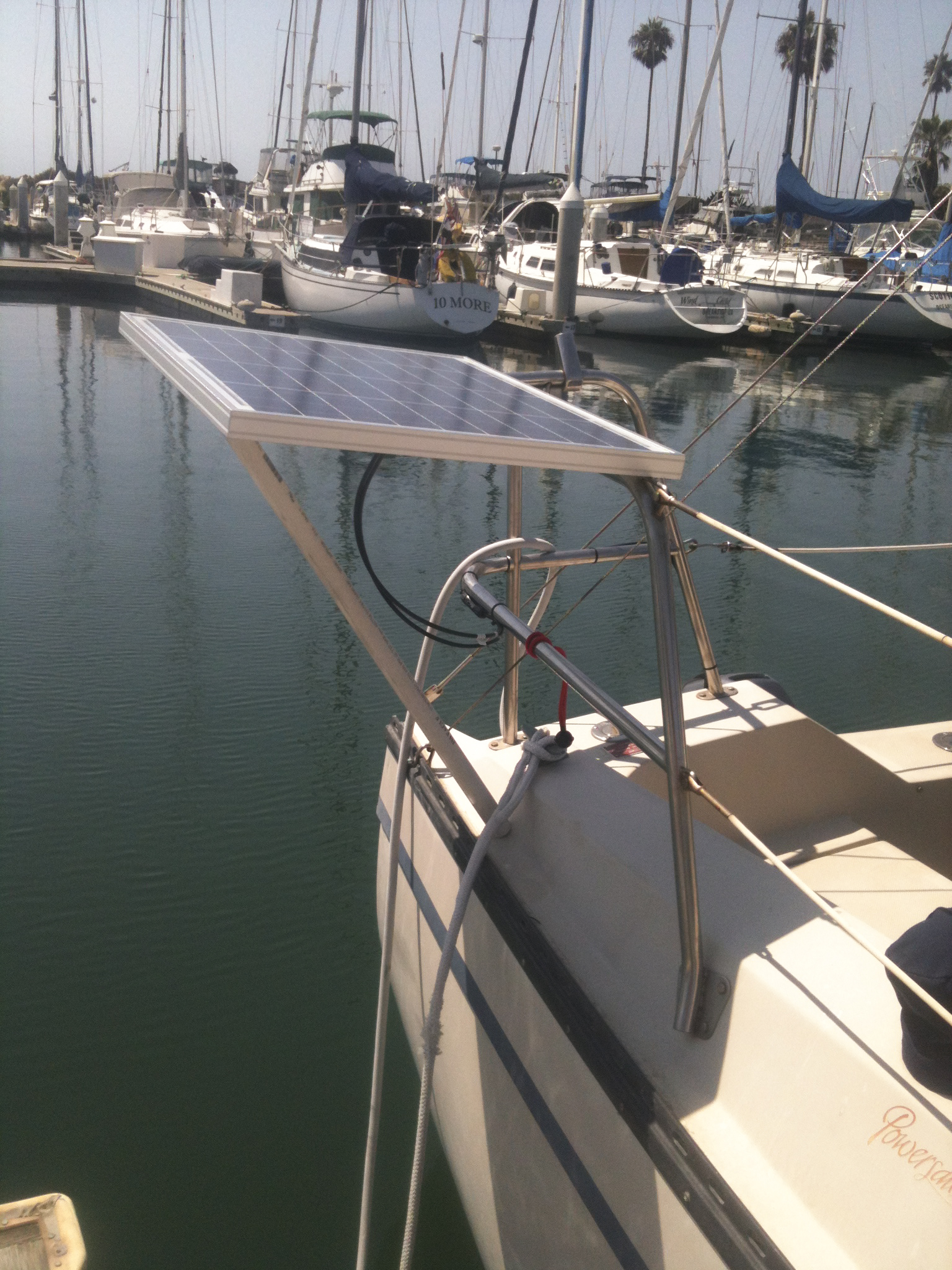

My panel is mounted on my starboard stern rail. I use a PVC pipe to keep the panel horizontal, but can drop the panel to vertical if need be. I am sure you will find a good location for yours.
Good luck!

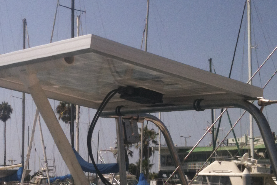

Look at Main Sails recent posts. Last week he released a prototype solar mount made to attach to the back stay

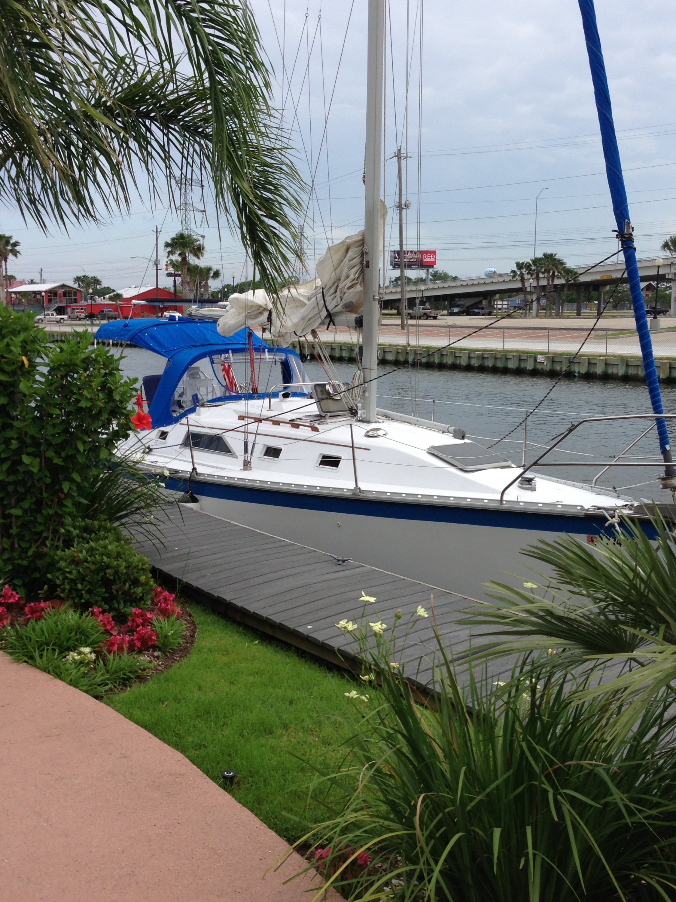

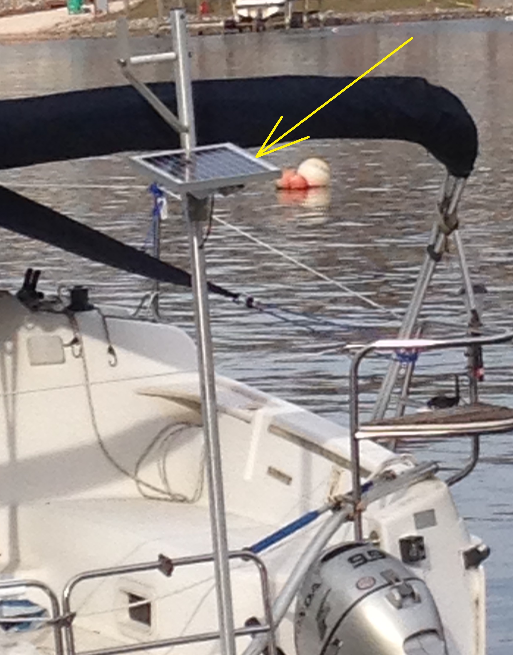

My PO mounted a solar panel on the split back stay on a pvc pipe using some brackets mounted to the stays. I will try to remember to take a pic next time I'm at the boat. It sits above the bimini. I thought it was a very clever solution. Here is a picture from far off. If you zoom in you will get the idea.

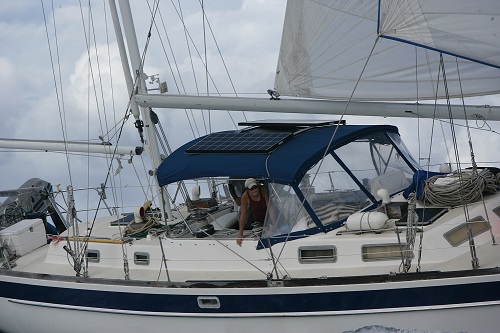

We mounted ours directly to the Bimini, it was fast, cheap and simple. We will mount it to bars over the Bimini soon.
