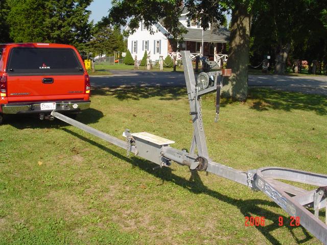

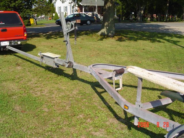

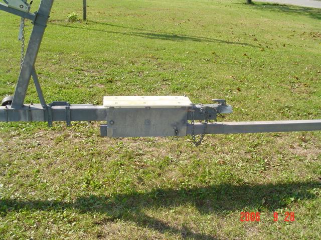

One of my friends built his on tongue extender and he purchased galvanized steel to build it. I think that he bought a 10' piece of 3" square tube for about $70 back then. He uses a pin to keep it in place.
23,544
Joe, that's a nifty add-on extender
Some of the other types have the extender installed right to the hitch ball, so the extender tongue slides into the trailer fork main section, which is what we had. I agree, if it's separate as shown in your pictures it'd be better galvanized. If it's a "slide-in" type, plain would be fine to be able to fit and slide in and out freely.
