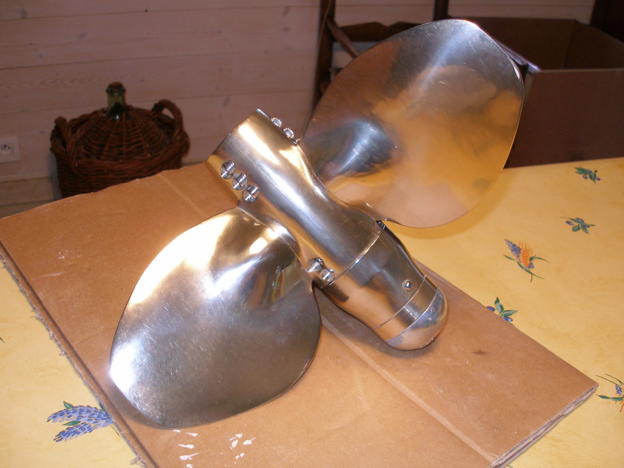

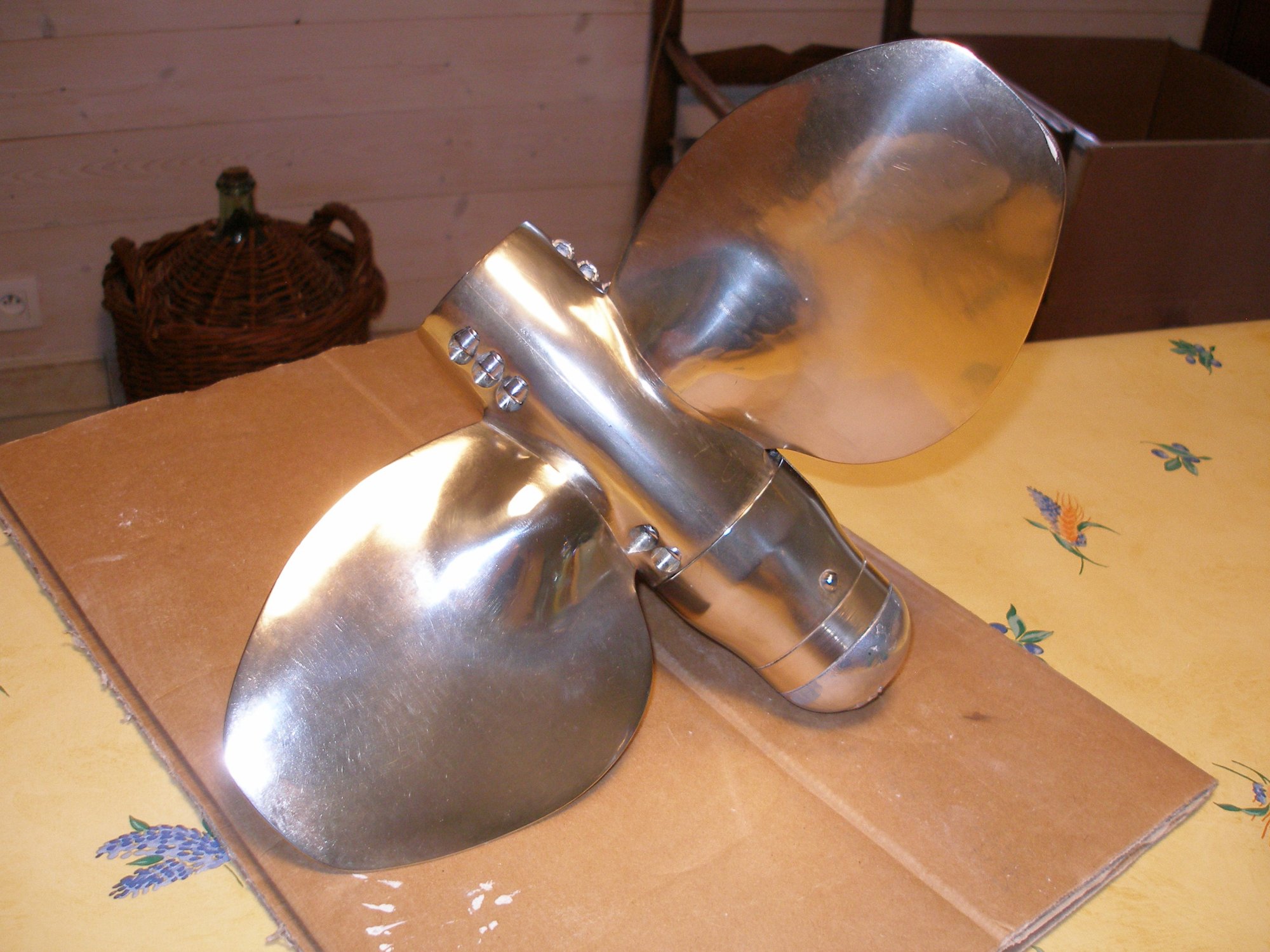

I never applied anything on my J Prop propellor. I installed that prop 4 years ago and I mirror polished it before installation.
Since, every year I scrub it with a piece of hard wood cut in bisual to clean the minor things on it which cannot stick with the mirror polishing. A little more polishing before the boat goes back to the sea and that's it for a complete year.
It's about one hour year every year.
