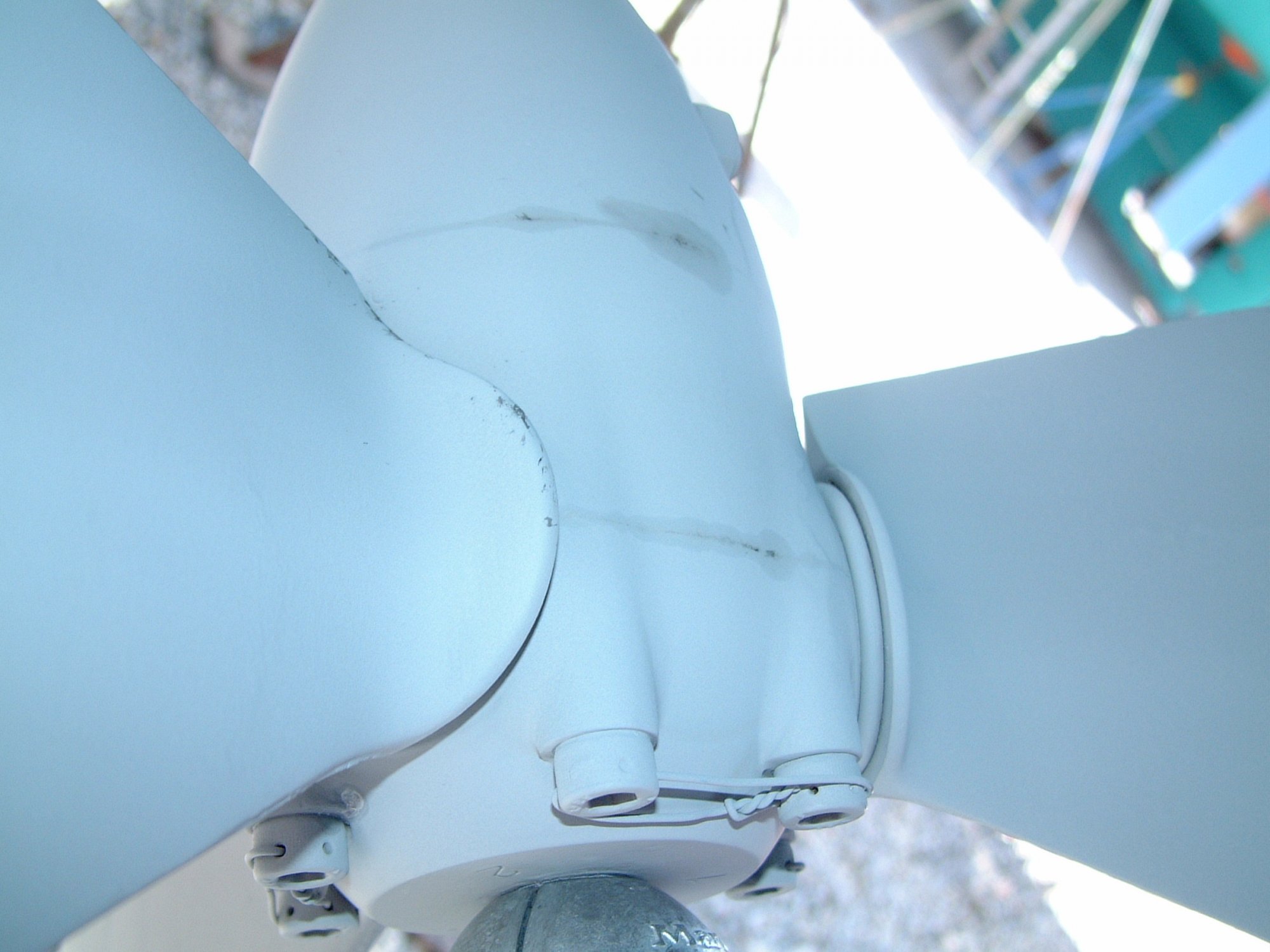

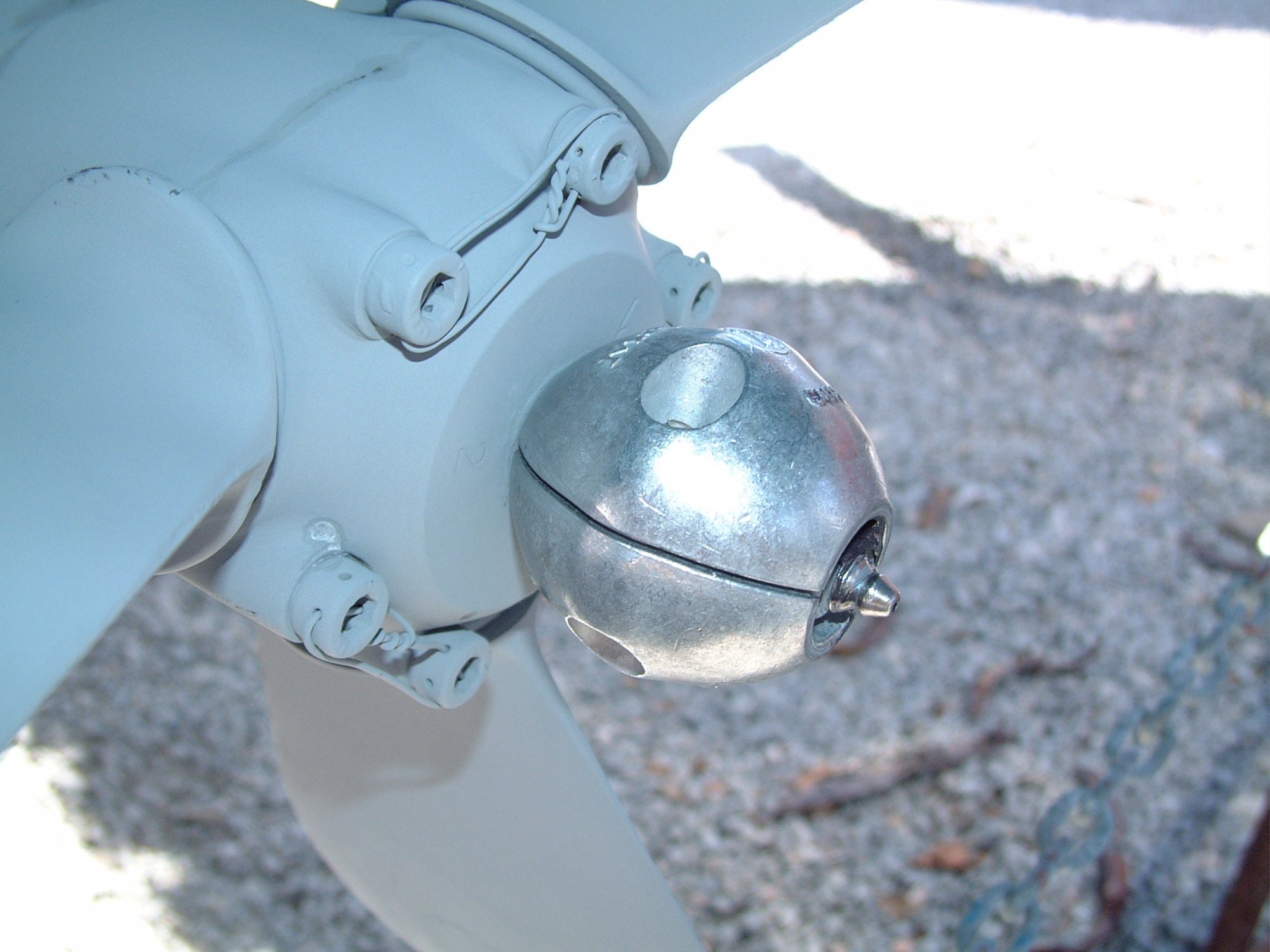

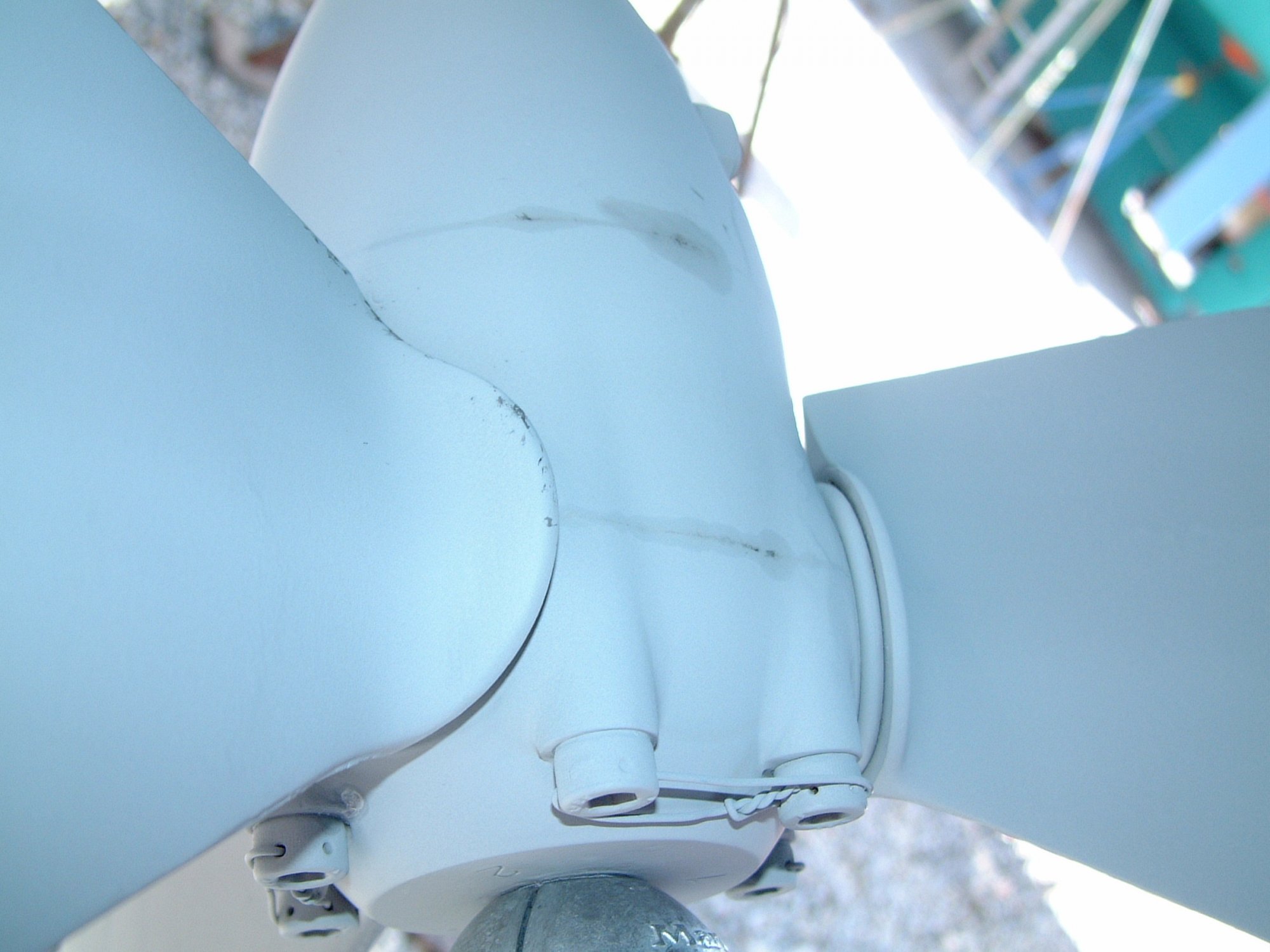

Or you can use the Pettit Barnacle spray - about $30 for a 16 oz spray can. Or the generic "Cold Galvanize" spray that is sold under various labels like Ace (check the ingredients against the Pettit- they are the same). I have used the Ace or Rustoleum brand Cold Galvanize for 12+ years and found it works as well as anything else. About $8 per 20 oz can and will do the prop for two years of application.

nothing else over it- just the galv?

Yup. That's it. I clean the prop very well with a stainless wire wheel in a drill, wipe down with acetone, and spray on 3 thin coats. BTW, I do have a Stainless steel prop so maybe you need to use a different wire brush to clean yours.
