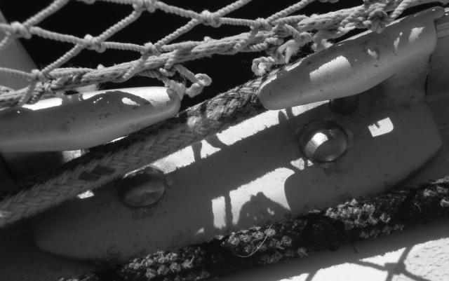

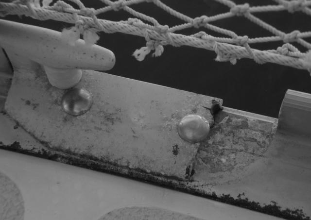

I have a broken midship chock on a Hunter 42 Passage 1994 that I need to replace. It is 6 inches long and attaches to the metal toe rail. Would anyone out there know where I can find one of these please? I still have the attaching hardware, just need the chock. I am attaching photos. One of the broken one and one that shows what it should look like. Any advise would be greatly appreciated! Thank you.

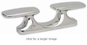

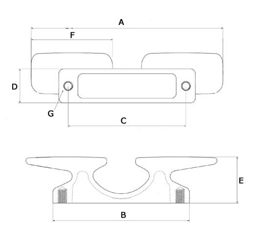

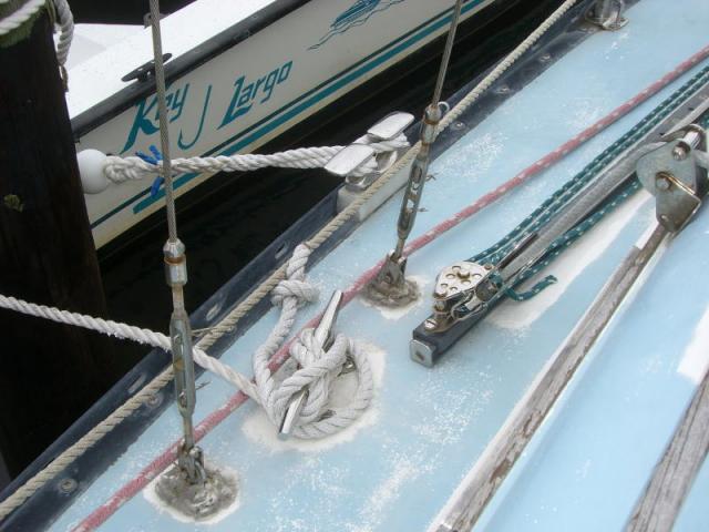

If it were me I would have stopped needlessly making myself crazy about this about two weeks ago. You will get no help from Hunter. Period. Been there, gave up.
I would mount a couple of New Found Metals chocks. Oh wait, I did. Simple to mount, beautiful, strong as solid stainless steel. Only about $50.00 each.You might have to cut away an inch or so more of the toe rail. Not worth thinking about. Images below.
The third picture is one of the chocks I installed on my Hunter 33. I mounted it up on a spacer to avoid cutting toe rail. In your case it is cut already so opening it up is no big deal. The cleat is N F M also.
