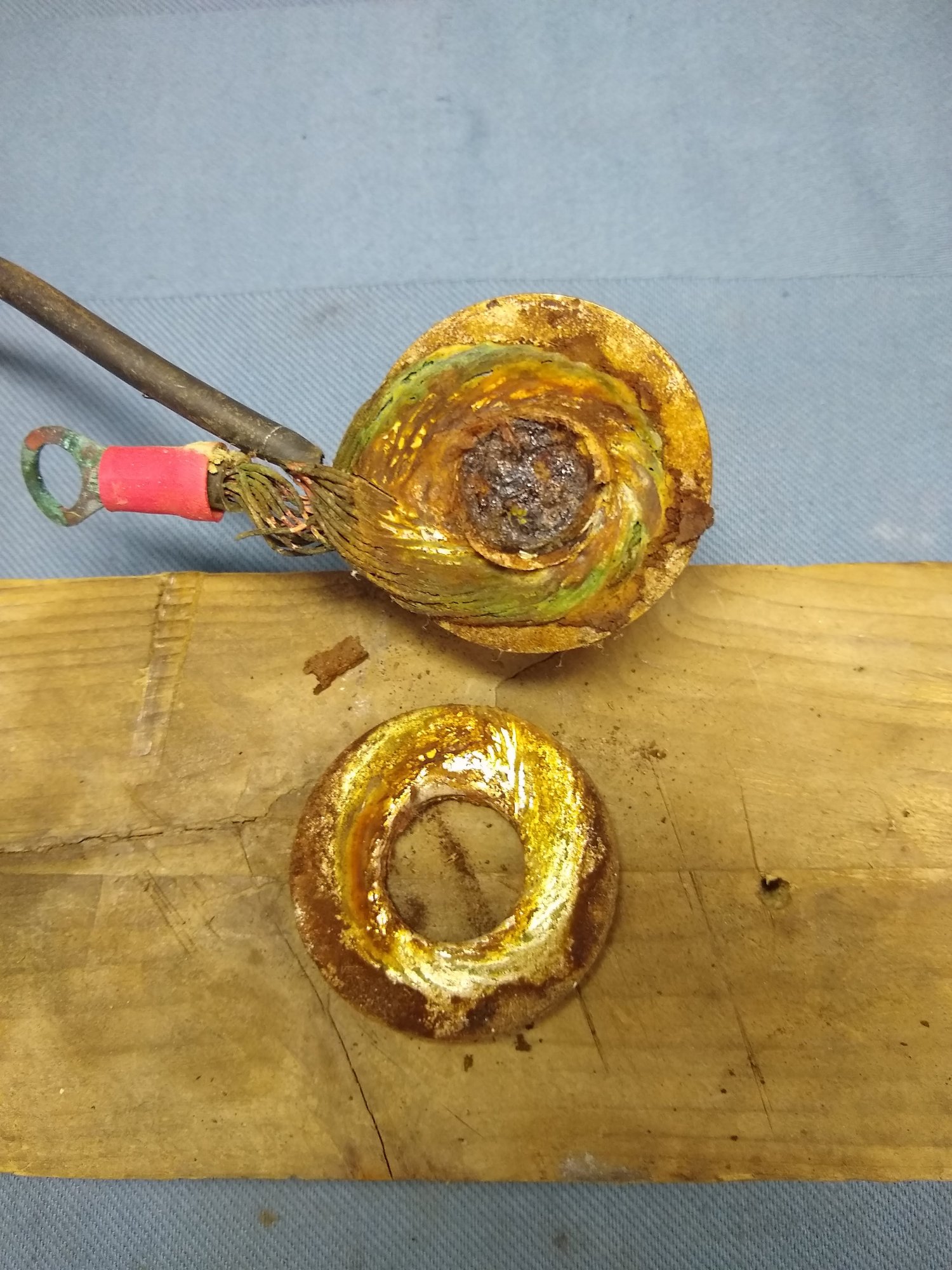

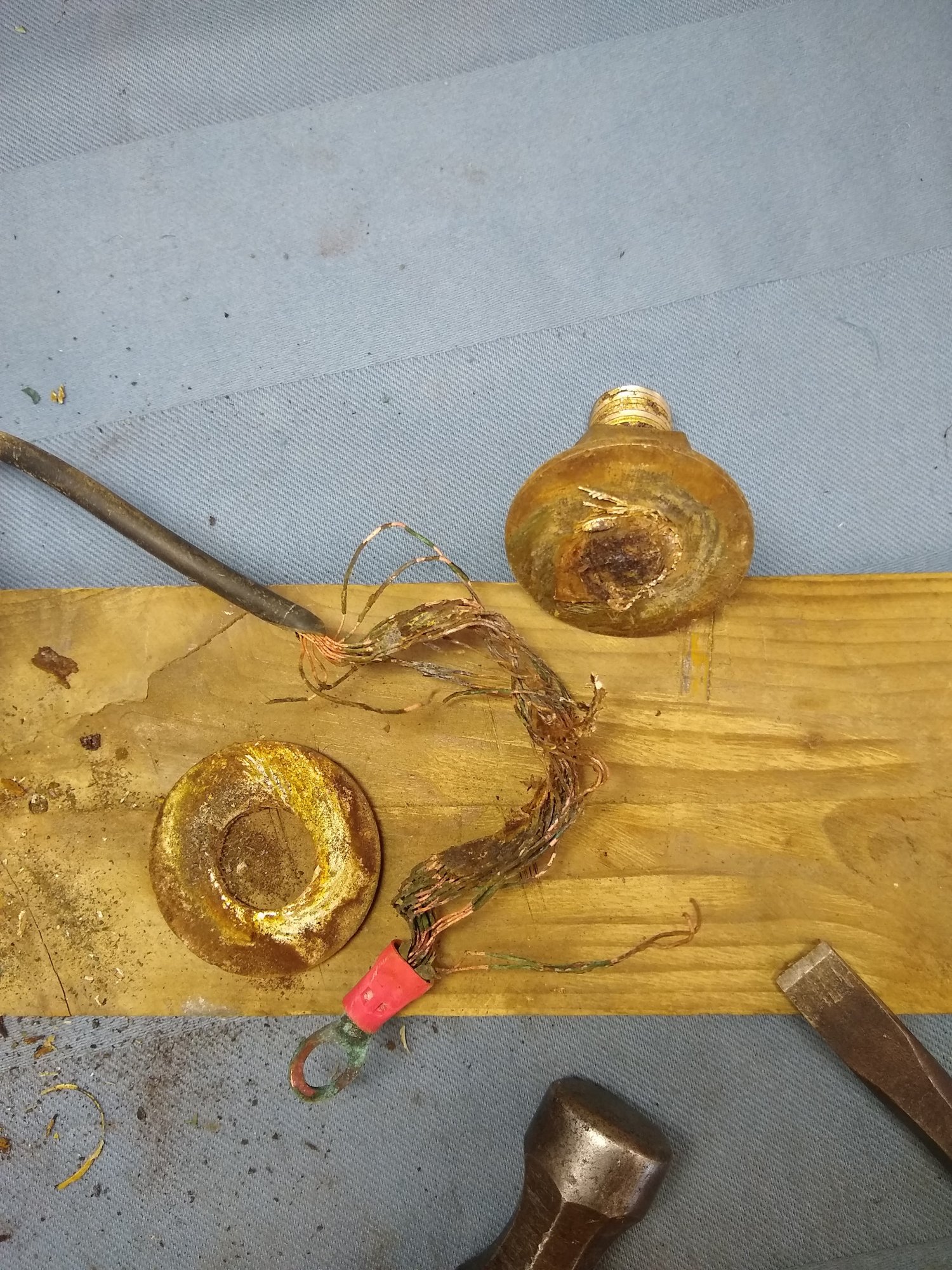

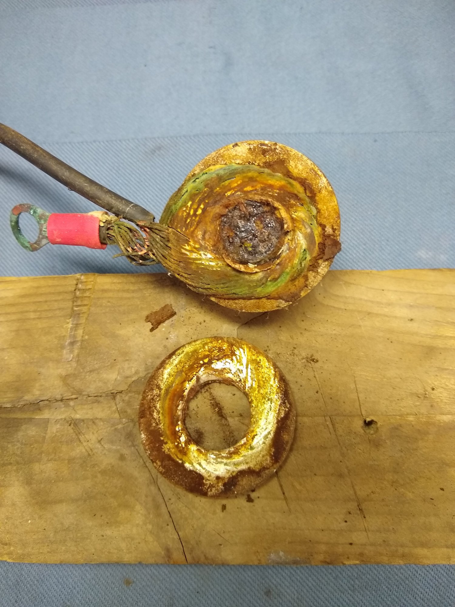

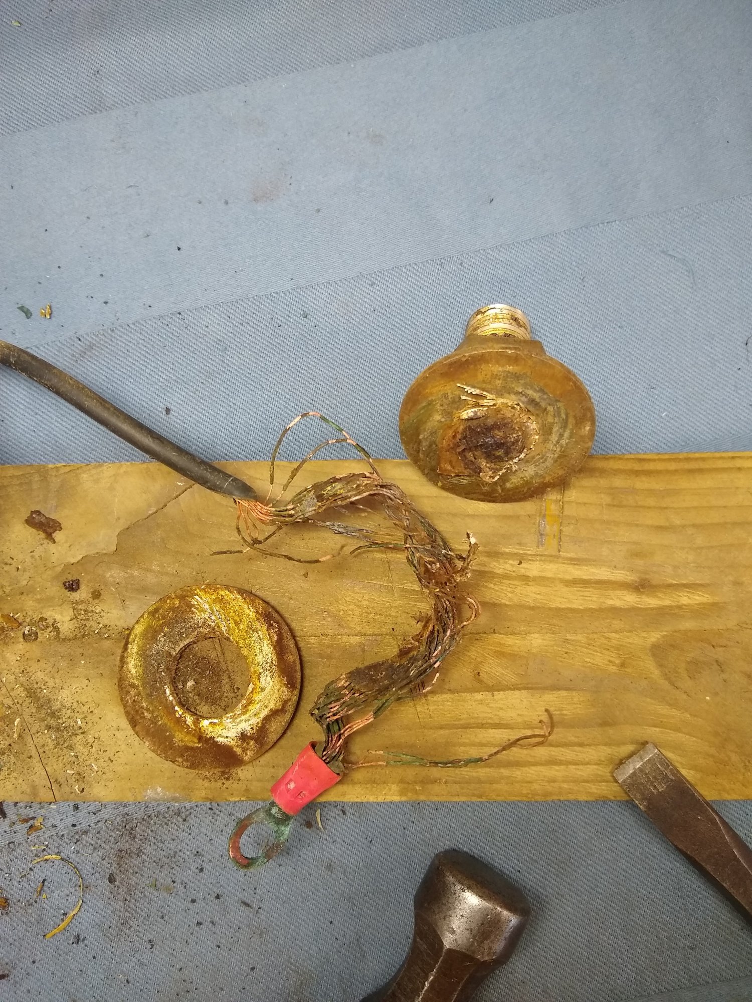

The #1 keel bolt, starting #s at the bow, had the copper grounding wire wrapped around the keel bolt and compressed between two washers from the factory before the floor pan was installed in the hull as there would be no way it could have been done later.
Of course this bolt is completely hidden and only visible through removing the glued in place head/shower drain.

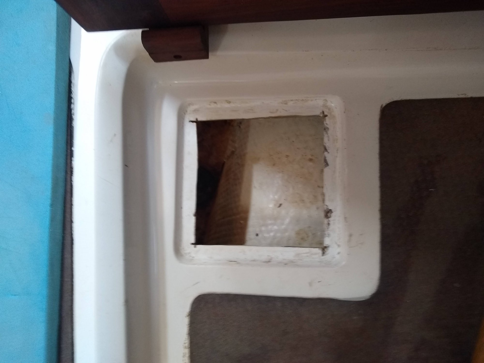

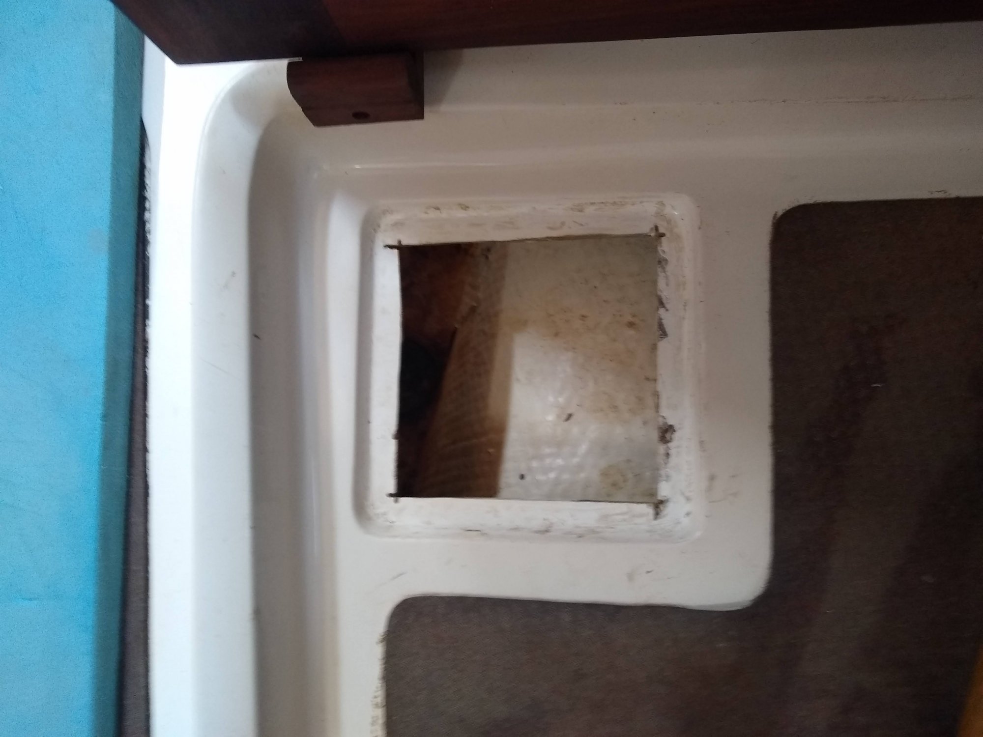

It will not be easy to drill/chisel/grind out the glass around the bolt for the coupler and I will probably have to make another access hole in the floor near the blue cushion to get the job done.
I wish this was accessible as the ones on your H27.

About the only solution I can think of is to cut an access window in the pan above the broken keel bolt. It appears from your photo that the copper wire wrapped around the bolt exacerbated the crevice corrosion.
