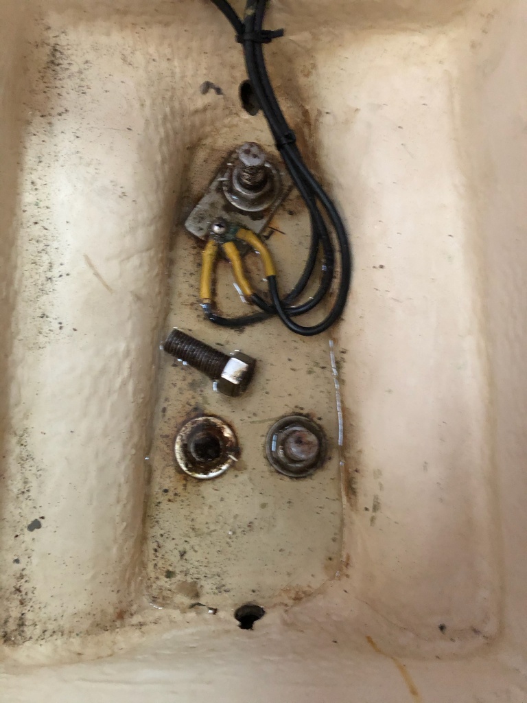

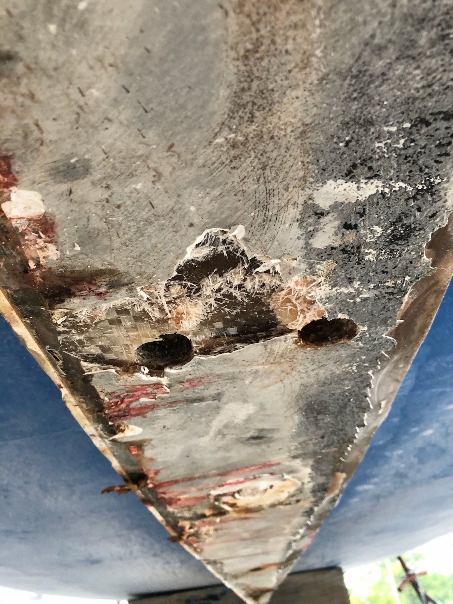

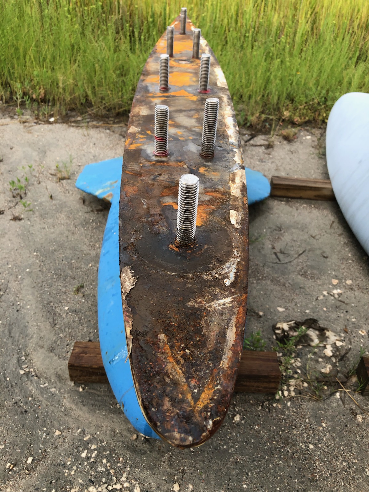

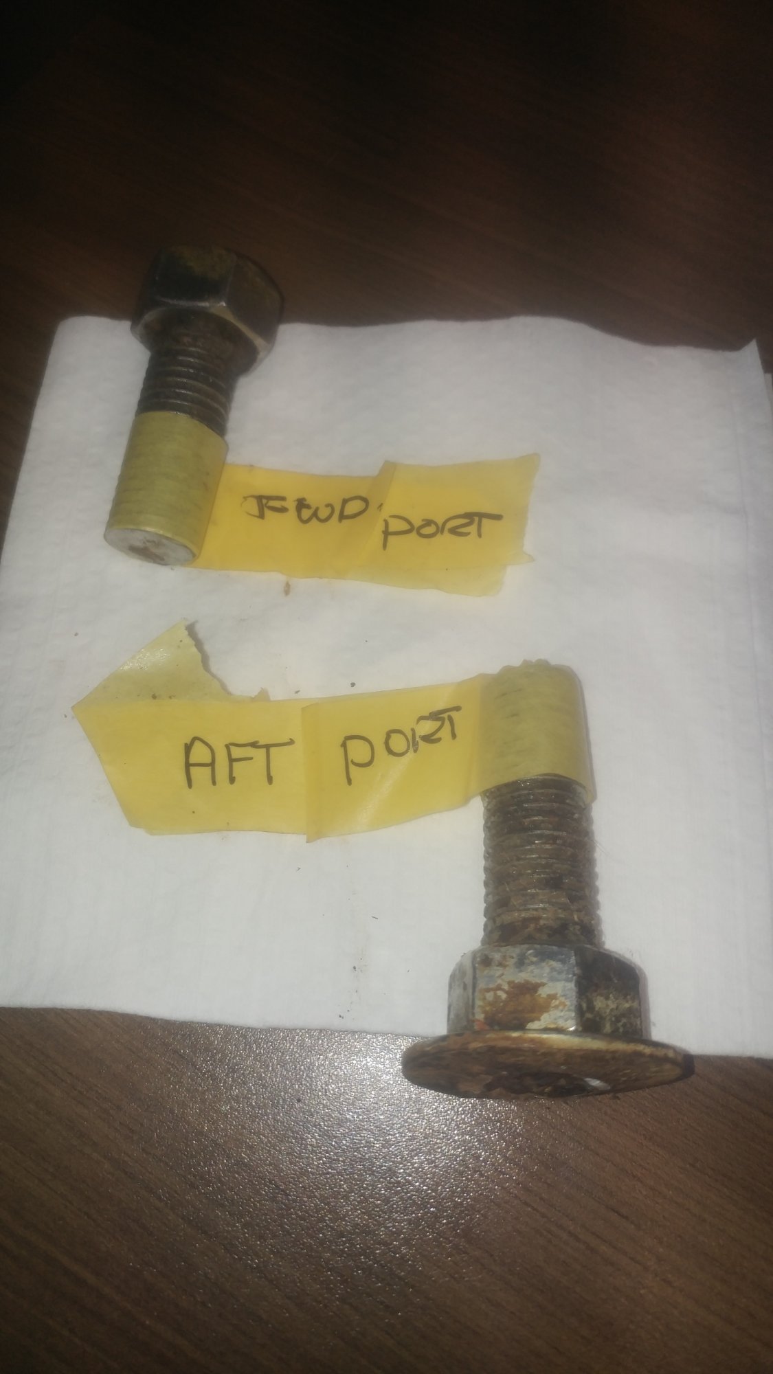

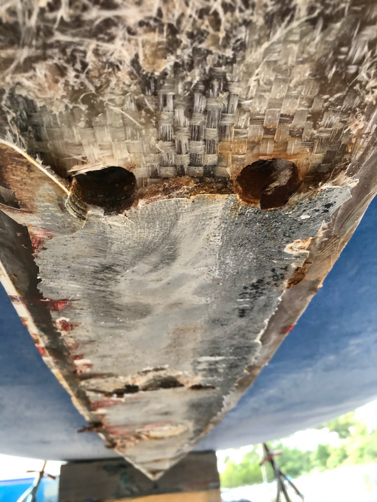

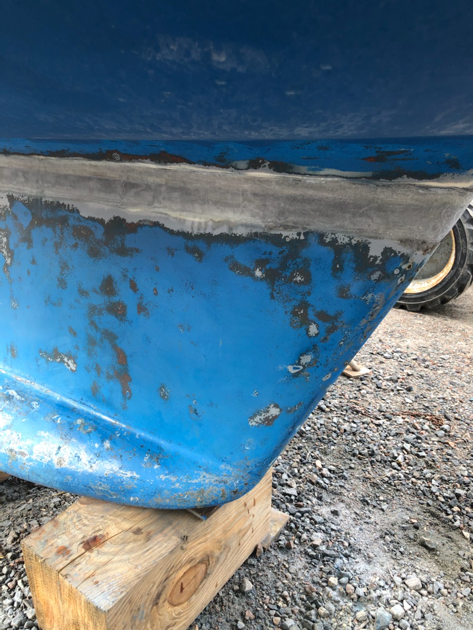

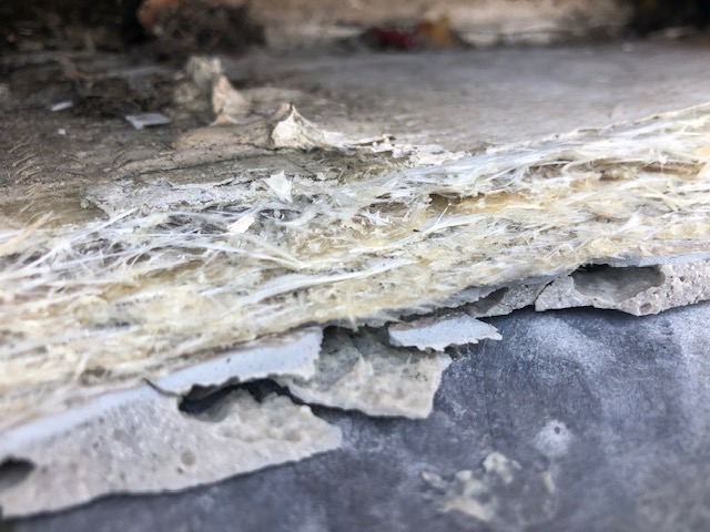

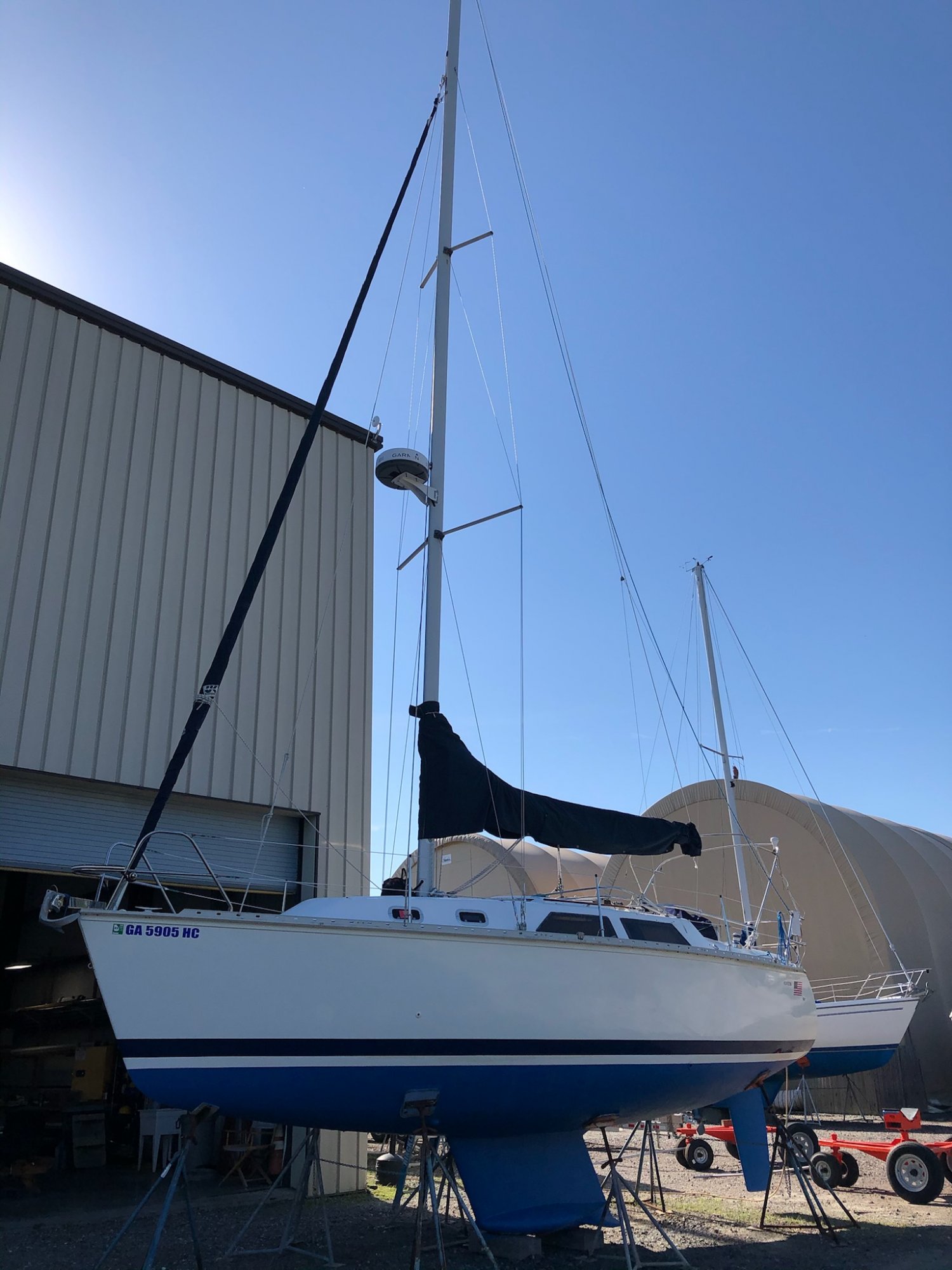

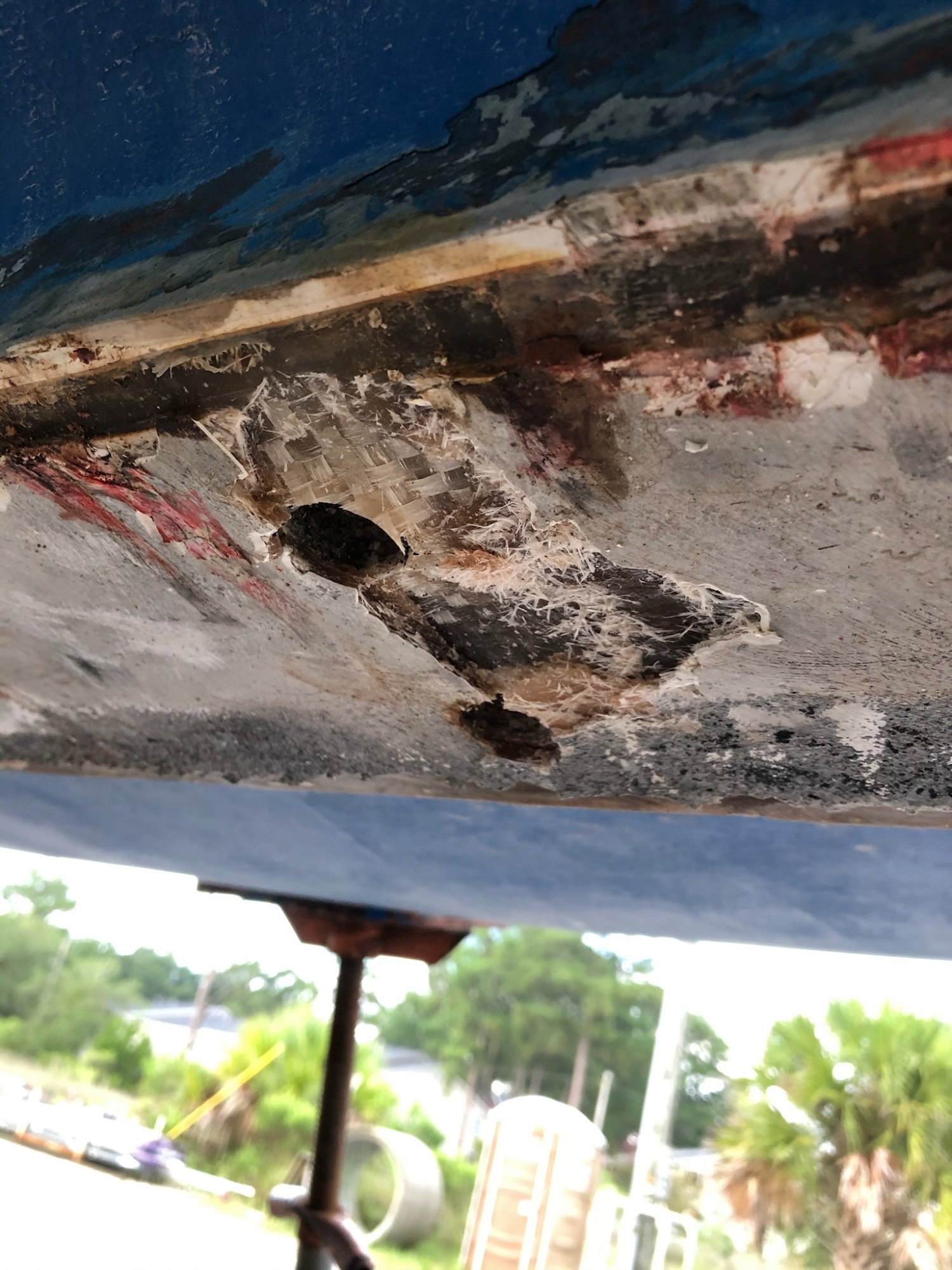

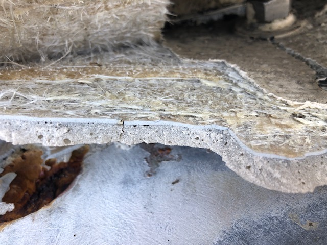

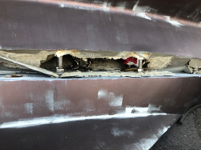

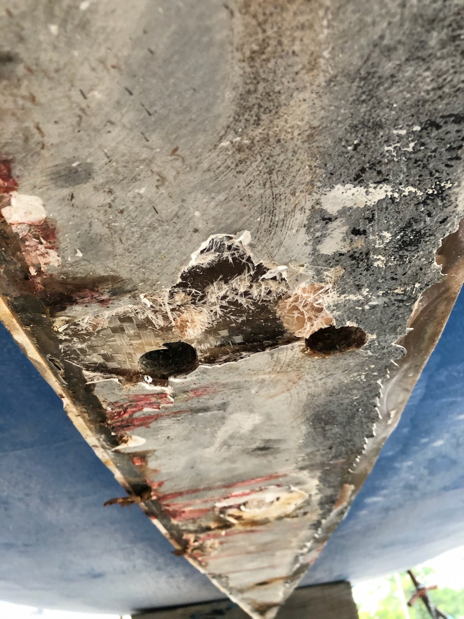

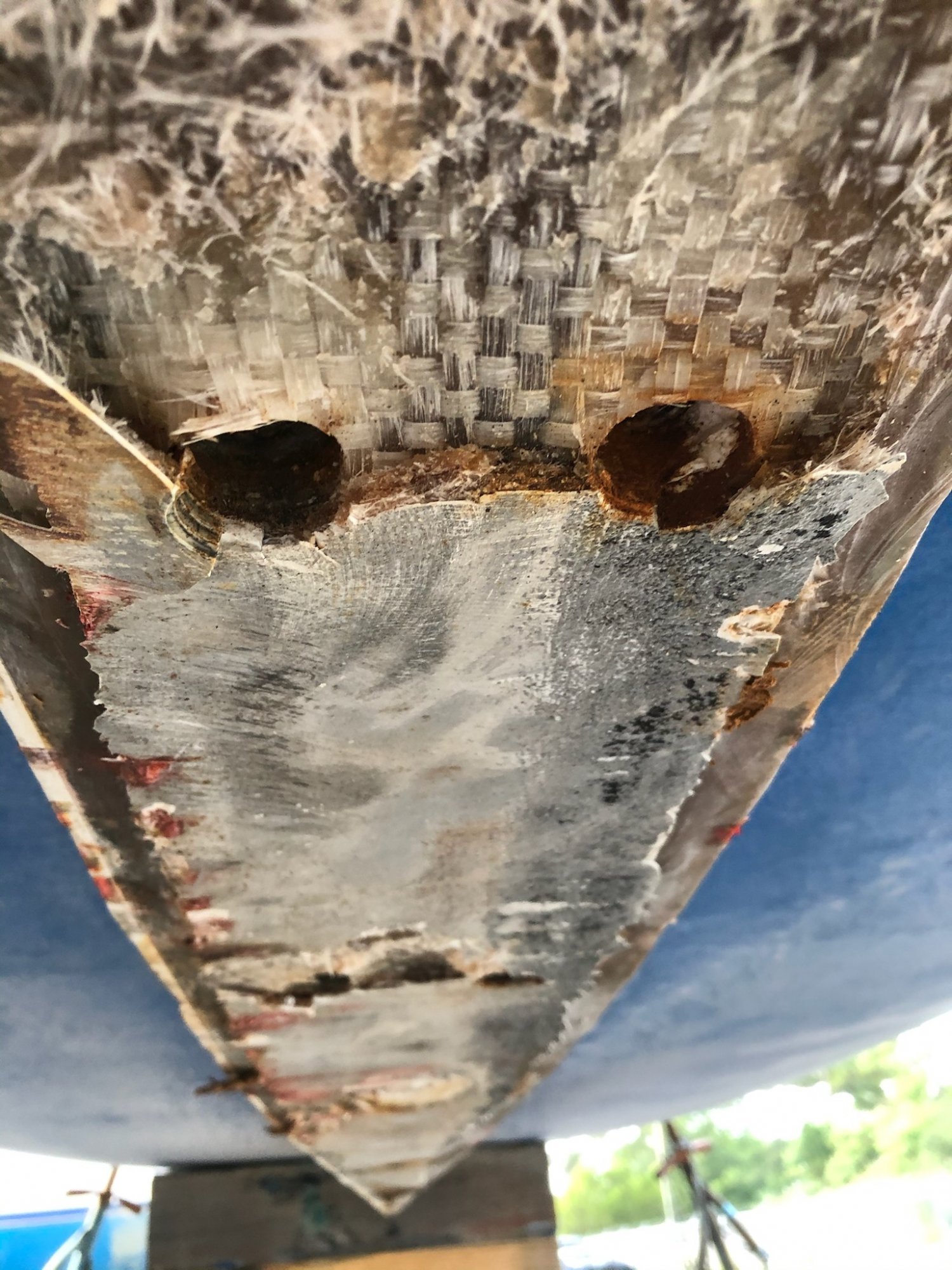

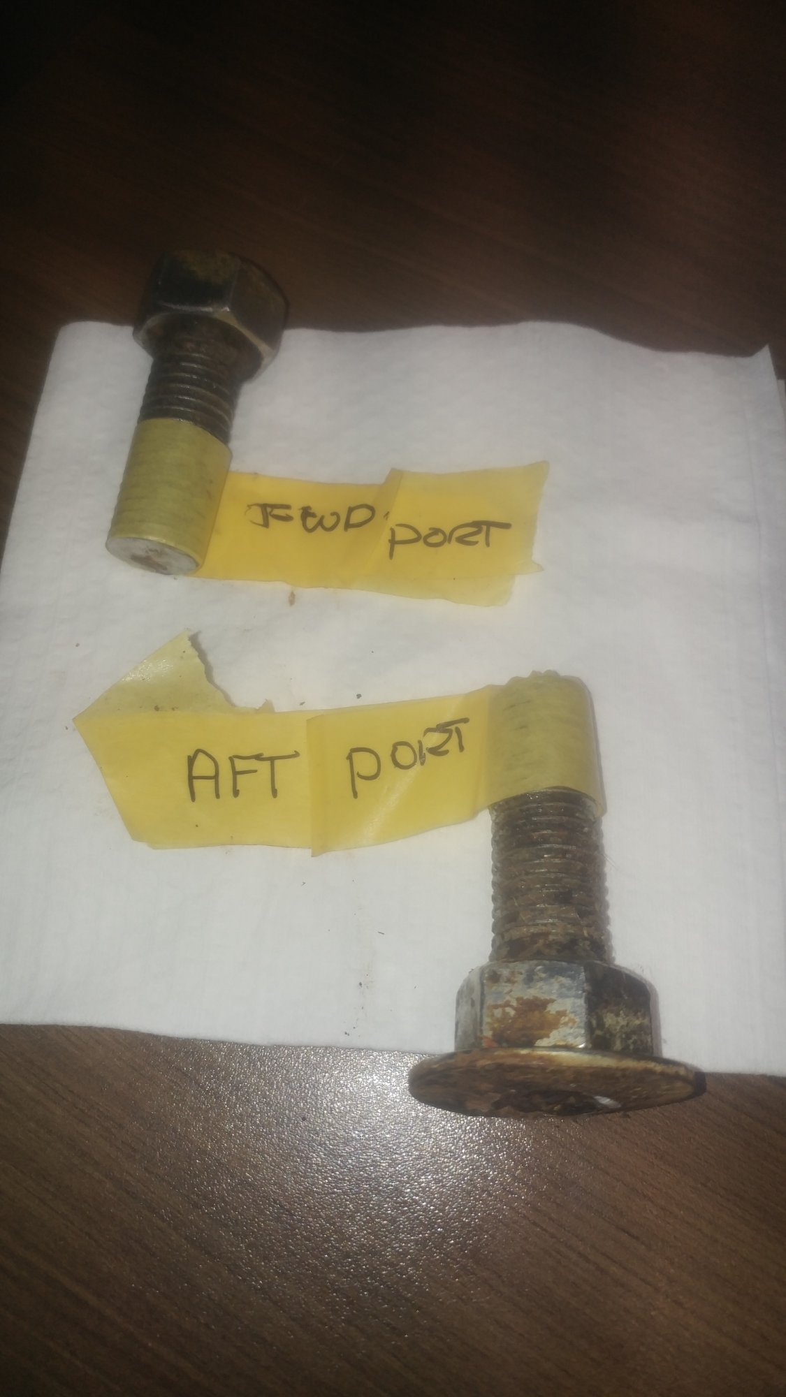

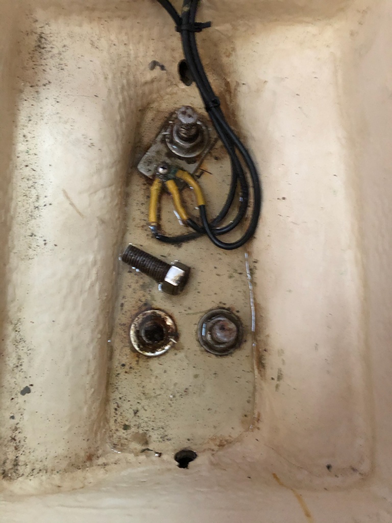

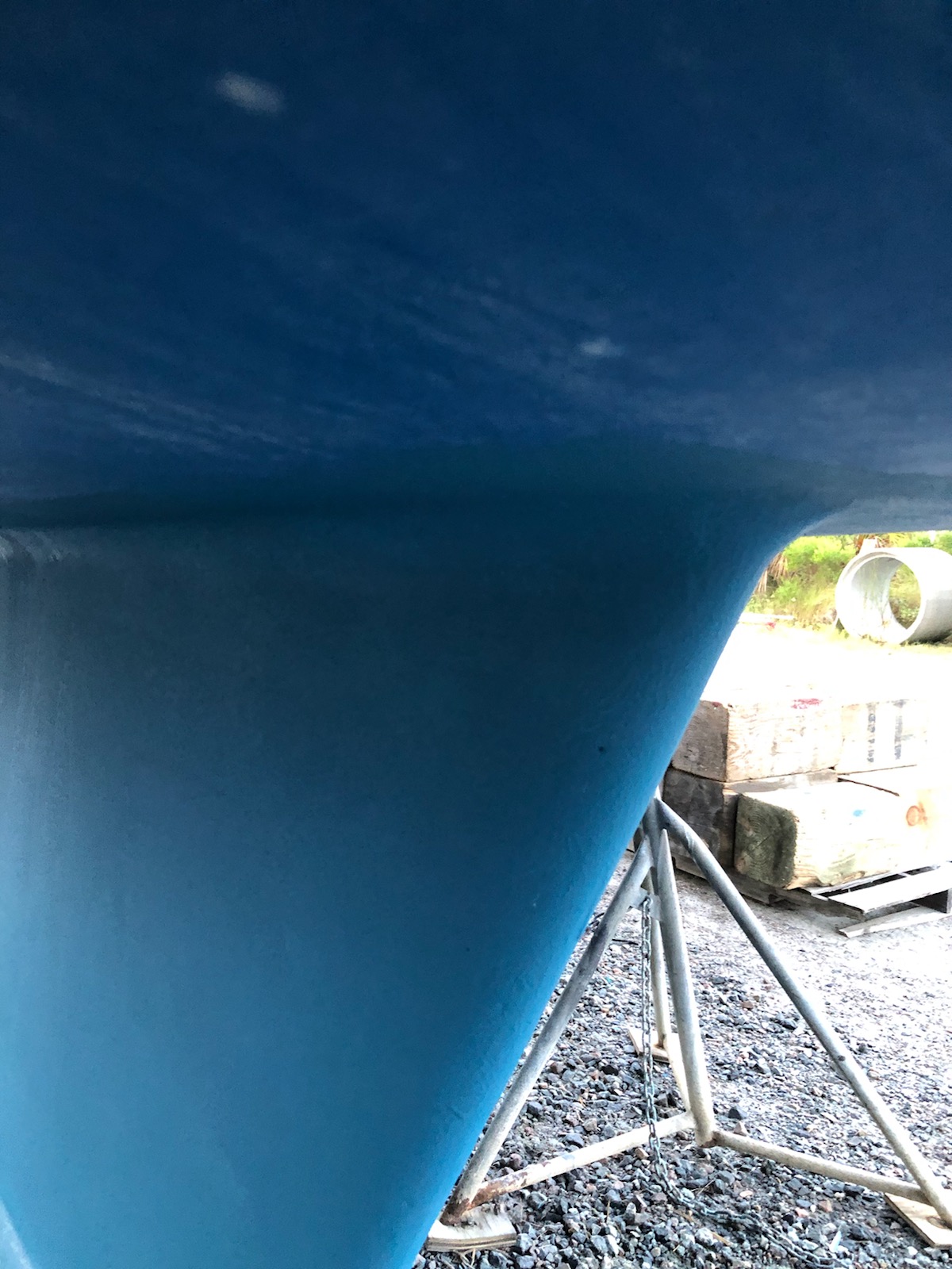

Hi All, I am doing a refit on a 1993 Hunter 30T. I asked the yard check the torque on the keel bolts. They are 3/4" and there are 7 of them. The last 2 they checked, one in the forward bilge area and one in the aft bilge area broke off. Should I have them drop the keel and redo all the bolts or maybe just drill and tap new ones where the two broke?
