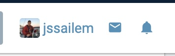

You can reach them right here... Send them a PM (private message)
Use the little envelope in the upper right corner of the page, by your name.
Then just start typing their names in the "Recipients": block. Their address will appear, or a list of names starting with the same letters, automatically. Select their name and the address in the forum will be entered.
Type in your message and they will get back to you through the SBO forum. Very easy and private.
