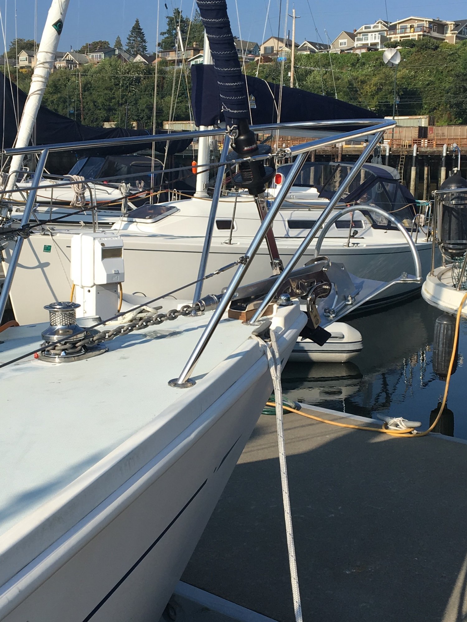

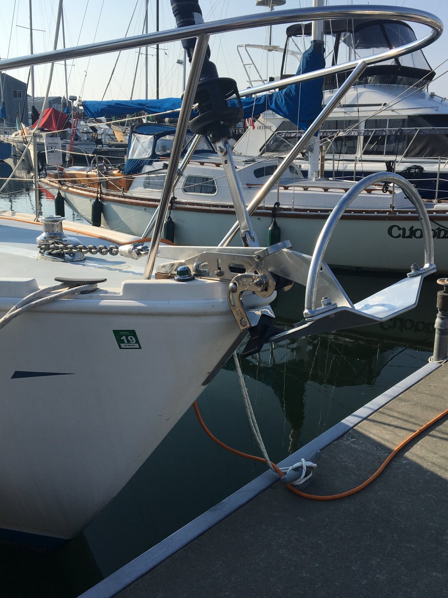

I selected a Mantus for my primary anchor. Selected their bow roller because it came with a fitting positioned below and in front of the roller that grabs the anchor tip when drawn tight and secured.
Here are a couple of images showing the anchor roller, tip guard, anchor, and windlass installation.

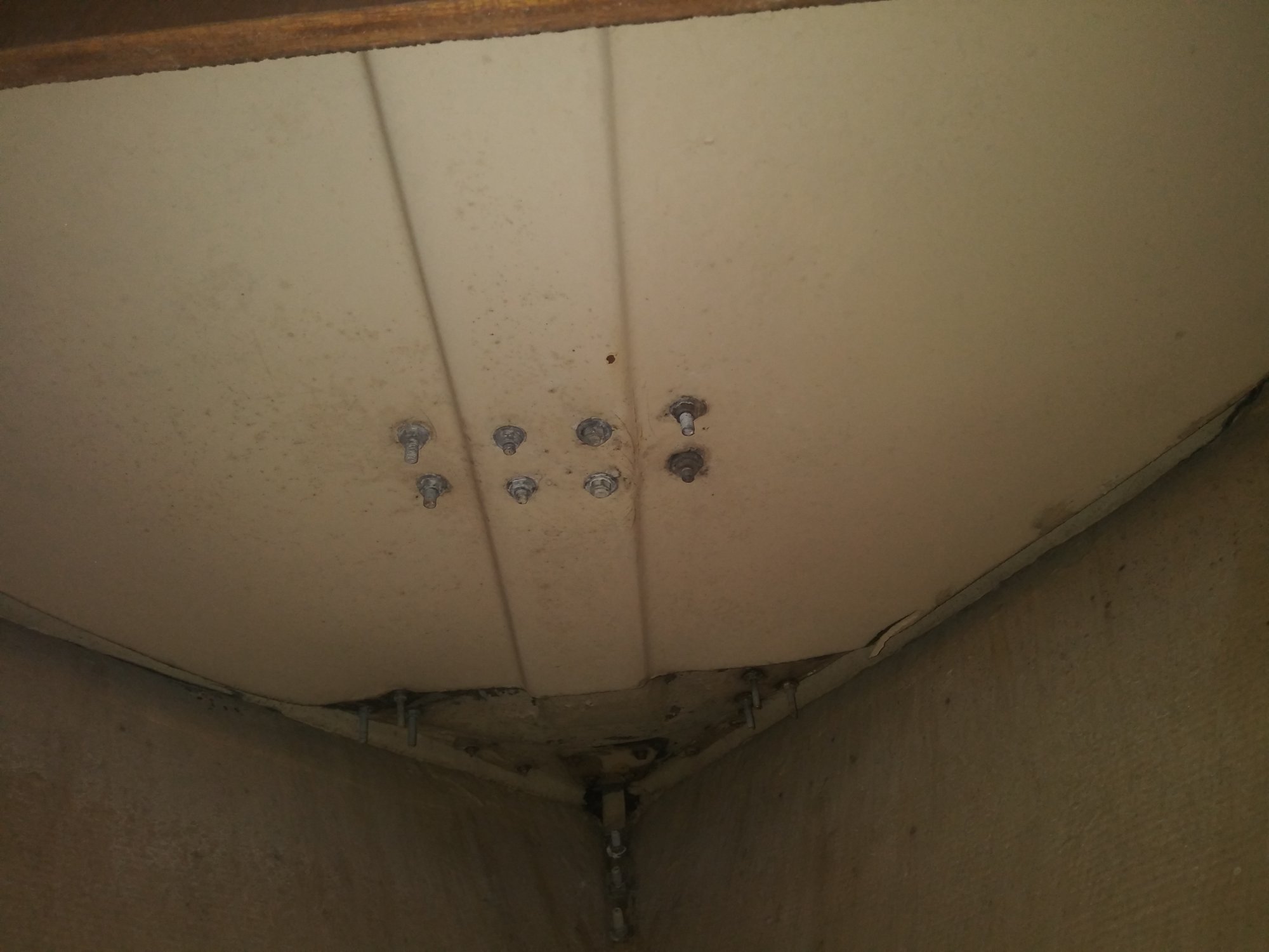

Photos show interior of boat v berth area
Also topsides where the bow roller coyld be installed. Noticed its far back since if it was further forward the weight would
Tilted forward for ilustration purposes and fall. The port rope choke must be removed so tbe bow roller will use that spot.

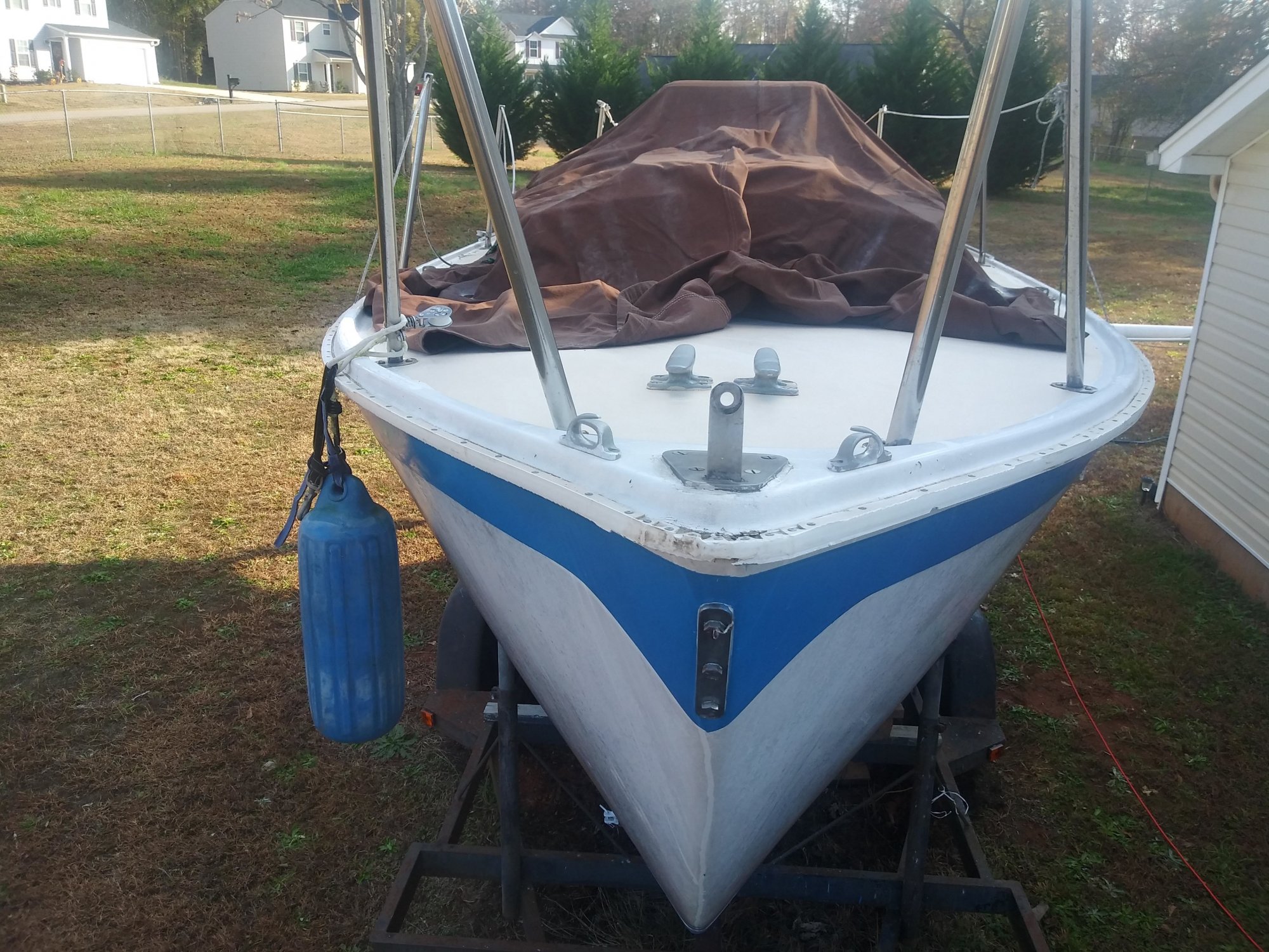

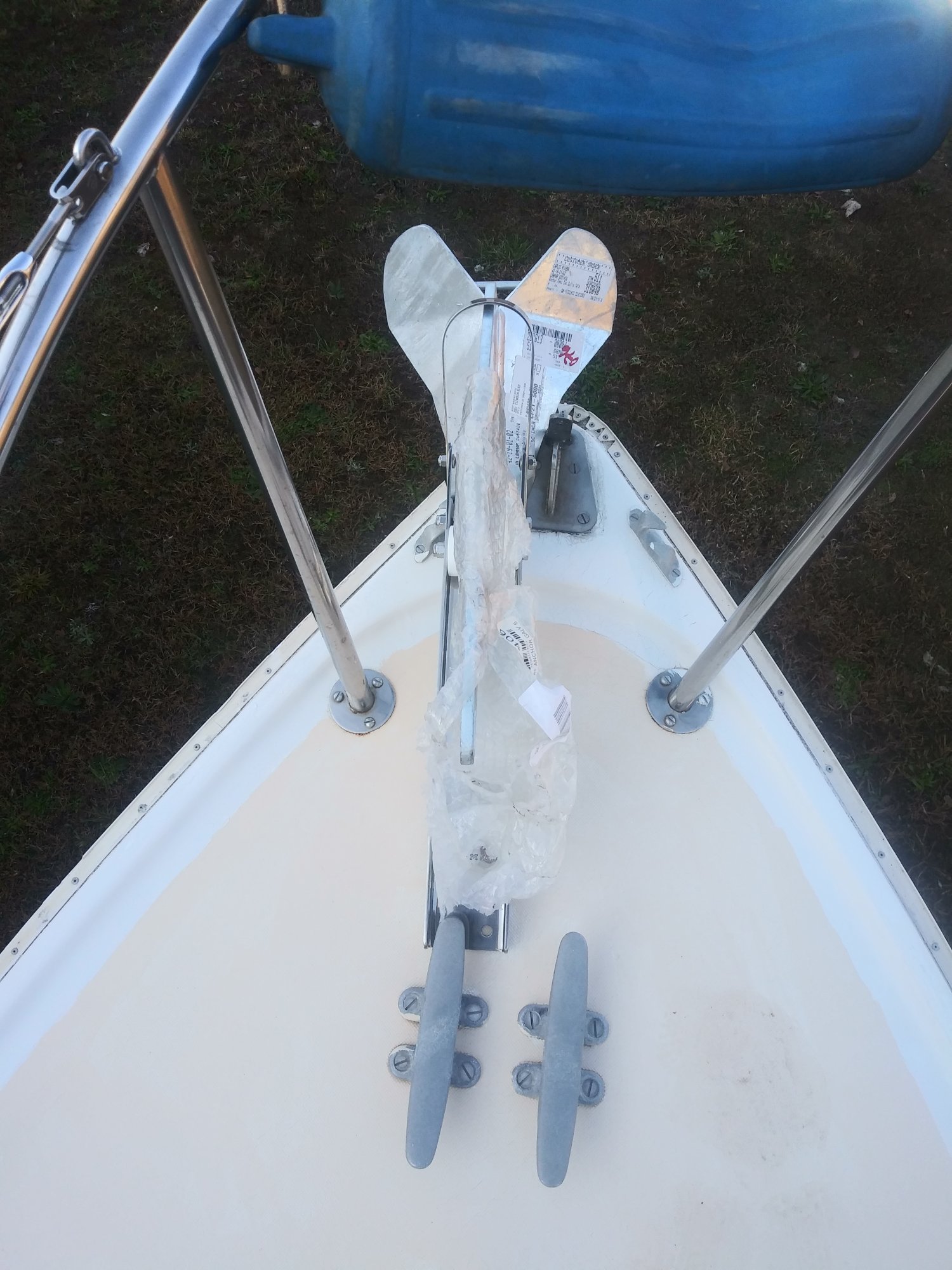

Here are the photos from Carlos's Bristol 24. He would like ideas on installing a Bow Roller to hold his anchor.
Ideas are most appreciated.

If it were me.... I'd establish the height difference between the foredeck and the toe rail. Then come up with a filler. Teak wood, PVC or pressure treated. It looks like the chocks are in play. I might toy with leaving the chock in place and building up enough so a hollowed out area could encompass the chock. Consideration for the furler drum ( clearance) must be regarded. AZEK is a PVC product that also has a generic copy. These could build up the space to allow for a solid mounting surface. Good luck
24,731
I am looking at it in a similar way. You need to locate the roller such that it extends far enough off the bow for the anchor to hang with out striking the bow. This means the roller has to be attached to the deck with something like a block of wood to make the roller lay horizontal to the bow edge. Under the deck needs to have a solid backing plate with bolts secured running up thru the backing plate/deck/deck block/roller. It looks like you have the room in front of the twin cleats but you are going to eliminate one of the bow chocks making one side unusable.
I would make a backing plate for the cleats or at the least get larger fender washers. The small washers curently on the cleat bolts are not satisfactory to hold the cleats on in any type of weather.
