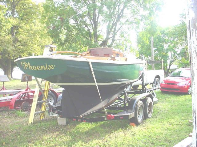

Rich,
I would keep the rudder the same shape as the original. My teak rudder is still in good shap, and I am happy with the way the boat handles. I can usually steer with 2 fingers, and can make tight turns.
You might be able to make a stainless steel rod framework and fill with foam. You could then shape the foam and cover with a skin of fiberglass. You should be able to match the original shape. However; I have seen pictures of 2 different rudder shapes on Corinthians. Mine is squared off, and I have seen a rounded rudder.
I made a trailer for my Corinthian from an old power boat trailer. I made 4 adjustable stands, and a longer tongue with a 7' extension for launching. I have about $400.00 in the trailer, including the $200.00 I paid for the powerboat trailer.
RichS
Sep 29, 2010
10
Bristol 19 Marshfield MA
I agree about the rudder and am thinking of doing as you say. My neighbor has an old powerboat trailer that looks similar to yours and once I get the boat off the existing old rusted trailer I will use that to fabricate one similar to yours. Thanks for the picture she looks fantastic. Happy New Year!
