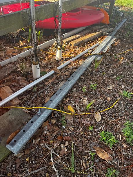

Significant backing plates on the stern cleats and a spreader bar across the "V" that lifts the boat. Lifting wires that are not vertical multiply the force on the attachment point. A spreader bar keeps the boat from getting squeezed.
Are both the bridles going to a single point on the hoist or is there a bar longitudinally?
Jun 2, 2004
3,676
To a single point.
A lifting bar may make sense for y'alls operation.
I'll post a picture of the one I had made. It is for lifting our coach boats and are much heavier than your boat but gives you an idea.
A spreader bar does not have to be anything more complicated than a 4X4 with a couple of eye bolts at the same distance apart as your cleats or chainplates.

Ok, so a spreader bar makes sense to spread the load between the chainplates. Do you do anything from the front to rear? Pics of your setup would be helpful, thanks!

So that runs bow to stern with two more going across the boat to attach where the shrouds meet the deck and the other attached to the two stern cleats?
Jun 2, 2004
3,676
Yes, exactly
I was looking at pictures of the 216 and was wondering if instead of lifting from the stern cleats using the motor mount bolts to attach a lifting point maybe an easier option. Removing a bolt on each side and replacing them with lifting eyes or adding a plate that has a lifting point. Lots of options but hard to make a steadfast recommendation without being able to put your hand on the boat. That fixture was intended for forces in the horizontal plane whereas the cleats were in the horizontal.
