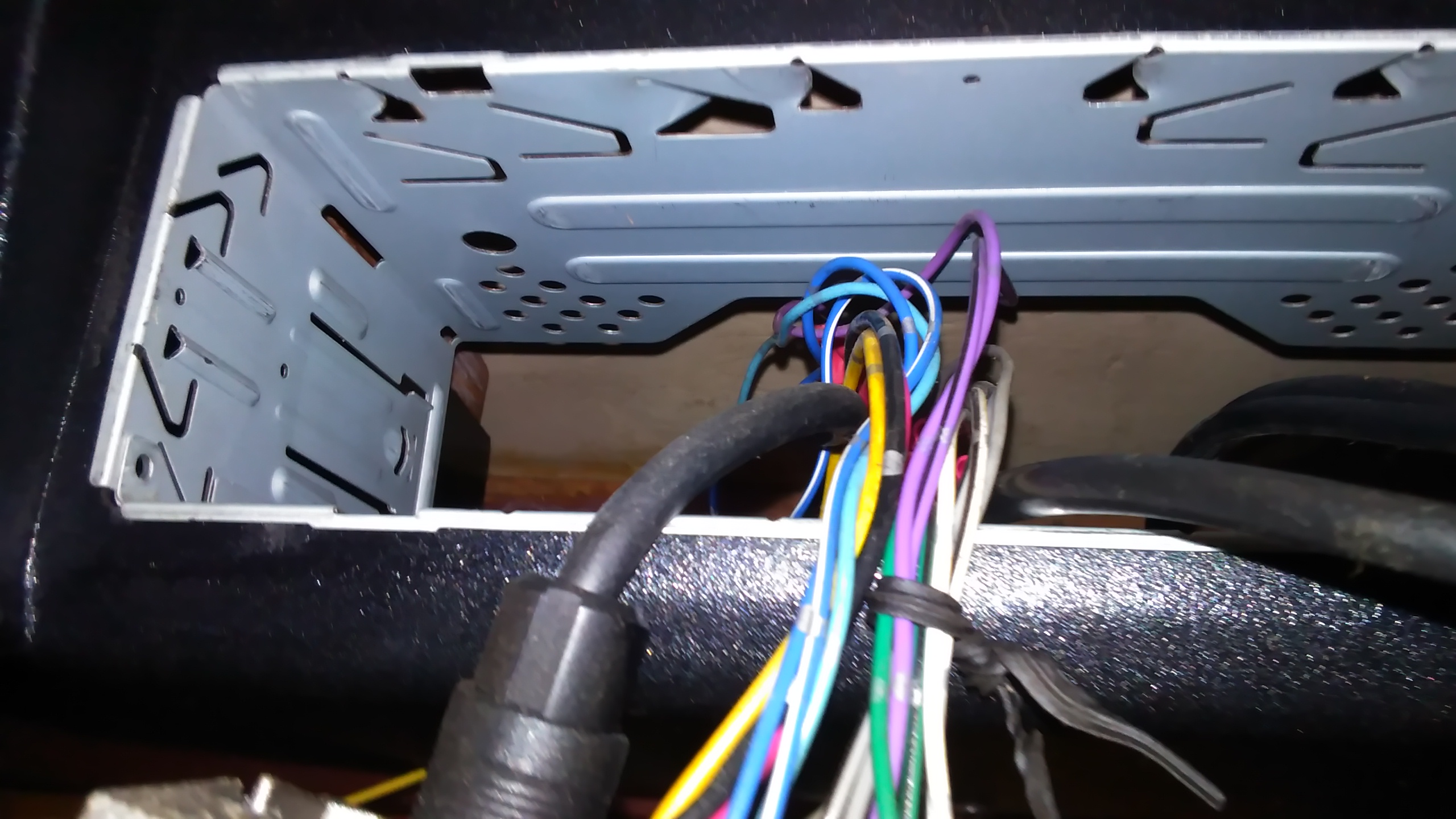

Our boat has a teak box on the Port side for the stereo. Problem with it was that it was made back in the "day" and would only accept stereos with a tuning and volume knob. We had to buy a small jig saw and hand cut the face to accept the above pictured new style sleeve for a modern radio.
