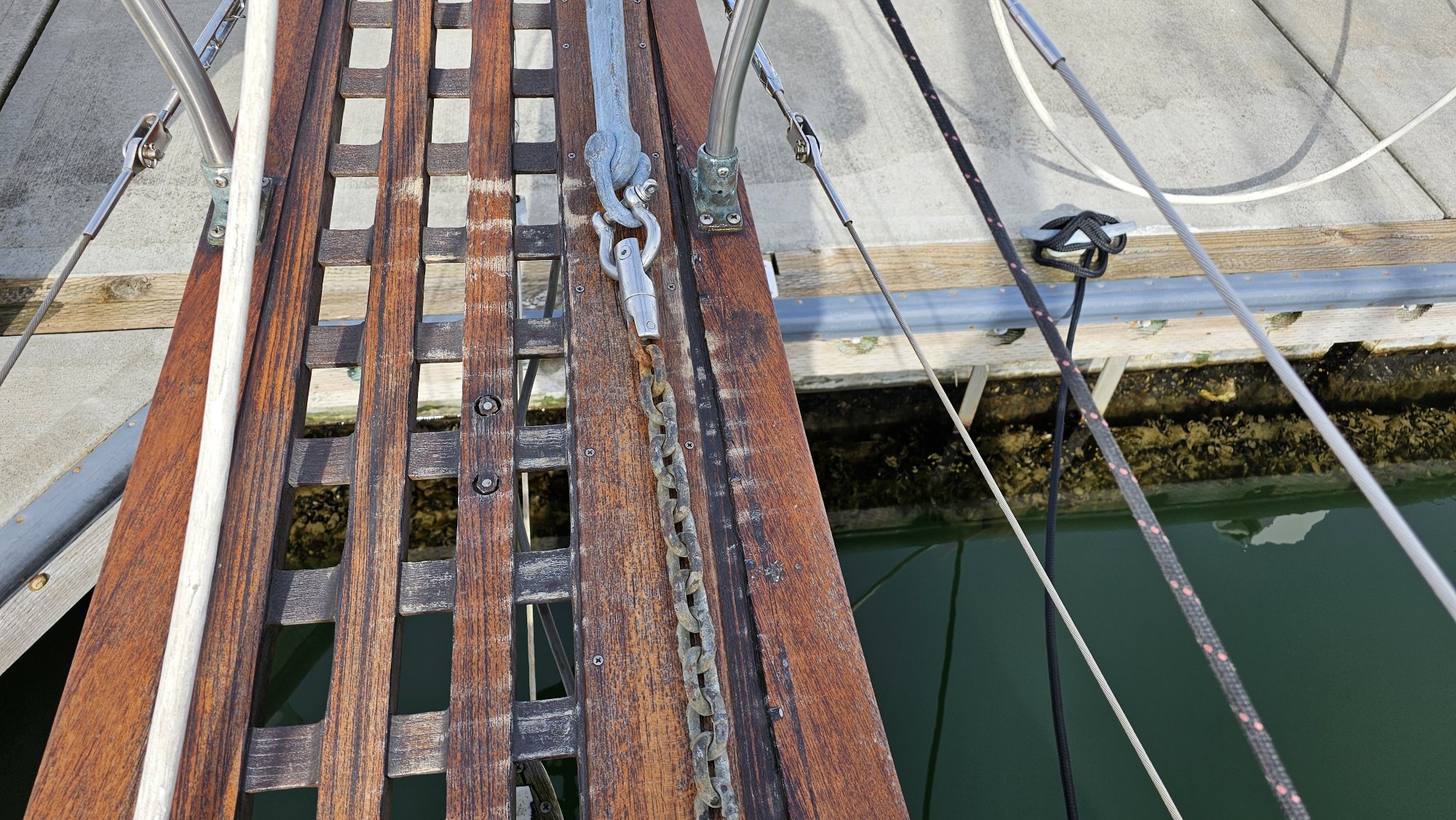

We had a rough day, recently, and found out several hours into it that our chain was loose. (The windlass switch is right by where I sit when backing out of the slip, so I have accidentally let out the chain more than once. Going to move the switch, but that isn't the point.)
When we bought this boat (less than a year ago), the bowsprit was pretty weathered. Having put some work into cleaning it up, a little bit of wear shows up a lot more readily.
Ignoring the fact that the last link or two might need to go ...
Has anyone employed a solution to this wear problem that they are happy with? I mean, having the chain tensioned certainly helps, but I don't like to keep it too tight. It is possible/easy to tension it so that it pulls the bowsprit out of alignment.
My instinct is to put some sort of pad down, but I would like to preserve the aesthetic as much as possible. I just learned that some people put a section of tubular webbing over the last few feet. That's OK ... ish. It would probably need replacement each season and it complicates chain inspection. But, maybe I can live with that.
Anyone else come up with the perfect solution?
Note that I would not expect normal wear to extend as far to port as it does in this photo. This was an exceptional case where the chain was quite loose and seas were quite rough, and this went unnoticed for hours.

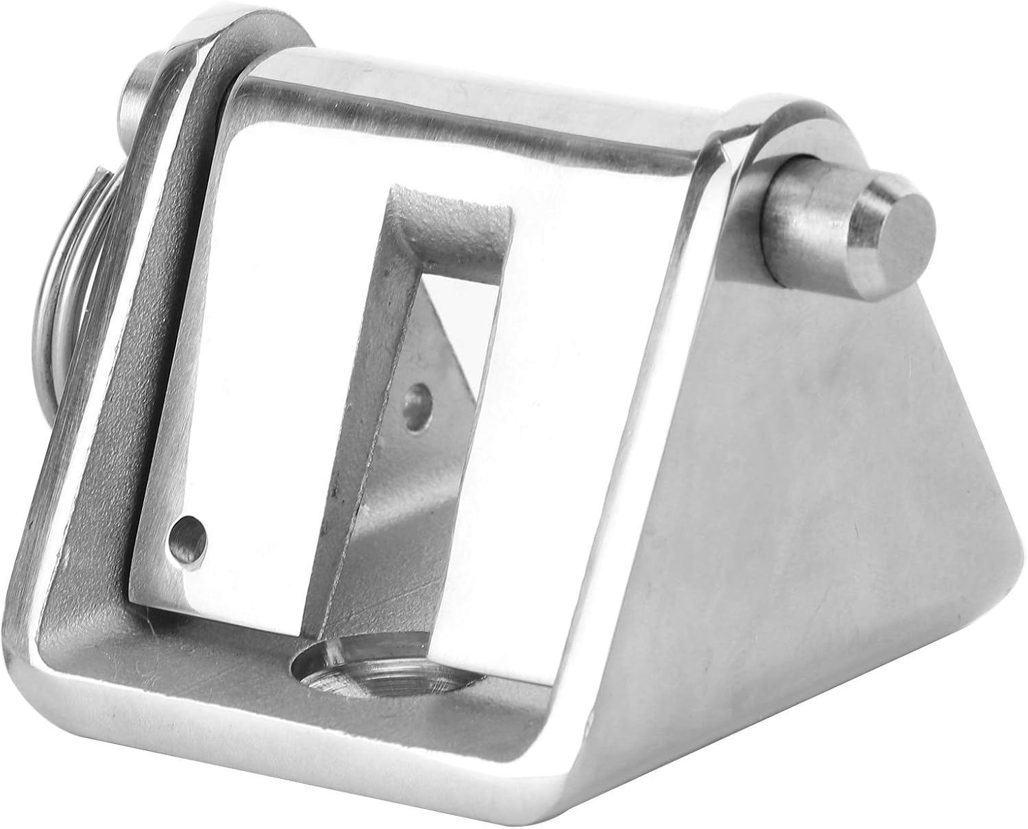

The windlass should not be used to tension the anchor chain. There should be a chain stopper to secure the chain at all times so that the load is not on the windlass. In addition to the chain stopper use a second line to secure the chain in the event the chain stopper should fail.
With a chain stopper between the anchor and the windlass, the windlass will not be able to lower the anchor without releasing the stopper. That will end the problem of the anchor coming off the bow sprit.

I have heard owners utilize a piece of HDPE (Starboard) as a pad for the chain. I have a similar problem on my foredeck, where the chain runs between the windlass and the bow roller. I am looking to secure a stainless plate to serve as a pad.

I would love a chain stopper but I have a difficult bow sprit setup where no commercially available unit will work. At least not without a lot of structural work.
I tie the chain off with line to a bow cleat. It would be nice to have a back up system but it's what I've got. It's worked well to date.
I had similar thoughts. Also considered just a sacrificial piece of wood that I could replace from time to time.

As to the abrasion, I think I am going to try the webbing approach. We don't anchor for very long at a stretch, as a rule. Something like that might be just fine.

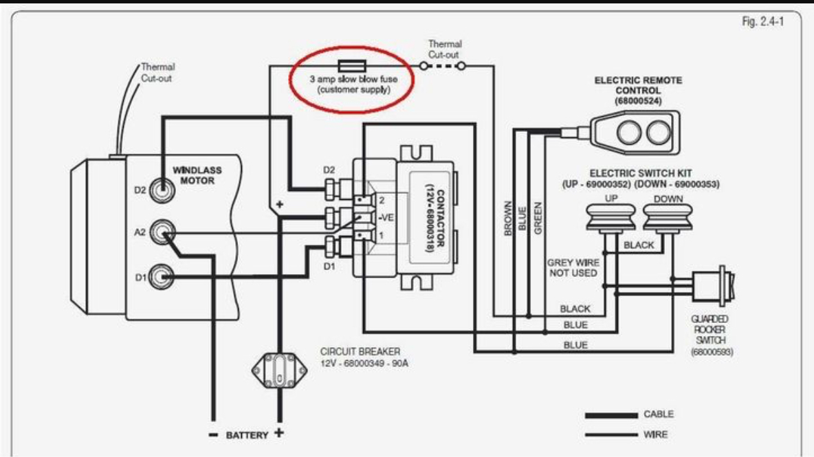

Here is a simple diagram of a windlass circuit. The solenoid is sometimes referred to as a contactor.
Apr 25, 2024
828
Thanks! Yeah, that whole circuit is a bit of a mystery to me. Not that the circuit design is confusing, but because I haven't figured out physically where it is on the boat.

I don't see any way of protecting wood that a chain and anchor regularly runs over, other than applying something sacrificial on it. We used this on a fiberglass beam on our previous boat: Amazon.com
