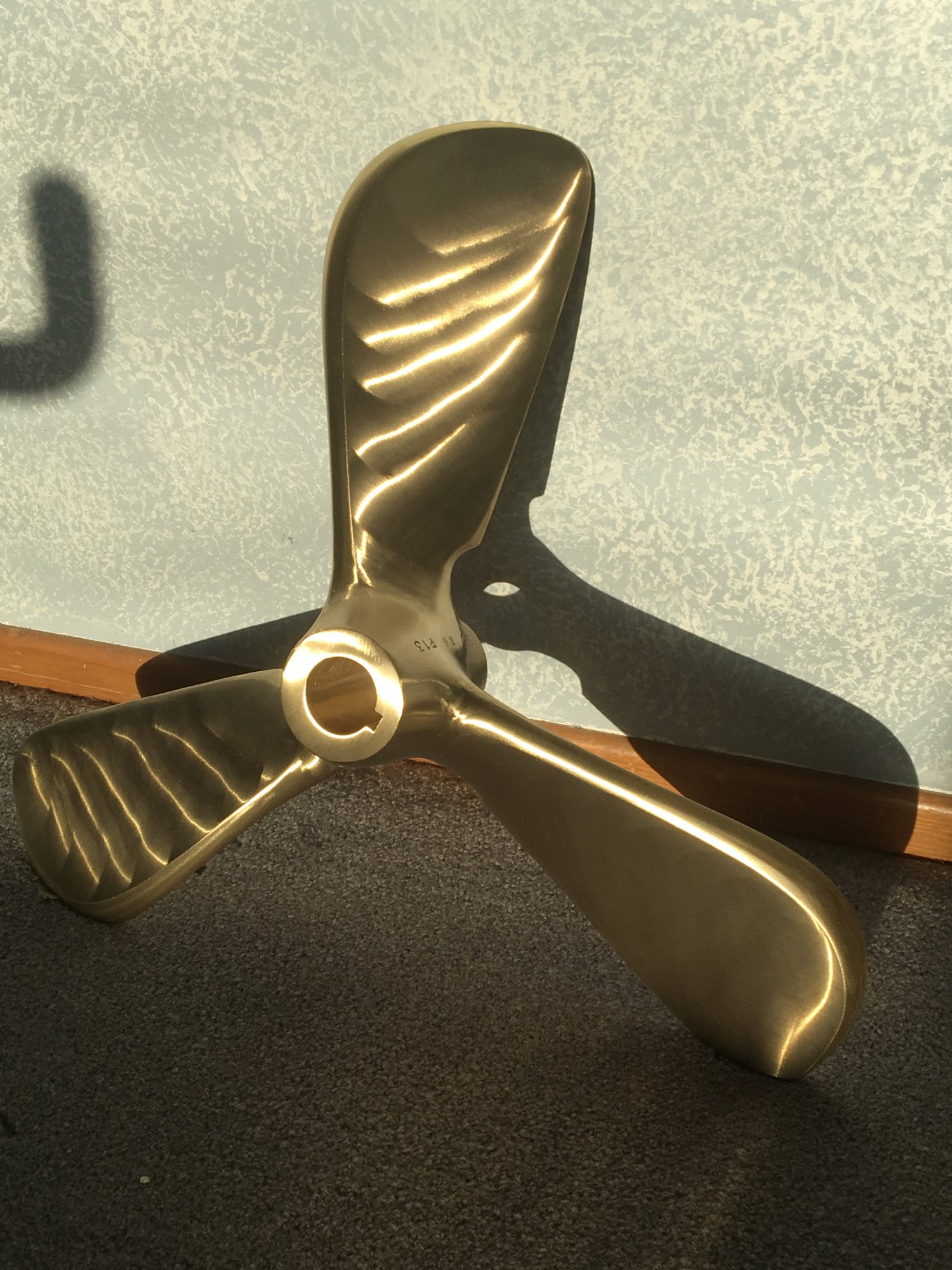

  1. You might check your prop. You got a great deal for the boat so there is no way of knowing it the previous owner has the best prop for your boat. I had a squatting problem when I powered up to hull speed. This is the prop that was on the boat when I bought it.
    I changed to a prop called a CampbellSailor. Made by WestbyNorth.com
    Here is what the new prop looks like.
    It generates more straight thrust with negligible squat. At cruising power I gained a full knot. An improved prop may also help you.
