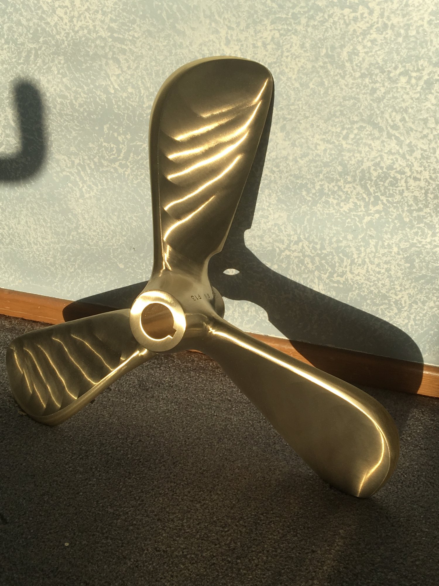

We get a lot of squat under power and the bow seems light.
Two thoughts for you.
  1. You might check your prop. You got a great deal for the boat so there is no way of knowing it the previous owner has the best prop for your boat. I had a squatting problem when I powered up to hull speed. This is the prop that was on the boat when I bought it.
    I changed to a prop called a CampbellSailor. Made by WestbyNorth.com
    Here is what the new prop looks like.
    It generates more straight thrust with negligible squat. At cruising power I gained a full knot. An improved prop may also help you.

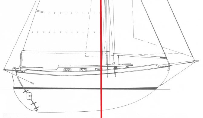

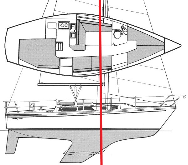

I have a hard time understanding how the bow can move across so fast
The Catalina 30 Fin Keel and aprox pivot point (red line)...
Your undercarriage really has very little at the bow to stop the bow from being pushed over.
Compare it to a Westsail 32 with Full keel..
YOu can turn a tight circle because of your fin keel. The west sail can not. Your sports car like nimbleness means you will be more squirreley when the wind is pushing boats around. The west sail will be more affected by currents than the Cat 30.
You sail faster and turn quicker, the West sail sails a straight line with out really trying.
Good analogy, That makes sense. Now to learn to handle squirreley.
