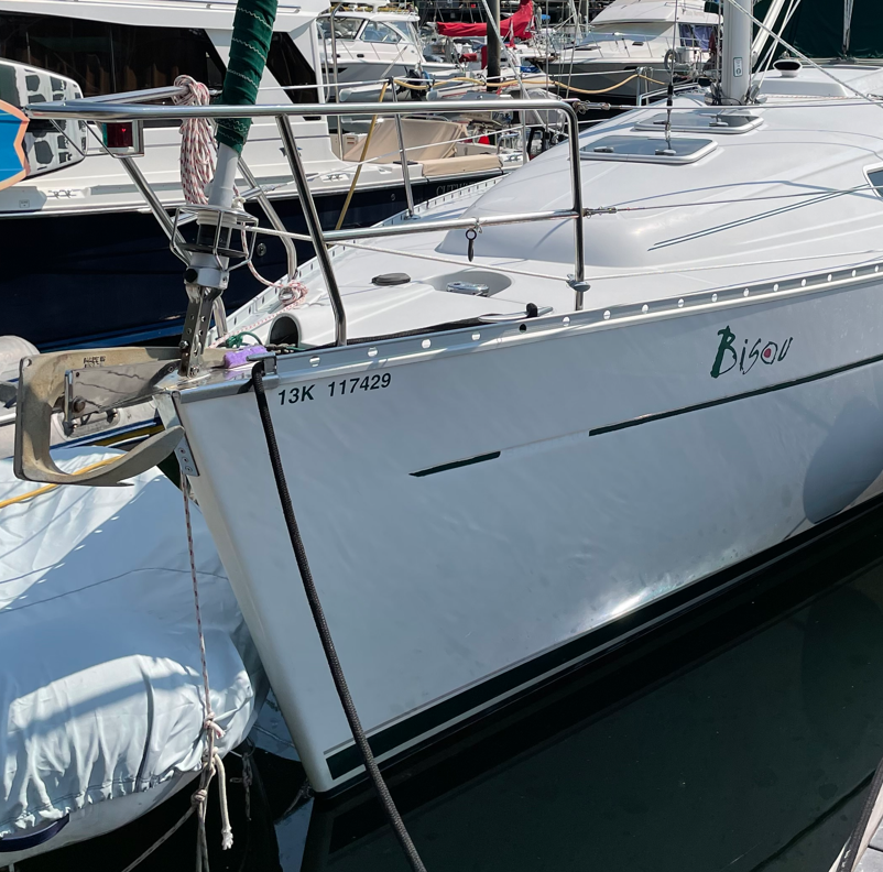

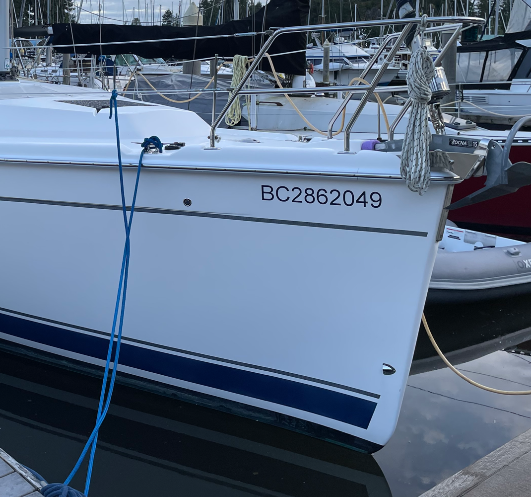

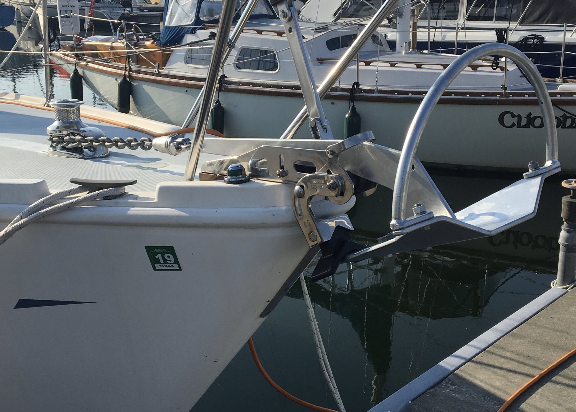

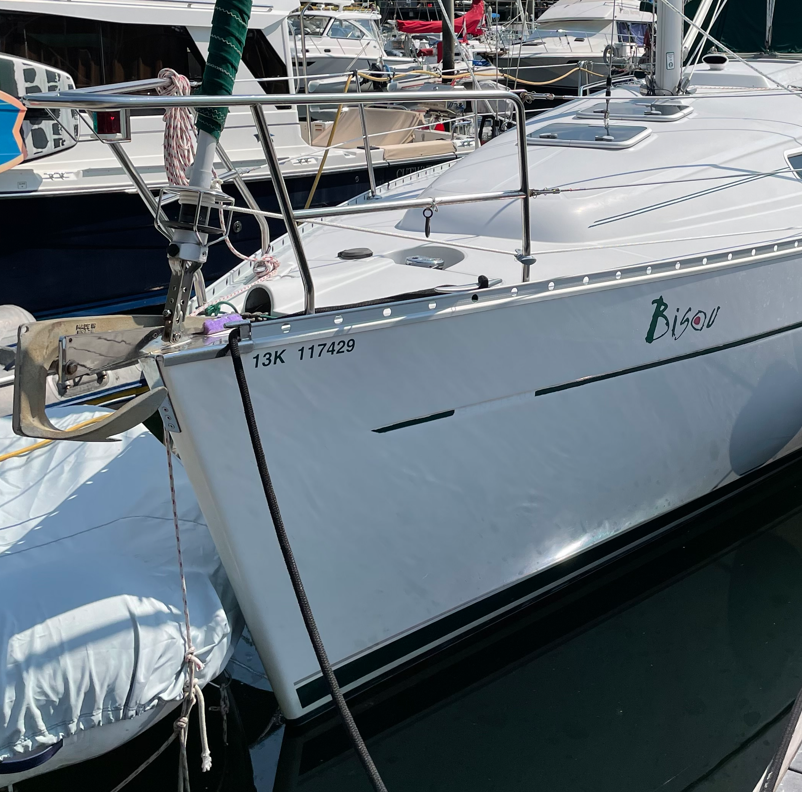

Attached is the best picture I have right now. There are two pictures, one named 331 is our previous boat a Beneteau 331. It had a fairlead at the front of the toe rail which worked well. The one named H36 is our current boat.

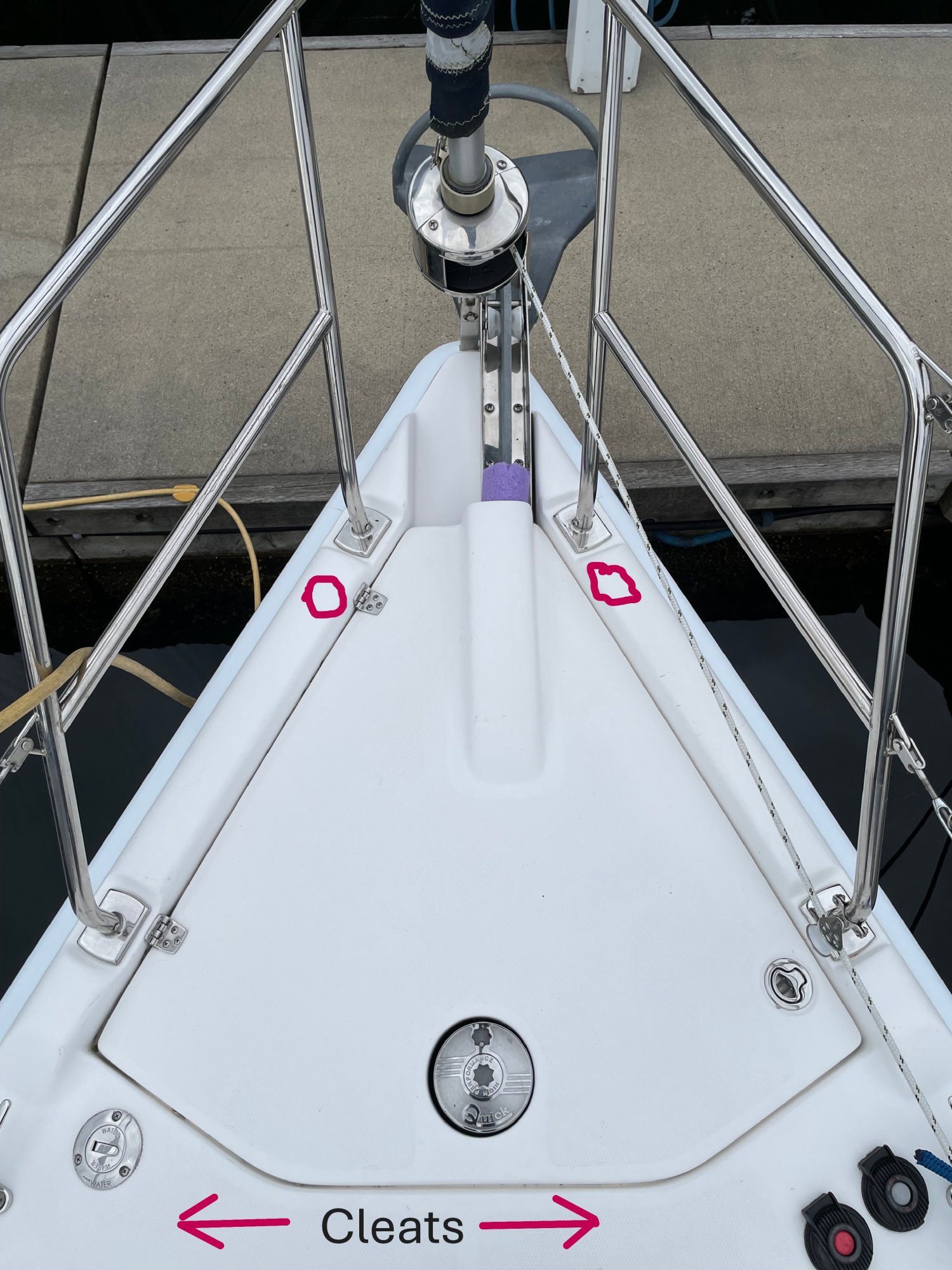

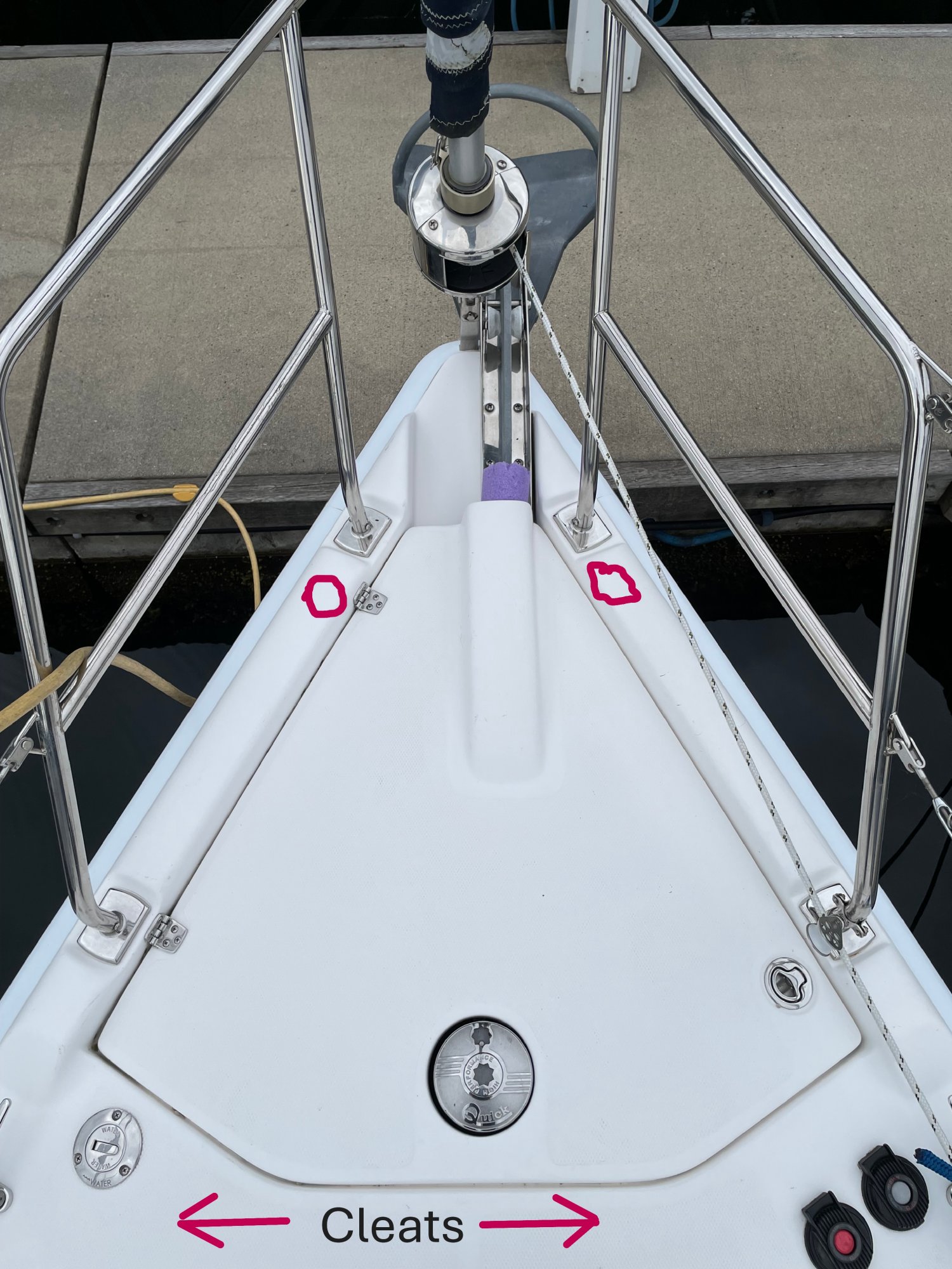

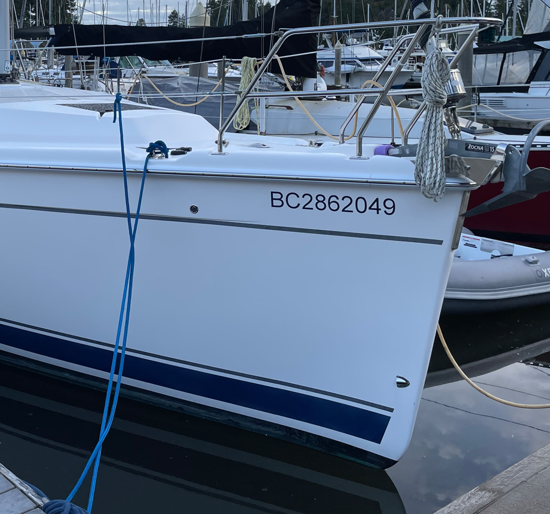

Adding some pictures to see if there are any further comments to my original post. On pic 1 I have marked red circles where I was thinking of putting the fairleads. I didn't capture the existing cleats in the picture so marked location in red. The cleats are visible in pic 2.

While I don't have a Hunter, my bowcleats are set back from the bow (not as far as yours) and I have fairleads set back about 6 inches from the bow. I don't have the same interference issue from the pulpit as your boat.
Likes: PNWE36

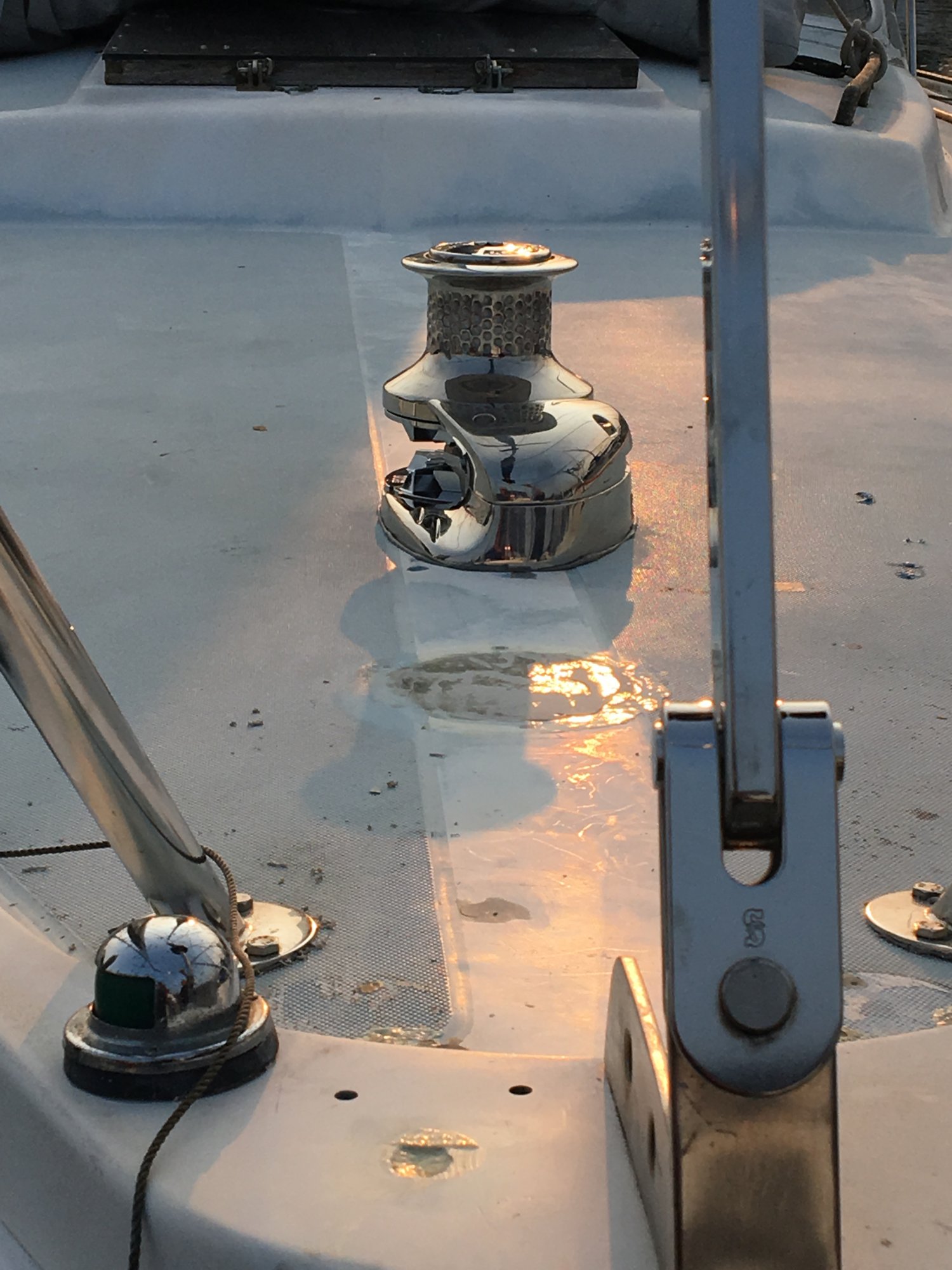

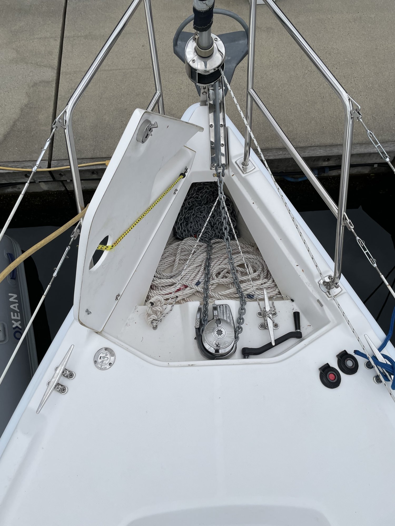

Here you can see the location of my bow cleats.
They appear a bit further aft than yours and I believe they are spread a couple of inches wider. Not a big deal
I left the cleat in their place and positioned my windlass behind the vent that was there.
This allows me to attach a snubber to the anchor chain and then let it out over the bow roller that I installed.
The boat will hint at anchor if I just let it go. So I set the rudder to one side and if needed set an anchor sail from the boom end. We sit at rest.
Likes: PNWE36
