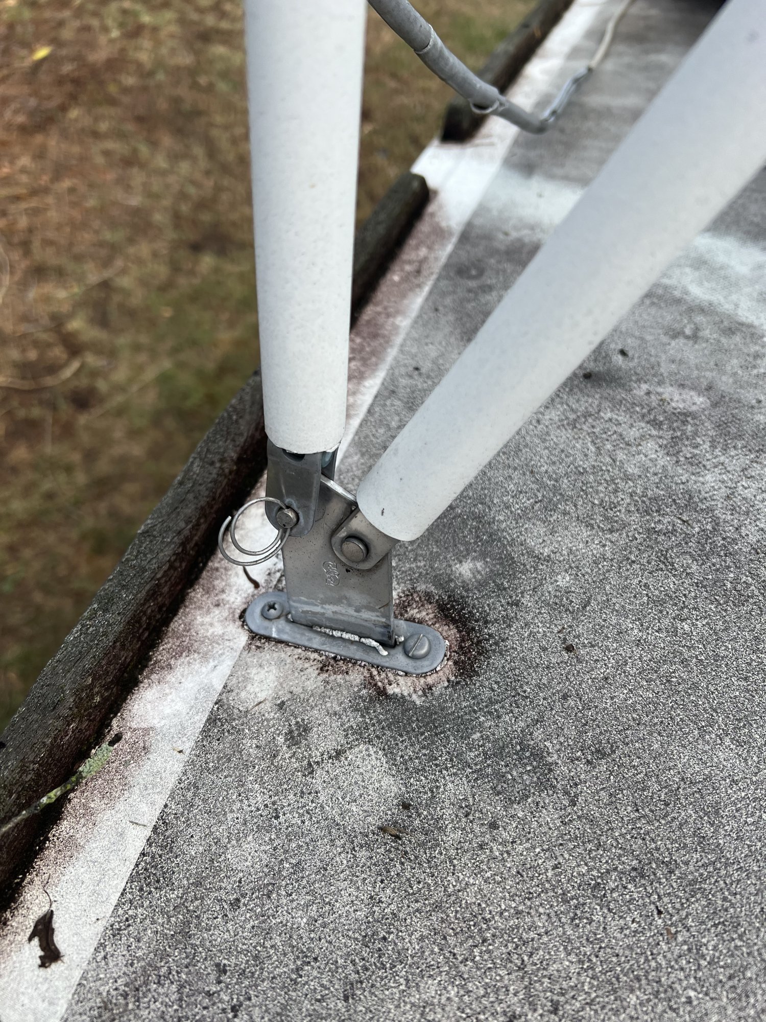

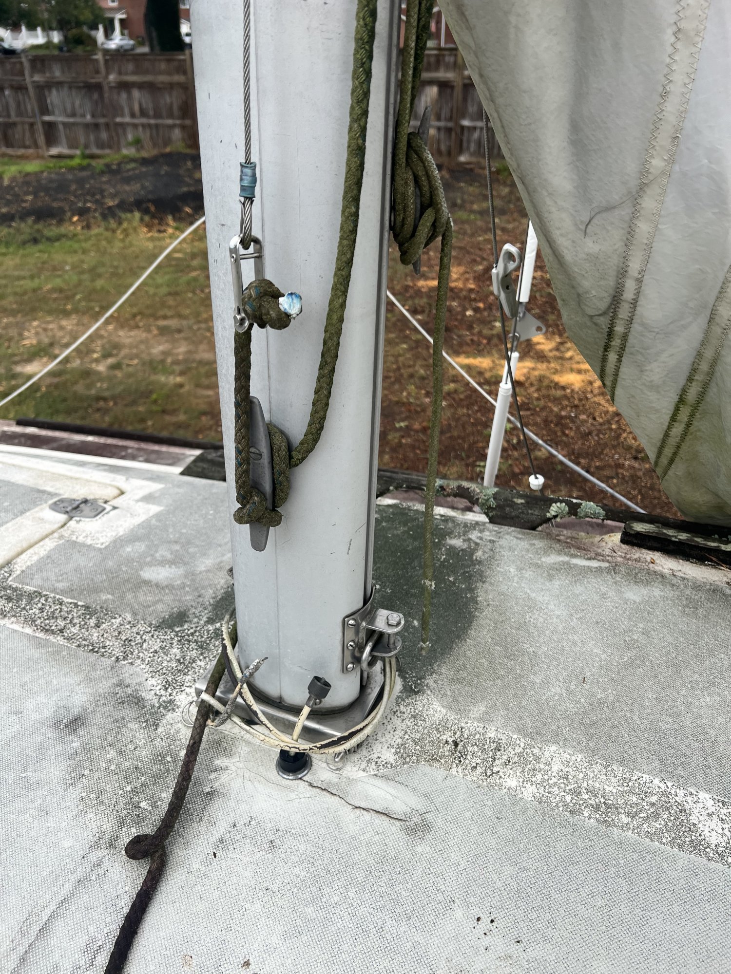

I'm new to the forum, and the boat. I bought it sight unseen and went out and took a look yesterday. The cabin needs some serious TLC, but overall I'm pretty pleased with the shape she is in, all things considered.
My primary concern right now is what appears to be some cracking around where the mast attaches to the deck (see picture). My question is how concerned should I be, and how do I determine if this is a crack/spidering is structural or just cosmetic? When walking on the deck around the mast, it was very firm and hard, so that makes me feel a bit more comfortable.

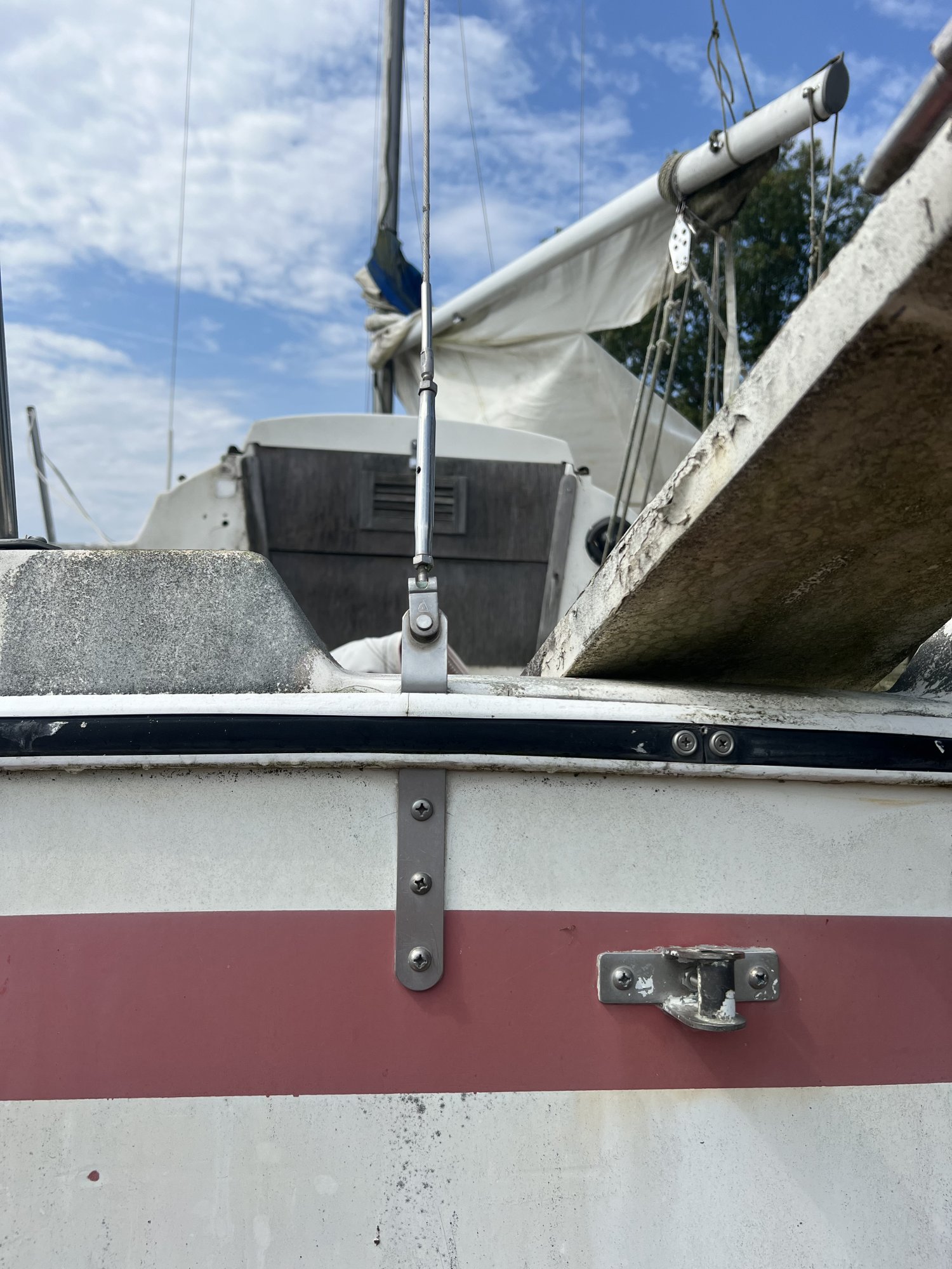

As some background, the boat was abandoned at the marina. The mast has been up for at least three years. I inspected the stays, and the connection points on all four sides and they seem to be strong (see a few more pictures).
Any thoughts or input would be appreciate! I'm really excited to get started cleaning her up and in a perfect world might be able to get her in the water next summer!
8,111

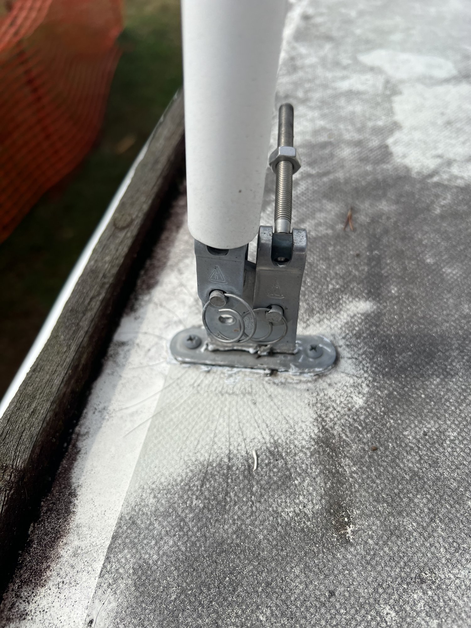

The crack at the mast doesn't look like a spider crack. It looks like it involves the underlying laminate. The crack there can foretell rot of the support for the compression post if one exists. Or that the deck structure needs to be strengthened.
The cracks around the port chainplate could be described as spider cracks but thy are still a concern to me because of the position - around the chainplate - and because they radiate out from the chain plate.
To further investigate you could test for wet core. Maybe with a moisture meter or with test holes. Also sounding may be useful.
Both areas are under stress and are important structurally.

You don't say what year the boat is but it's 40 years old or more. It will definitely have some wet decks around the mast and chain plates.
I agree with @shemandr, the crack running from the wire gland looks to be a bit brownish, an indication of rotted core.
Pour a glass of water around the base of the mast. Does it pool like it's a bird bath? If not, you're OK until it does, unless you want to tackle repairing wet decks now rather than later.
Look inside at the bulkheads near the chain plates. Are there water stains on the bulkheads? if yes, is the wood rotted or soft? If so they definitely need to be repaired or replaced. Look at the bottom of the compression post, the 2x4 on the bulkhead under the mast? Does it show signs of rot top or bottom? If not that should be good. If it does it should go on the list for future repairs.

This fall marks 19 years with our Oday 25 . I second the suggestion about the bulkheads . Check where the chainplate attaches . Is it rotten ?
I replaced ours because the through holes were elongated.They were never wet .I've been convinced that in and of itself is highly unusual.
However the bottom of the compression post was rotten . This was due to leaks and standing water . When I installed the replacement
compression post the bottom 4 inches were saturated with epoxy and fiberglass .
