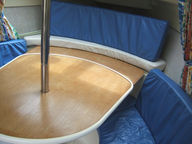

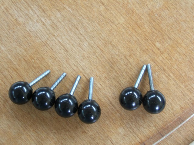

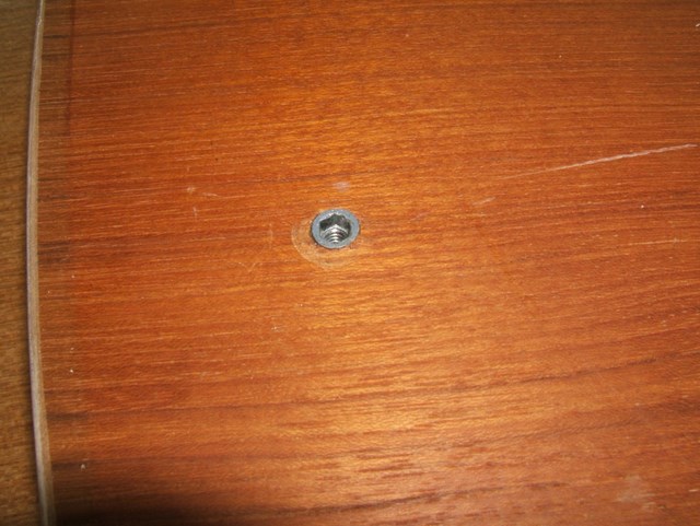

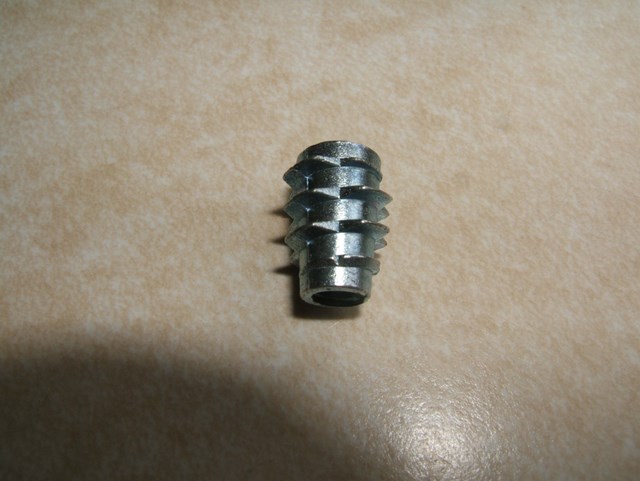

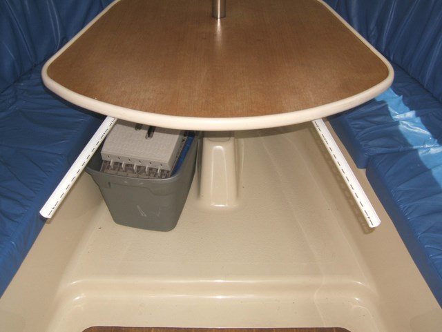

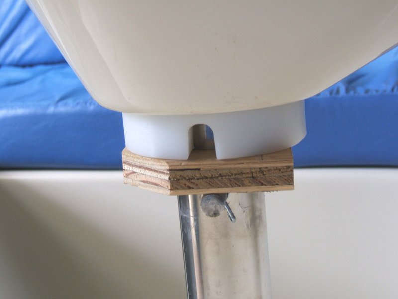

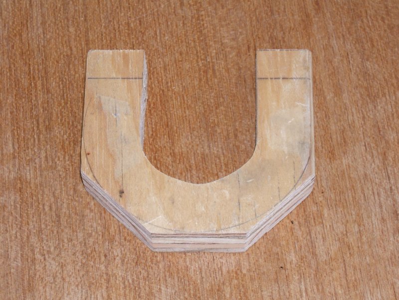

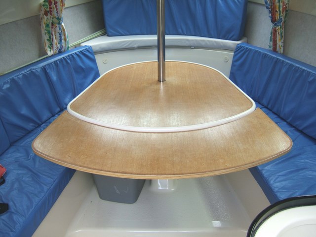

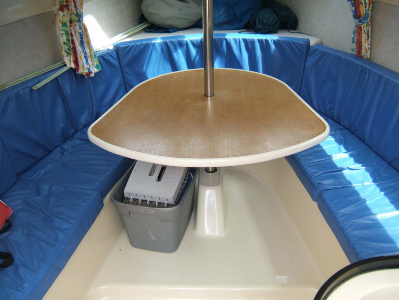

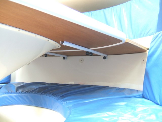

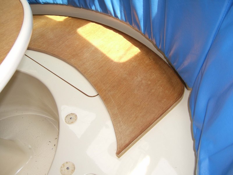

Willemvan, about that huge table...
Here's what I did. Many have cut down the table. But if you still want to use it spun around for the v-berth than this is what I did. The white brackets (HomeDepot shelf bracket uprights) stay attached to the table at the pivot screw. The cut-off piece stays under the v-berth cushion and is attached as needed. The plywood "U" is put under the table base to lift it up just a bit. Use a router to recut the slot in the new table front, cut down the white plastic piece and re-insert. It takes about 3 minutes to add or remove the cut off piece as needed. Our son is 6' 2" and needs the room.
