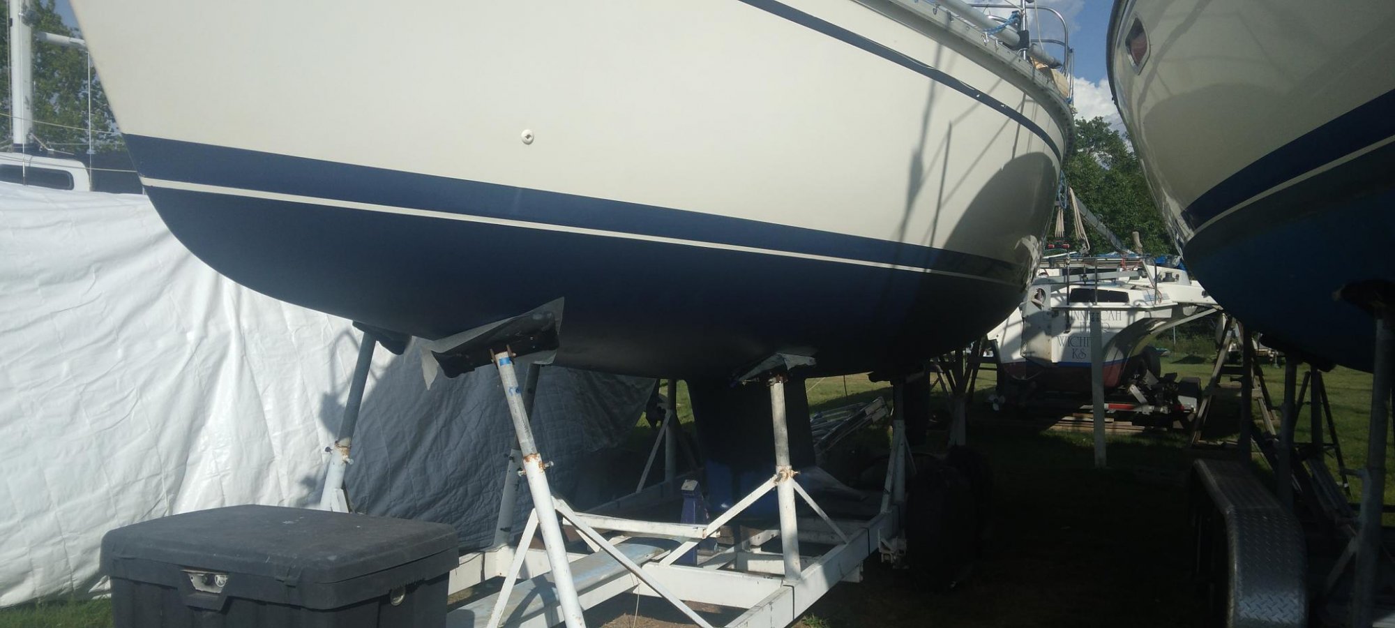

Final word on my project. The prep and application went well, but I have to say I'm disappointed in the appearance of this new Pettit Odyssey HD paint. We're in a drought so I have not had a chance to put Bella in the water this year. But just sitting on the trailer, rain runoff has streaked the nice dark blue paint for which I chose it for, to lighter blue streaks and patches everywhere. I Googled this and came to learn too late that this is an issue with this paint. I contacted Pettit. They responded a couple times and then it looks like they ghosted me.
I hope it at least performs well once the lake comes up. It sure doesn't look like it's supposed to. I can't recommend it.

Justin, I wouldn’t sweat the streaking of the ablative paint after rainfall. I have had that happen a few times, over the years, using different manufacturers’ ablative paints. Once you’re back in the water, it will all blend together & look normal. Petit products are top of the line, the performance should be good.

Same experience on my paint of 5 years. About 85% lasted till I removed it. It did a great job.

No worries, Justin. Rain streaks on fresh bottom paint are normal and disappear quickly when boat goes in the water. It happens with both ablative paints and the VC-17 I use now. It also happens in the spring when I clean the hull in the boat yard. Doesn’t even have to be fresh bottom paint.
