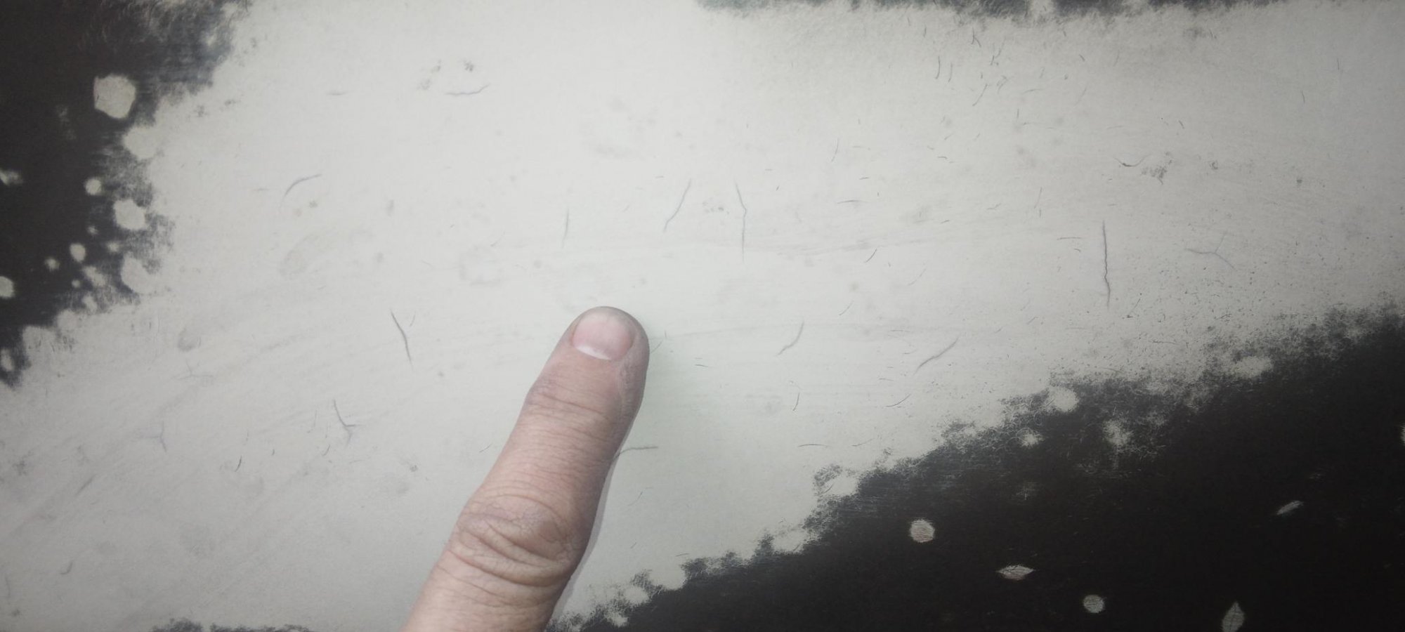

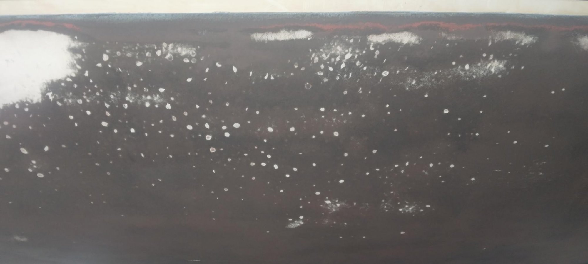

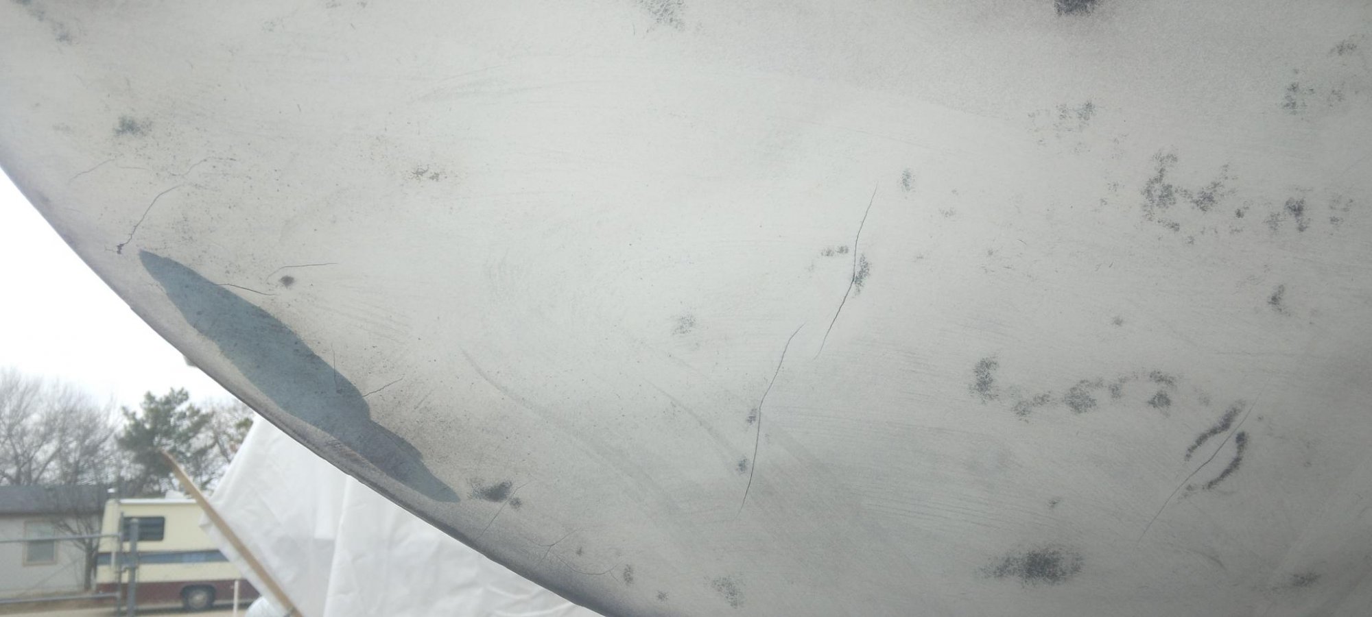

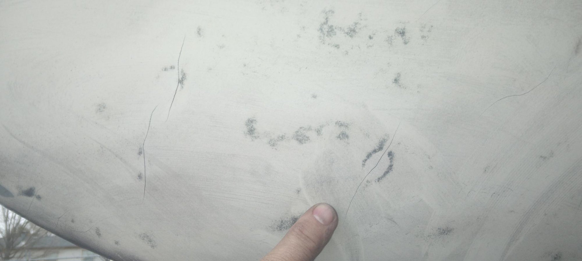

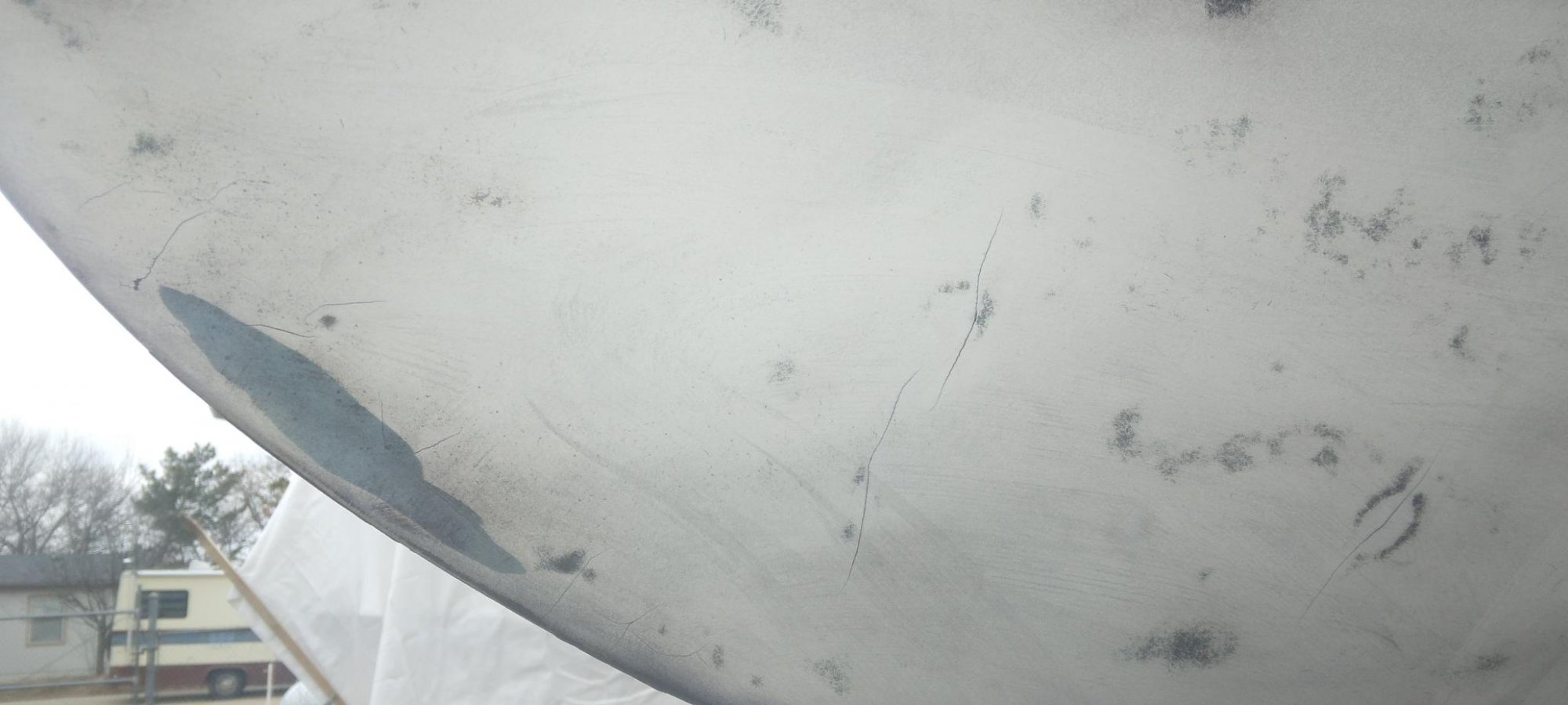

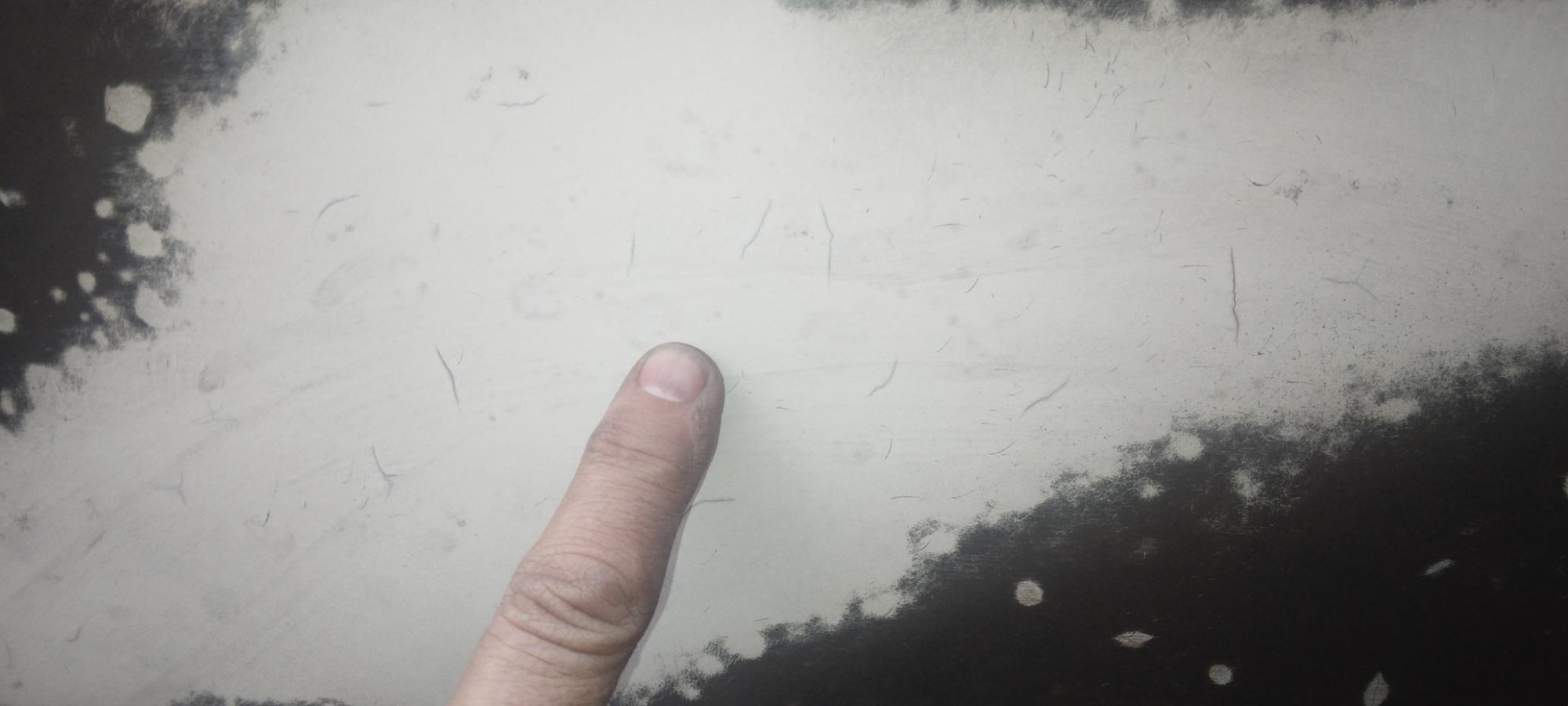

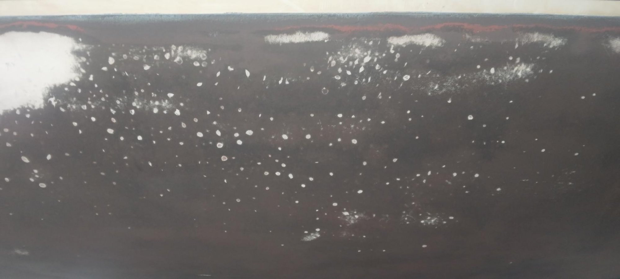

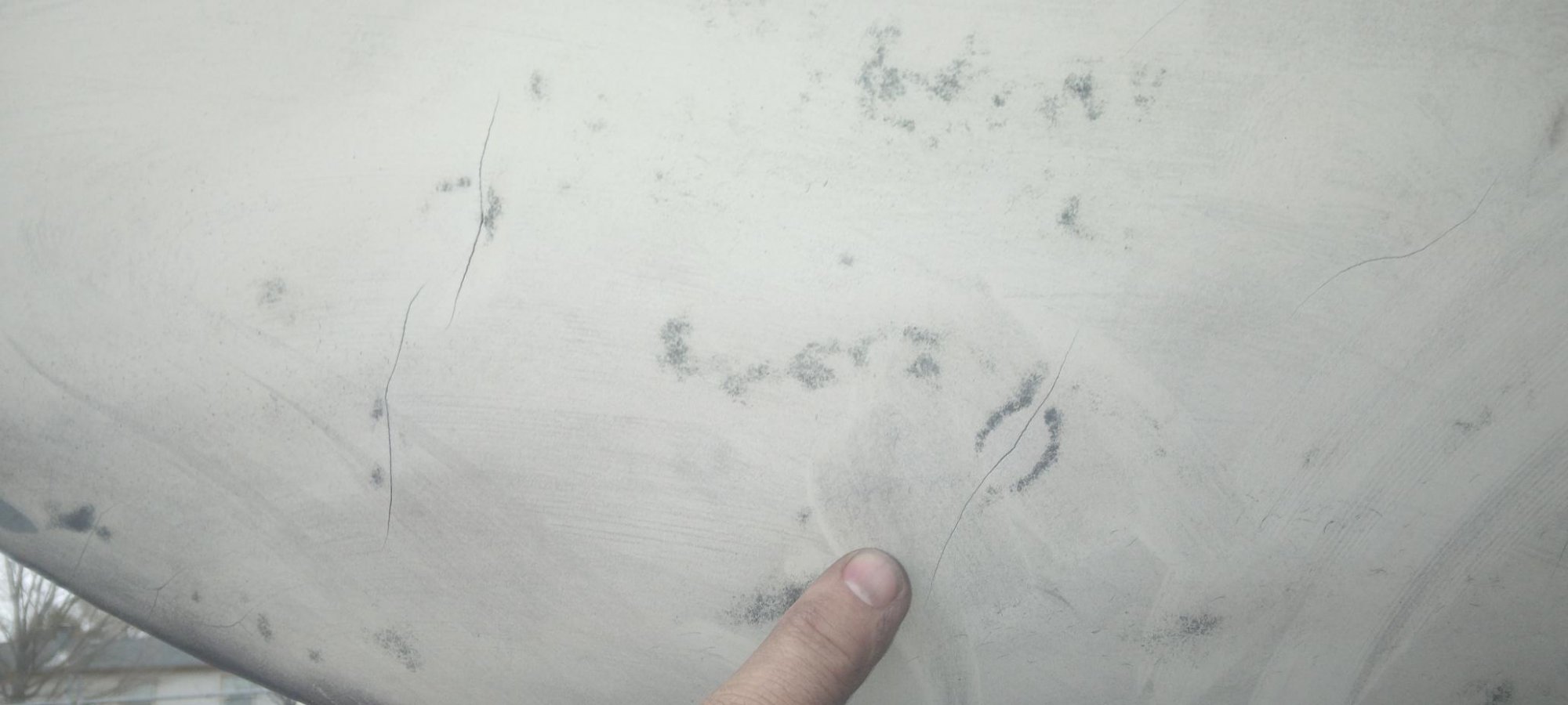

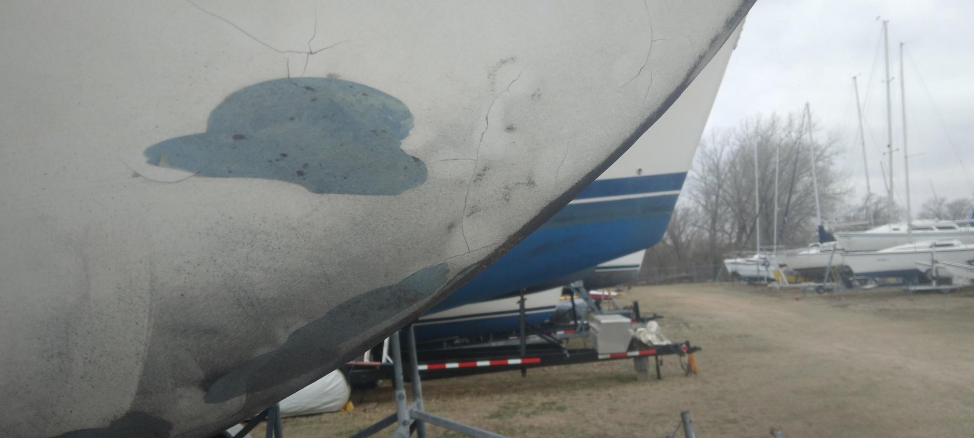

Here are some pics of my hull. The "biggest" cracks are at the bow. I pointed to give some scale. Where the white spots in the black paint are seen in the pic are more tiny cracks, almost exclusively on the port side. All are up closer to the waterline. Below is fine. No blisters anywhere.
