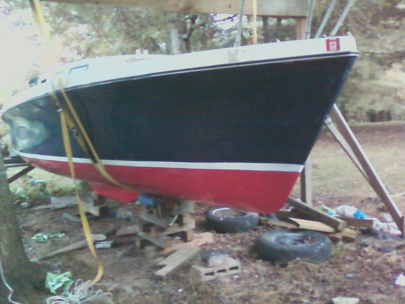

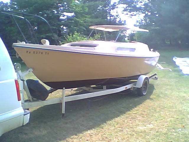

So one of the PO's bottom painted.....
When i got the boat I knew nothing about sailboats so the fact that the bottom was sanded down and ready for a fresh coat seemed like less work for me:D
plus I would have a fresh start and have a better understanding of when it needed to be re applied.
I only sail in lakes and I never leave the boat in water so what kind of bottom paint do I use?
Will Ablative just wear off to easy loading and unloading?
Hard will hold up longer but how long? (I'm thinking this is for me because I don't plan on owning this boat for ever) HOWEVER the thought of telling the next owner it has hard paint on it seem like a heavy bomb to drop on a guy seeing as how hard it will be to remove the hard once the anti-fouling is used up.
Then there's the Hybrids.
Its all to much.... plus I'm broke.... and also the boat has a big leak that I cant find..... OH and I have no idea what type of paint was used before so who knows if what I pick will stick to whats left of the old right?
I am no expert but the hull seems to fare gone to worry to much about it. there a lot of chips in the gel-coat... i keep finding more and more spots that have been repair in the past. Spots that at least don't look very good, structurally they seem strong...
Its all getting to be over whelming..... Where do I start.... Where do I draw the line... I don't mind learning as I go but I don't have the money to just go trial and error.
The Leak is another thing! the water is collecting in the bow bilge. I cant find any wholes. Two spots of concern that I see.
1. the rub rail near the bow has a huge gap on the bottom side but Im not seeing water on the inside hull or on the bunk in the bow. I guess it could be running down and going into the bilge before I can get a good look at it....
2. the bottom paint has been sanded down and at least in one spot near the lower bow its so thin that light can be seen coming in to the bilge. Could water be seeping in through the fiberglass? Its about a gallon per hour I think. I DON'T KNOW!!!!
I stripped the whole interior out and removed the bow foam flotation in preparation for the next outing. In hopes that I can send my son down below to look for the leak while we are sailing....
ANY BODY WANT TO BUY A VENTURE 22 in MINT condition????:Liar: okay like new....:Liar:eek:kay almost like new :Liar:OKAY OKAY for parts????

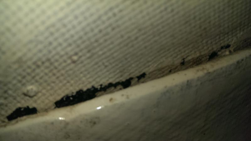

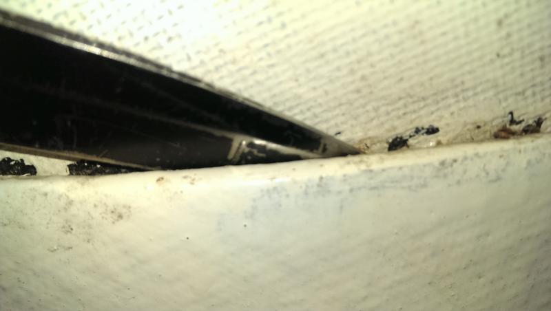

Yeah so i have the "shoe box" type and yes, ner the bow I can see a big gap in a spot between upper and lower deck. Out of curiosity... is that the only thing holding the 2 sections together? I would have thought that the two parts would have been permanently joined.
going out now to see about closing that gap.

so YEP, my hull deck joint is screwed!
I already want to sand the whole boat down inside and out and repaint so why not just go head and separate the dang thing and go to town?
from what i have seen so far you have to remove the rub rail and clean out all the old sealant any way to fix the hull/deck joint. this is turnning into a big dang job.

Can you post a picture? There is a LOT of experience on this forum and I'm sure someone here can give you the do's and don'ts ... that will save you time and money.
13,056
I'm not sure what the middle picture is showing but from what I can see, you just need to run a bead of caulk up under the edge of your rub rail and along the inside as well. And I really don't think a gallon per hour would come through the rub rail. You might be getting rain water in your boat from that area but more likely from the chain plates. First off you would have to have the rail buried for an hour at a time... and that is some digressive sailing. I'm only guessing but based upon your expressed lack of experience, I don't think you sail hours at a time with the gunwale in the water.

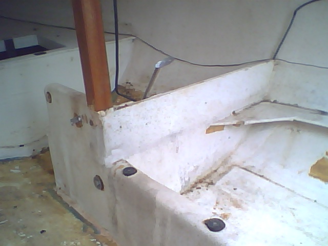

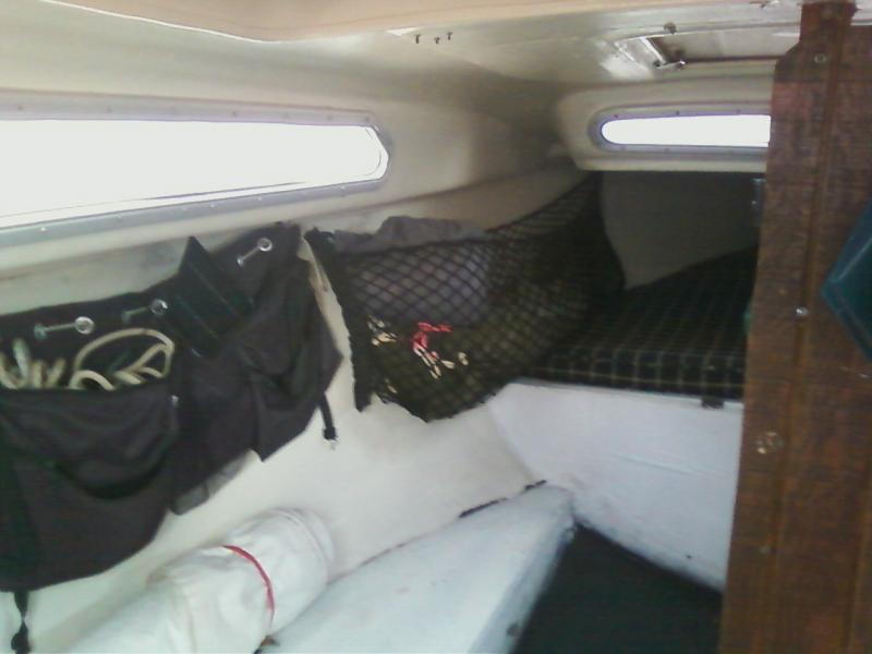

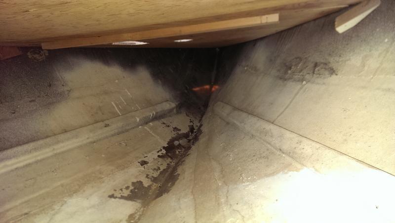

The middle pic(in the last post) is my pocket knife in the gap for scale. Also worth mentioning is that when trying to take pictures of the before mentioned gap that I noticed the whole bow nose area Deck/hull joint allows light to come through as well! lots of gaps up there.
I have not been back in the water since you asked that question. To be honest the Boat docks around here are so crazy and hectic that I forget to send the boy down to look for the leak and by the time I remember there's already a lot of water in there.
BTW I'm in the south and the bass fisherman will punch you in the face if your clogging up the dock waiting for a leak!:naughty::D no seriously they will.
We plan on trying a new spot with a little less traffic so I will report back on this after the weekend. Maybe as soon as Friday.

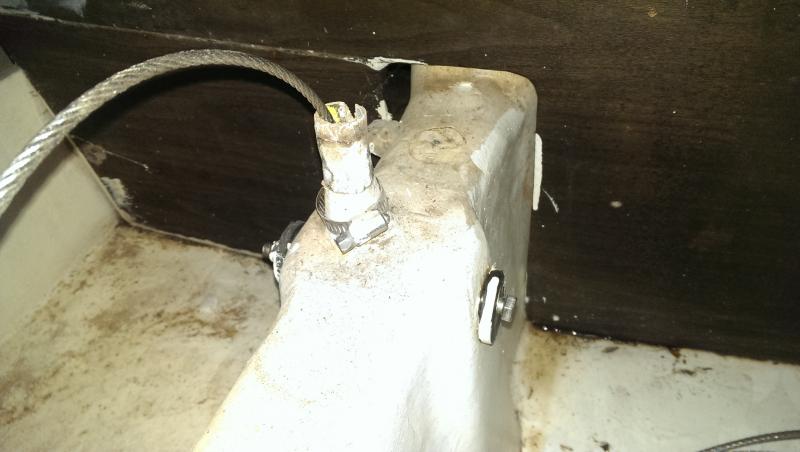

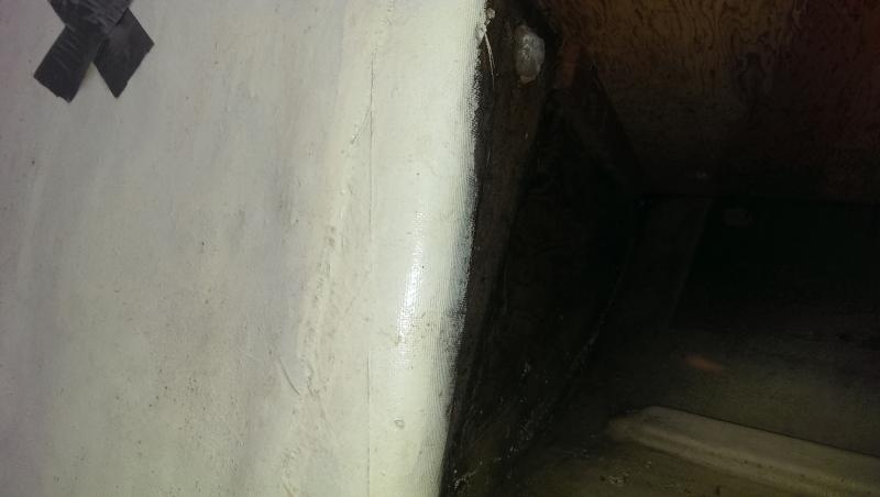

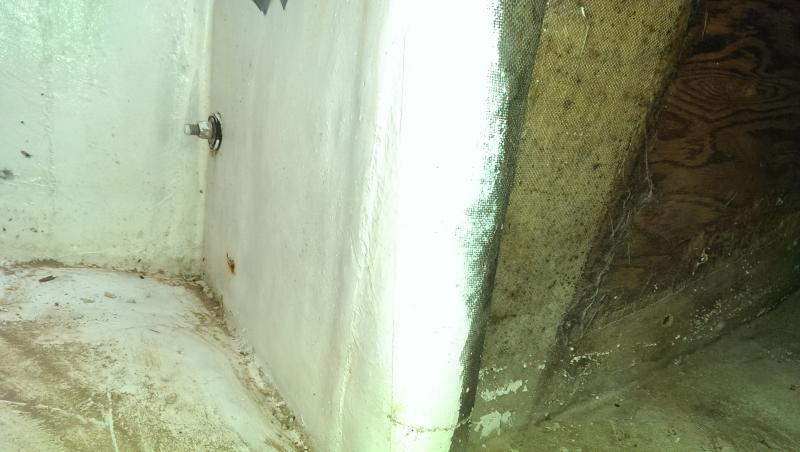

also I meant to ask this before, but I keep forgetting.
So I know what the pivot bolt is. and I assume the lock down bolt is just forward of that? I do not have a lock down bolt!! and it appears that it may have ran aground and caused the hole to be ripped a bit. The PO had a toggle switched jammed in the port side of the hole and the wires for the running lights ran out the starboard side. I'll post some pics tonight of the whole thing. I suspected that open hole at first, but put some duck tape over it the last time out and did not see any water coming in that way. A visual inspection of the pivot bolt did not appear to be wet. I only had the chance to look at it while becalm so I would not be able to say that underway it was not coming from there. So the question is how tight should the pivot bolt be? it seems to be visibly slack? It does not look loose just not very tight if that makes sense. there are rubber washers on both sides. I didn't want to try and tighten that up until I knew if it should be a little loose or not. Actually I have a couple of pics that indirectly show some the areas just in case it helps.
so the first should be the pivot bolt and just above you can see the tape from what I assume is the lock down bolt hole.
the second should be the lock down bolt hole with the tape over it. (starboard side btw for both 1st and 2nd pic.
3 should be the bow just because I had the pic.
and last should be the bolt near the keel winch. What is that bolt for? ( I'm not seeing water in the area BTW)

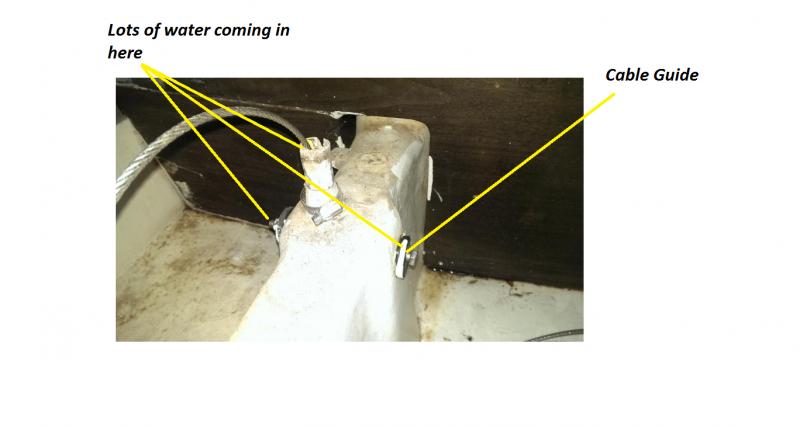

13,056
Those pics help a lot.
The light coming from your bow is not a problem. Once you paint the hull bottom, you won't see that anymore.

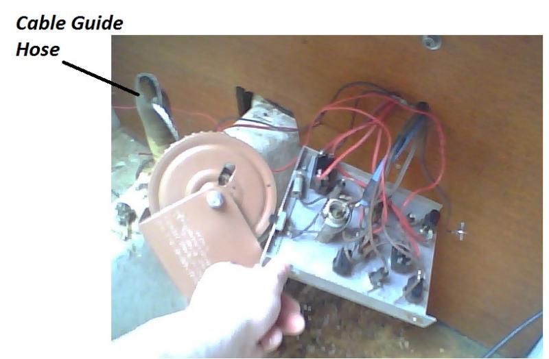

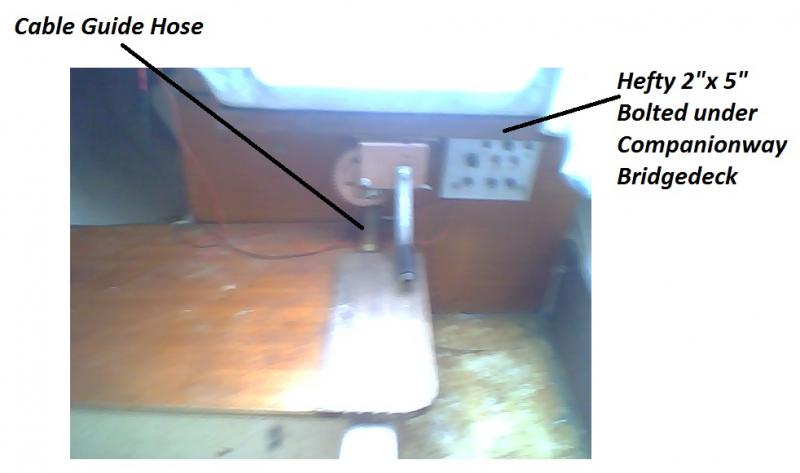

Your problem is most certainly at the winch. The bolt that you see near the keel winch is a guide that keeps the keel cable from sawing through your fiberglass trunk when you raise and lower the keel. Your rubber washers are lose and that bolt sits right at the water line. So you have a slow leak there for sure. And the hose that you see around the cable is important too. When underway, water slaps the back of the keel trunk and then "spits" up through that hose. Your hose is too short:eek:.

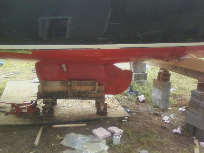

In the second pic I've attached, you see what my keel cable hose looked like (before restoration) and even with the extra length... I still got water spitting out the top when I was at hull speed. So I would jam a piece of sponge in the top. Jam a wad of plumbers putty over the pivot bolt and get a lock down bolt. You can make your own rubber gaskets using goop (lowes) and a big washer and some masking tape.. I maxed out the number of pics on this response so I'll put pics of that in the next post.
Don't be discouraged. The Mac 22 is easy and inexpensive to work on. I wish I had kept mine. I've attached some before and after pics of my boat so you can see that it can be a great little pocket cruiser... The older gentleman standing on in the cockpit is the PO. I also attached a PDF of a great adventure I had in my little Mac22. You can see more pictures of a restored Mac22 in that PDF

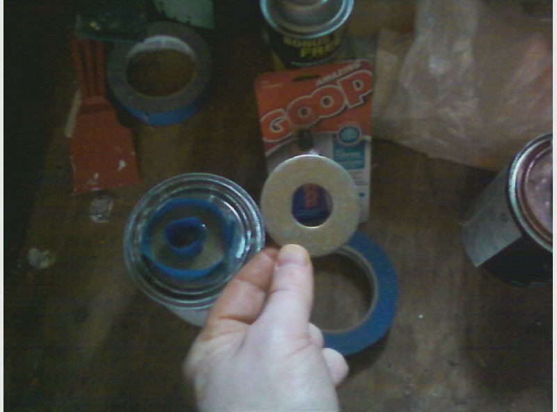

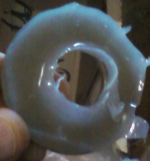

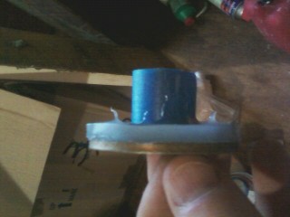

Here are some pics showing you how to make rubber gaskets for your keel/trunk bolts.
Use the masking tape to make a dam around the washer (inner ring and outer ring). Fill the dam with liquid goop (Lowes or Walmart) and let it set overnight. Remove the tape and viola. You now have a washer with a rubber gasket for about $2. The one in this pic was made for a Balboa 26 that has a 1200lb keel so that is why the washer is so large... but you don't need anything that big.
