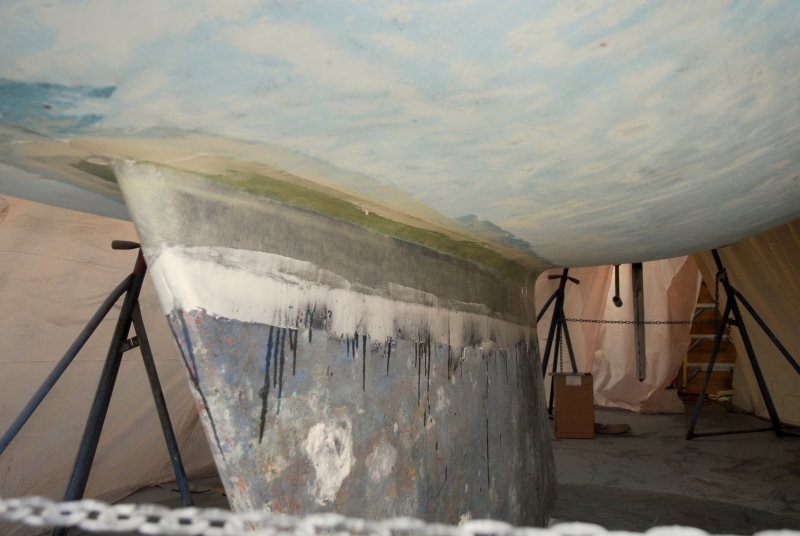

Scraping:

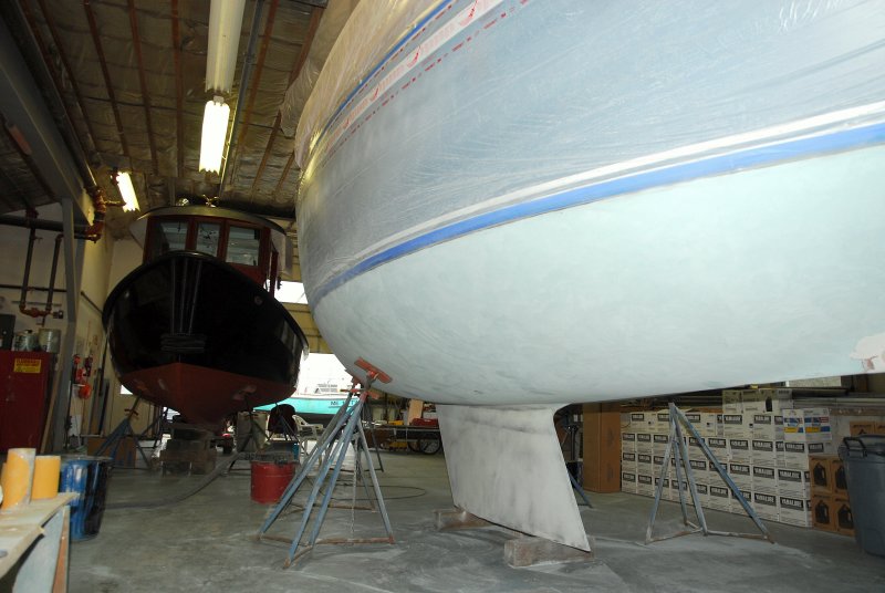

Keel Joint:
Fairing:

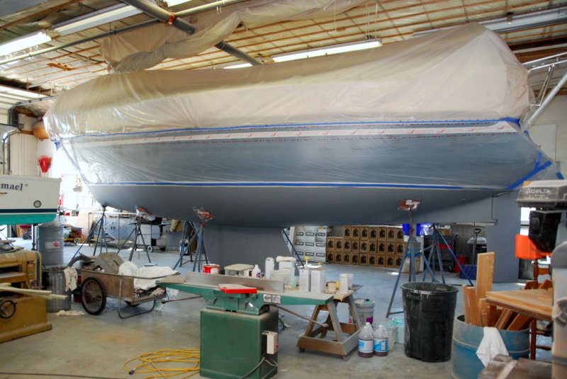

Barrier Coat:

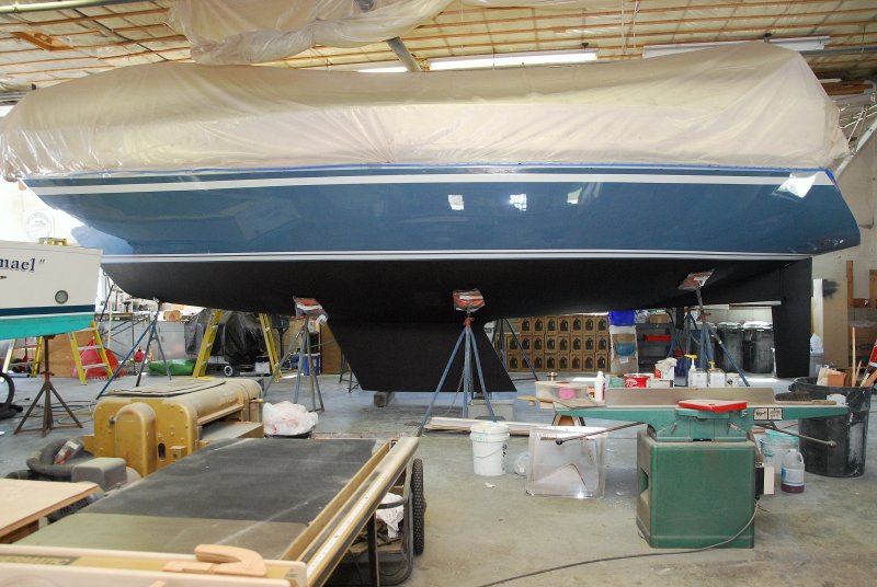

Done!!

Scraping:
Keel Joint:
Fairing:
Barrier Coat:
Done!!
