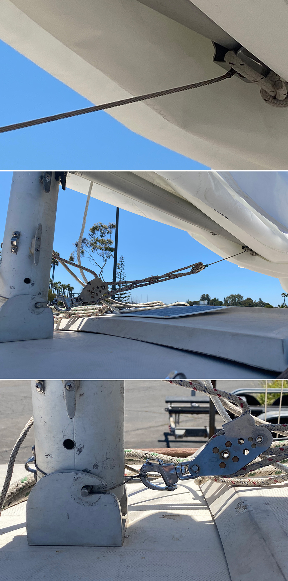

I snapped a picture of my vang before going out with my kids today. As luck would have it, the cable that held the base of it to the mast broke while we were out. So it's something I'm going to re-do, this time a little more robustly. The top has a ball that slides into a key-type slot. The middle is a block and tackle.
I'm not sure what the correct way is to connect it to the mast.

Oh no I’m very sorry to hear the cable snapped on you! Thank you so much for the photos, that is exactly what I was looking for. Would you be so kind as to tell me the distance from the mast to the attachment point on the boom please?
