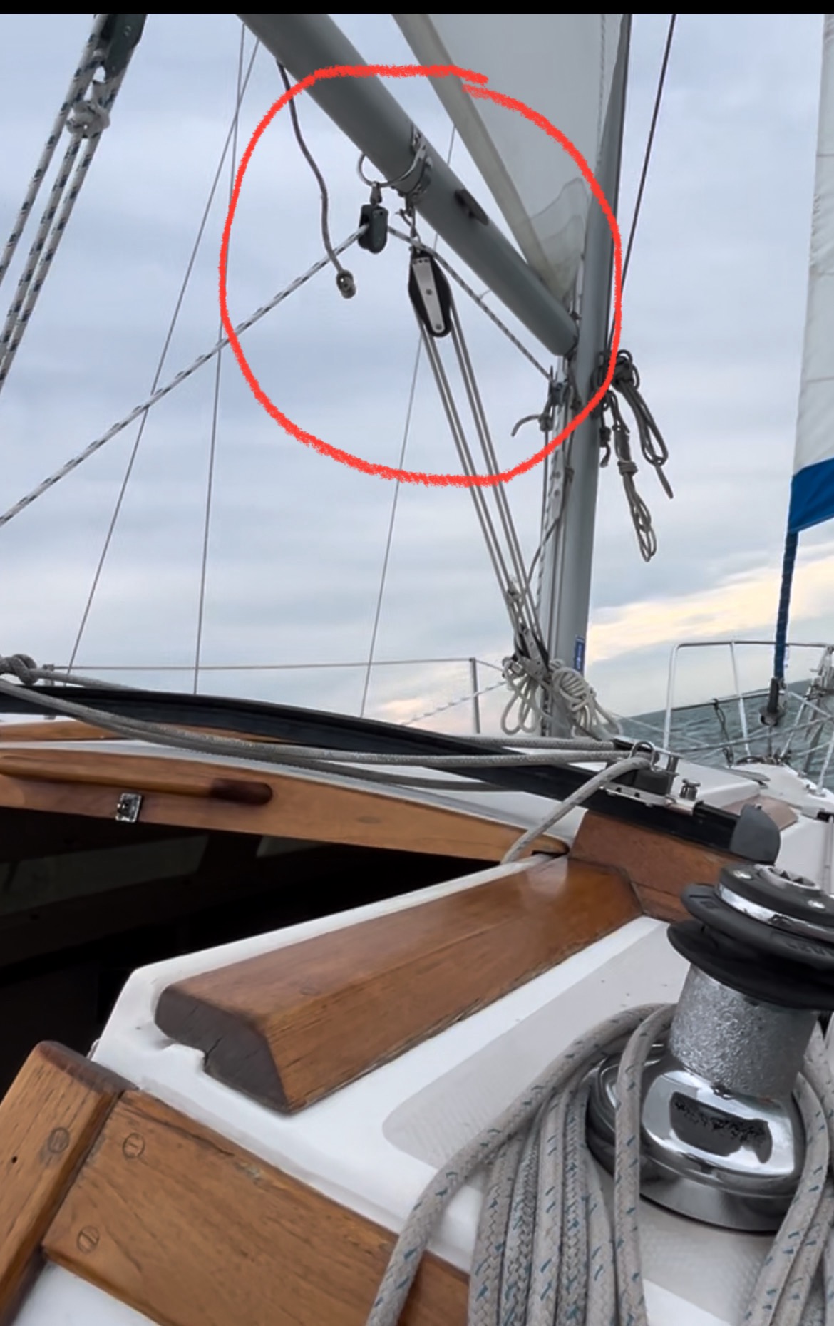

Any ideas how to fix this? See photo. It’s not a big deal but over time all the rubbing will ruin the main sheet. Or maybe it’s fine as is?

What’s the sheet turning at where it meets the mast? It looks like it’s just using a cleat as a turning block, then maybe going through a proper turning block at the base of the mast? If so I’d run it straight to the block at the base of the mast. Then it will run parallel to the vang instead of crossing it at the top.
10,233
David sailor is right.. it'd be a good test to run to the lower turning block (behind the vang cleat/block) from the boom block, bypassing the upper turning block behind the fixed cleat. The existing run will chafe through the mainsheet ..
Another option is to replace the lower mainsheet block with one that has a cam cleat (or maybe add a cam cleat to existing ?) and then the adjustment line runs straight aft .. that eliminates a bunch of friction in the system.. My boat has been rigged that way for the past 30+ years..not as convenient to singlehand, but much better otherwise.

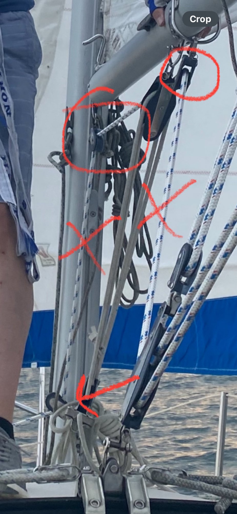

It’s seems like many are suggesting I eliminate the line up to the boom and over to the mast then down the mast. Just go straight to the block on the bottom of the mast. See photo. Comments ?

I’d definitely stop using the block at the gooseneck, the one I’ve labeled 2 here -
I’d start by trying to run straight from 1 to 3. If you skip 1 entirely you’ll have a little less mechanical advantage when you pull the sheet. If 1 to 3 still chafes somewhere then you could try going straight from the traveler to 3. You could also try to rearrange things to sheet from the traveler directly as others suggested but that would likely take more hardware replacement and creativity.

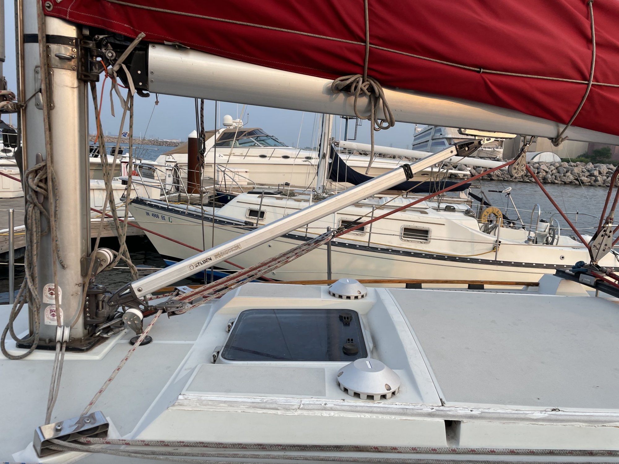

I replaced my rope vang with a rigid vang, but it occupied the same place as shown in this photo…
As others have said, the mainsheet should run down to a block at the base of the mast (notice the angle on mine), not to the cleat up high On the mast.
