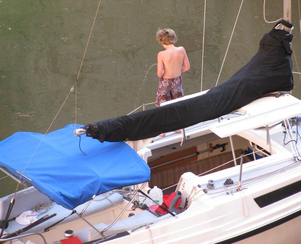

Can you use a boom kicker to hold up a boom tent?
Nope.. for me, the main purpose of the boom kicker is to hold the boom up when I'm reefing the main. The boom kicker will bend if the boom is pulled down by something like a tent under tension.
Im not sure what other do but I have a pig tail off the backstay which I can clip the boom end to when the sail is in the bag. In this case, the backstay is used as a topping lift with the same strength. The diference is that when the back stay is clipped to the boom, it will not let the boom rotate - it is fixed to center - so you can not use the pig tail for reefing. But its nice that it keeps the boom to center when the main is not in use.
Ive sailed the 26S a lot with the pop top up (I always use the 1/2 up because I can keep the boom kicker and vang in place all the time).
If you look at the 26C, the pop top being up increases the companion way opening width by maybe 4 inches on either side. I know the manual says to not sail this way.. but my experience has been that its not a problem. Don't know about any other Mac boats however. Last fall, a Catalina 22 swing keel got swamped somewhere - they got knocked down with the pop top up. Don't know the details but the keel may have retracted shifting the boats righting moment and with the pop top open, water came in. Certainly something to have a lot of respect for..

When you are reefing the main, you don't want any wind pressure on it - ie, it needs to be able to swing freely. Especially true in my case where I'm reefing at the mast (ie, I'm just in front of the mast). Having the pig tail off the back stay hooked up is similar to keeping the sail sheeted to center. If you could keep the boat pointed straight into the wind, I guess the pig tail off the back stay would work. But as soon as the boat fell off the wind a little, trouble..
Edit to add picture
