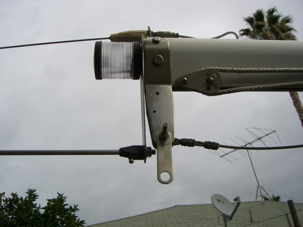

I installed this tang on the 'chicken neck' so that I can attach a pulley and continous line to use as a topping lift, flag halyard, and in the future a camera hoist.
I tie it off to a push pit rail.
A topping lift is released for sailing.
