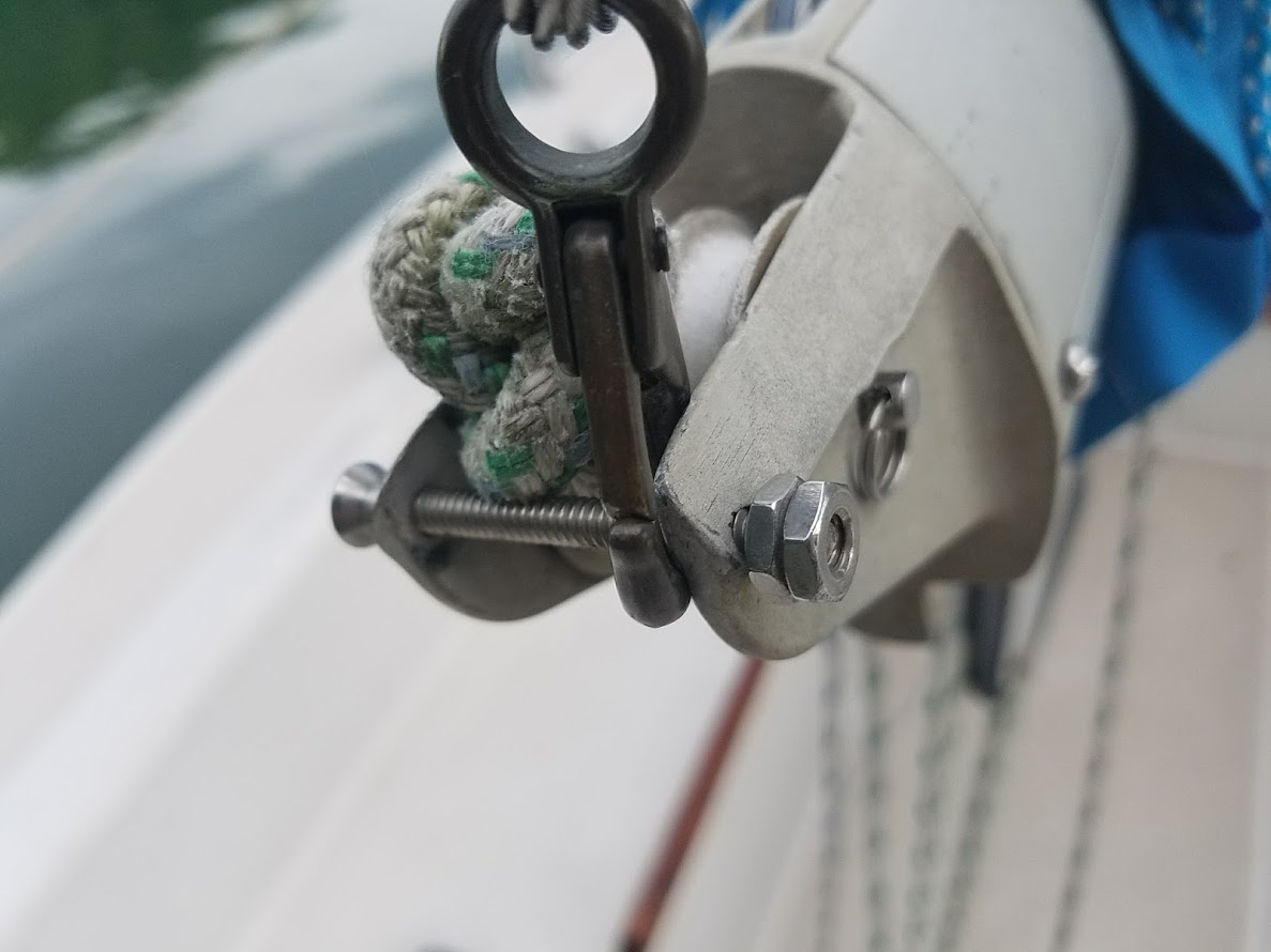

I may have been in your situation though the term "U shape" suggests otherwise. Several years ago, the nylon-looking bar that ran thru the boom's end fitting to which I'd attached the brass hook on the end of the braided wire spliced into the back stay broke. I elected to replace this with a stainless bolt/nut assembly. I inserted a nylon-like tube between the two holes at the end fitting so that my bolt was encased in nylon; after using the nut, I hacksawed off any protruding bolt; lastly I covered the nut with a plastic cap, so that any head to nut encounter would be softened.
This alternate material replacement of the original nylon-like bar has worked for me.

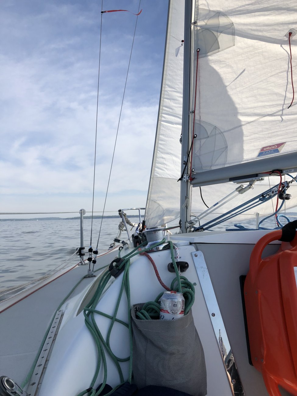

Boom Kicker has been the best $200 I've spent on my capri 22 MKII. It consists of two fiberglass rods which mount under the boom/on lower section of the mast and serves as leaf springs. Now (well, since I got the Boom Kicker, 10 years ago) when I let loose the halyard and the main comes sliding down, the boom remains horizontal rather than dropping on the deck.
Wooster who lowered the mast today
I second that....

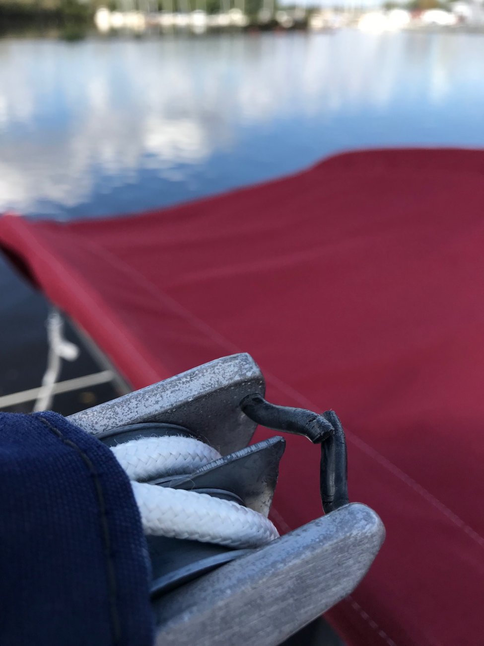

Here is the image @juradog wanted to post.
My eyes suggest the broken piece at the end of the boom looks to be plastic not metal.
Assuming the purpose is as described
A clip, which is rigged to the backstay, attaches to the U shape attachment.
This serves like a boom loop. It has given up the ghost due to age.
It might be replaced by a
Boom Bail
or a Clevis pin straight across the end of the boom if the bail is too big.
Even two holes and a length of dyneema might work.

It is not the most elegant solution but a stainless screw does the job. A Clevis pin would be better.
