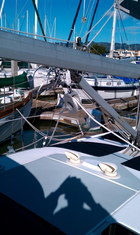

537
Hunter 386LE San Fancisco
Install a preventer such as mitiempo proposes as I did on my short boom Hunter 31 lead aft through a cam cleat or install a Walder, Scott Boomlock, Wichard or other boom brake. I use a French Walder boom brake and it works for me. It operates as a preventer or boom break depending on how much tension is on it. Attached is photo of the Walder boom brake.
