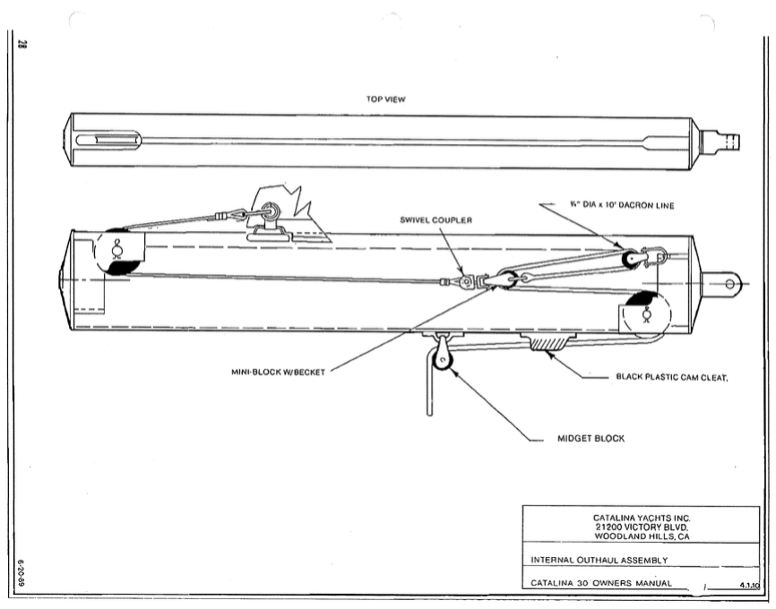

According to my C30 manual the internal outhaul has a wire lead from the clew to a sheave leading it into the boom to a block. From the block double braid line is run to give a 3-1 purchase. Pic below.

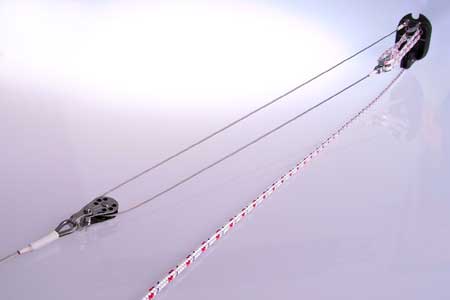

Catalina Direct offers a 10-1 purchase setup that adds another wire lead after the first one, then more blocks wove with double braid line. Pic below.
My question is this: Does the wire line have advantages in this type of setup or can I plan to use all double braid line?

Wire was used in stretch-critical running rigging before the advent of spectra-cored line. Now you could use very low stretch line (spectra core), or just dyneema. Thats what the builders started to do in the 90s.

I bought the 10:1 from CD for my 36. And ran it back to the companion way. Wire doesn’t stretch. The double braid has lower tension so overall stretch is less.
The existing blocks where totally worn and I would have replaced them anyway. I went with the CD package cause it should have All just fit. It didn’t I ended shortening the wire about 12”, which is the difference between the boom length on std rig vs tall rig.

I agree that replacing the wire with single braid dyneema would work well. An equivalent strength double braid polyester would be too damn big... Nothing wrong with wire though.. you can build that piece over at the WM work bench, right in the store.

If you switch to line, then the blocks will probably need to be larger.
While a hi-tech line like dyneema would have very little stretch, a good quality dacron line would also work. It will stretch more, however, the lines are relatively short and while under tension it will not be as much tension as a jib halyard and much of the tension will be spread over several short line segments.
5/16ths Sta-Set has a tensile strength of 3,000 lbs. At 10% of tensile strength (~300 lbs of tension) the stretch is about 1.5%. If you can get 3k lbs of tension without a winch, you would have about 1.5" of stretch for every 8 feet of line. NE Ropes Technical Data - Sta-Set
I doubt any mere mortal can develop 300# of tension on an outhaul without the help of a winch. And if you are not racing a little stretch really won't matter much.
