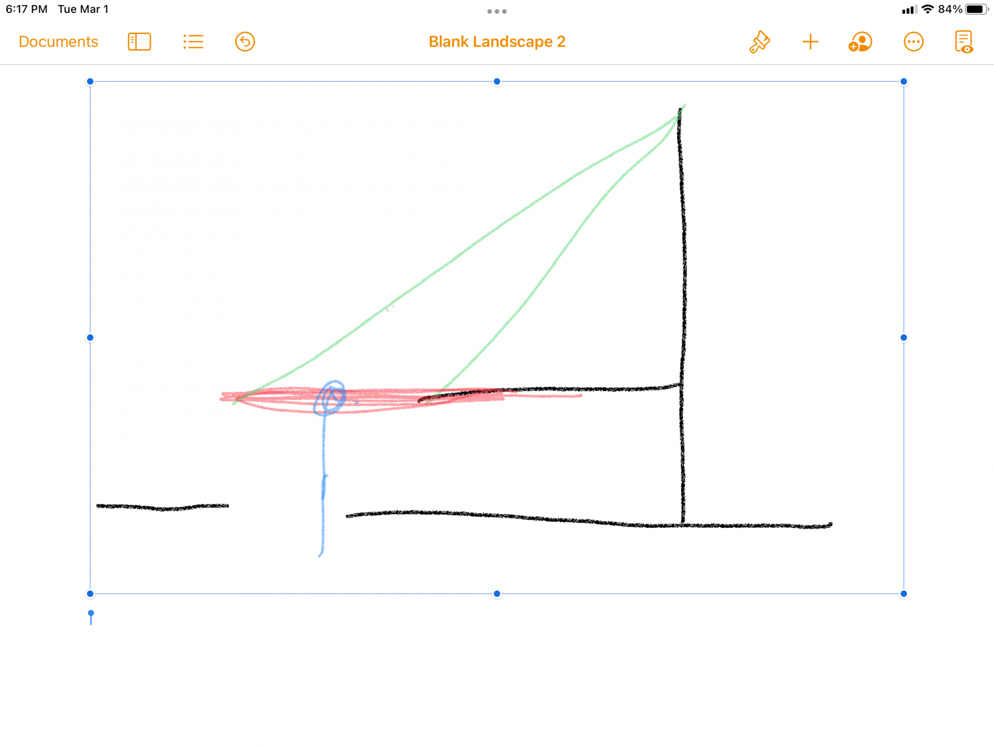

I was going to suggest this…whatever you use to extend, have a topping lift support the aft end of the boom as well as the extension, and another halyard supporting the rear end of the extension…
The boom would essentially just keep the extension held out away from the mast, and the 2 lines are supporting the extension on each end…crude drawing below…
Greg
Exactly what I was considering.... the extension would just have a couple of eyes or holes that would make it possible to attach to the boom so it won't slide..

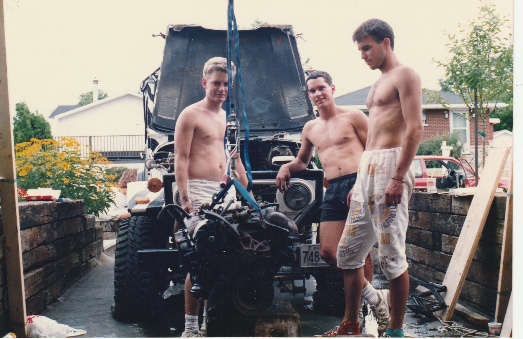

I can tell you a 2x6 supported on each end by two 2x4s can support a 500lb small block in the middle of about an 8' span. When I was young I did everything with whatever I had on hand and mostly got away with it. I'm not sure I'd lift a 200lb generator over my boat with an extension off my boom if I didn't have to. If I was somewhere remote without a crane I would certainly find a way but with a crane available I'd go with the crane. Lifting an engine with a boom is just a matter of proper engineering, not everyone gets it right.
This is the Chevy small block from my '77 Toyota Land Cruiser getting a clutch replacement.

I bought it with the 327 small block in it already. It was an interesting drive, not lack of power, maybe a bit too much at times :yikes:. I did get into a few interesting situations like running over a beaver damn in the middle of the night. Trying to jump a stream one time I got stuck up to the floor boards in mud. I was spinning the wheels trying to get out when I heard this squeak behind me. John's (the guy on the left in the picture) girlfriend was in the back seat and she was covered in mud that came through the open window. The winch came in handy that day.
I had to lift the engine over the bush bar any way and there was enough room to work on it without taking out the grill. I had a BJ60 long wheel base after the FJ40 and now I have an FJ Cruiser.
