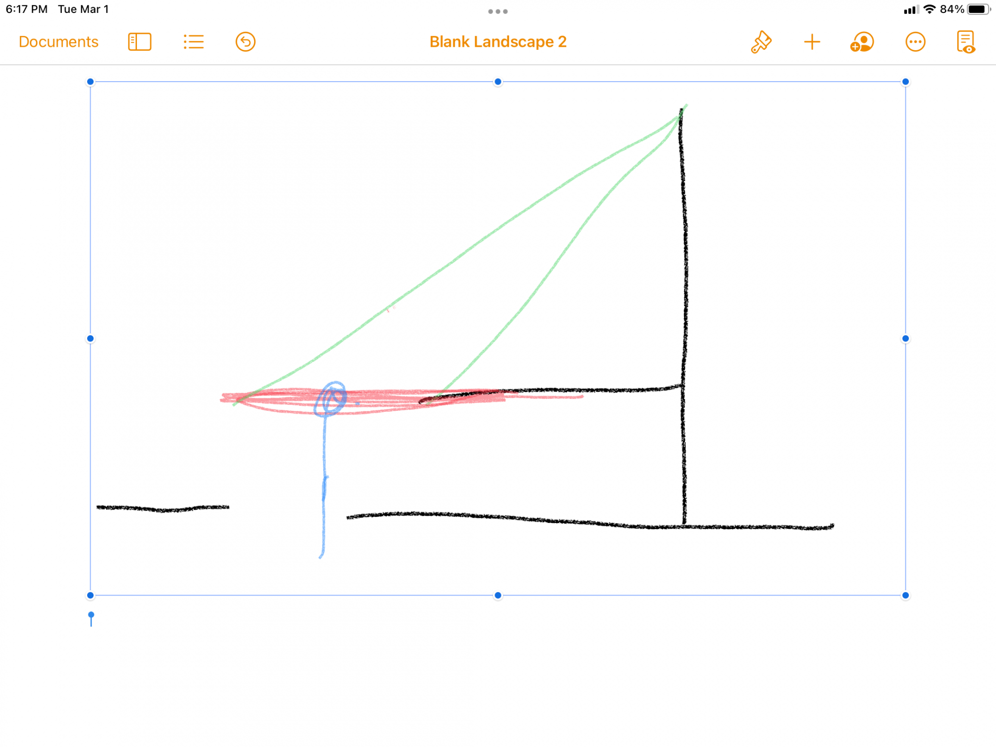

If you do it right then, yes. Realize that the attachment to the boom must be very strong as I assume the boom will not be supported by an additional topping lift. If I were going to do it I would use my spinnaker pole as the extender so I could lash it to the boom at the end of the boom and also at the forward end of the spin pole. Then I would have to decide how to support the boom. It may be better to support the boom with the topping lift at the end of the boom rather than at the end of the extension and just let the extension cantilever out. The other option would be to support it at the end of the extension AND at the end of the boom using a halyard. You would still need a very string connection between the extension and the boom.
My spin pole is 3.5" dia. aluminum pole so it can probably carry the 200 lbs at 3ft out but I would run the numbers on that first. The next issue is how much is the boat gonna heel when you try to lift it off of the dock? You may need to get some rail meat to stand on the other side.
I was going to suggest this…whatever you use to extend, have a topping lift support the aft end of the boom as well as the extension, and another halyard supporting the rear end of the extension…
The boom would essentially just keep the extension held out away from the mast, and the 2 lines are supporting the extension on each end…crude drawing below…
Greg
I thought about that too. It will make the bending force on the extension much less. But it will also put the extension into compression against the boom. It will be very hard to lash the extension in such a way that it doesn’t slide forward along the boom in that arrangement.
Yes.agreed. Have to be creative to find a way to keep the extension from moving into the mast.
