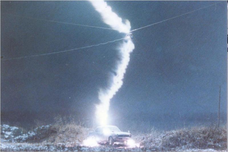

There is another picture in that link which is both interesting and "maybe" slightly humorous.. On page 12, there is a picture of an induced strke to a car "with a live rabbit inside". I didnt see in the paper if the rabbit lived.. but Im pretty sure its bunny brain probablly had to do a reboot shortly after the strike. (photo credit - page 12 of the link above)
